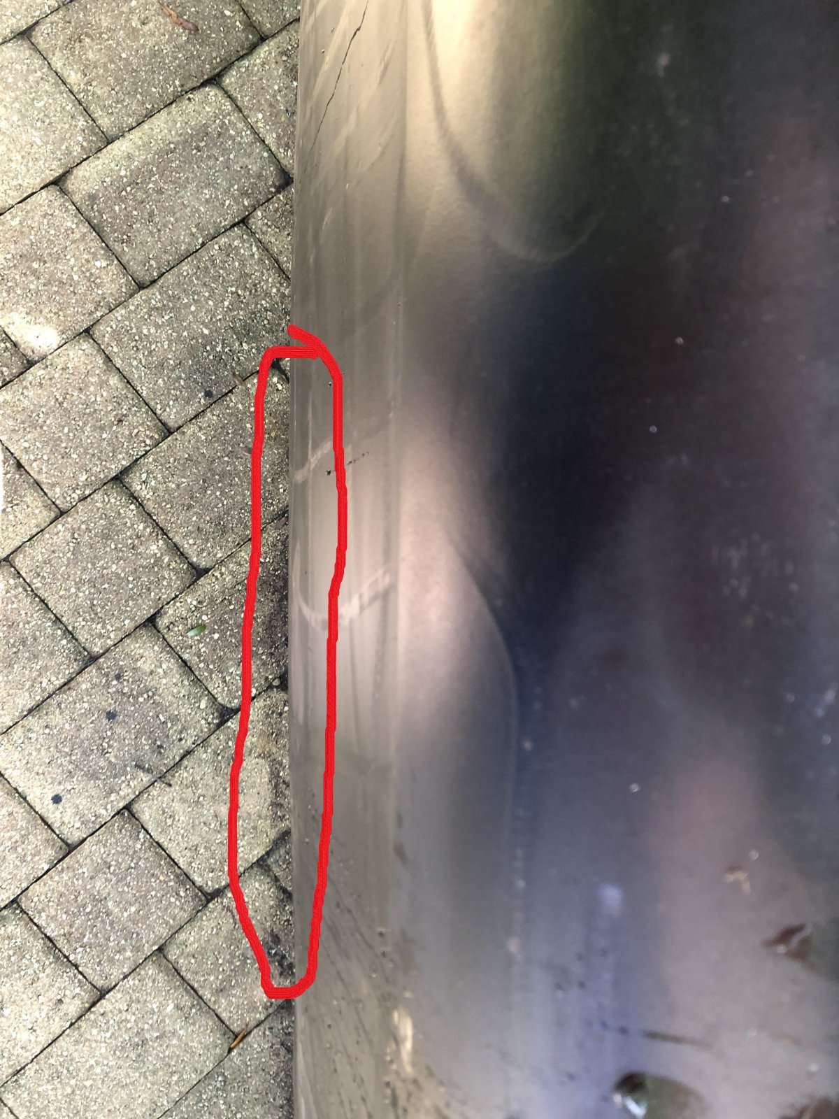

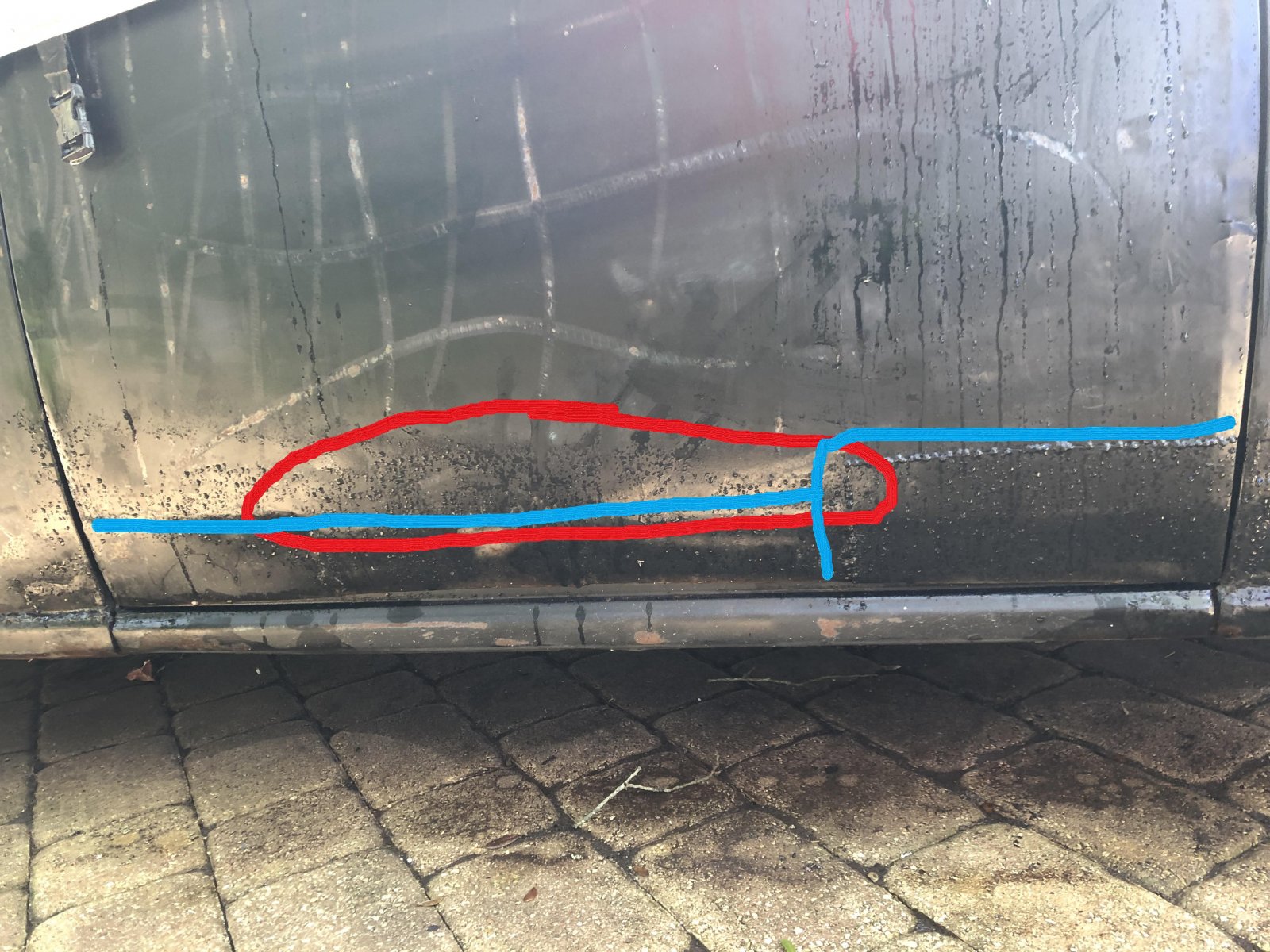

  8. FAKKY
    Joined: Sep 9, 2016
    Posts: 295
    FAKKY
    Really hard to capture in pic .....
    But the blue is the weld area
    The red is the problem area where it pops put a bit .......
    WalkerMD likes this.

  18. indyjps
    Joined: Feb 21, 2007
    Posts: 5,393
    indyjps
    Others have had that problem and there's a tool for it. You can buy one or make one
    anthony myrick and FAKKY like this.
  19. It "puckers" when it shrinks so it pulls or pushes the metal either up or down. It pulled the metal from somewhere. Looking at your pictures it looks like it pulled from the sides as they no longer look to be parallel give the widening door gaps at the bottom. Take a straight edge and check the three edges of the panel I would be willing to bet at least one of them is no longer straight if they originally were.
    FAKKY likes this.
