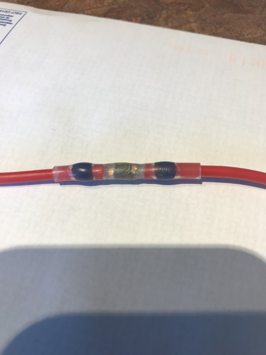

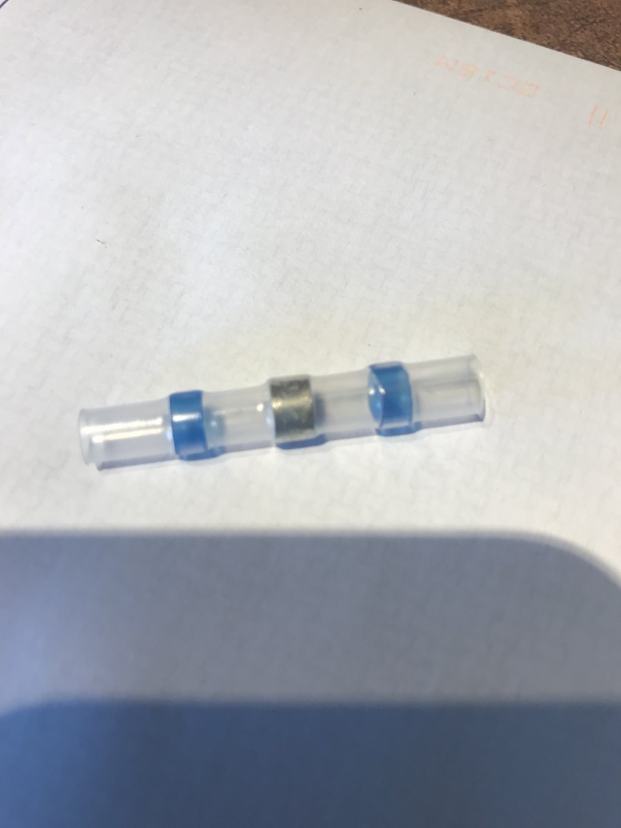

    These might not be new (or news) to you but I hadn’t seen them before this.
    A shrink tube with a low temperature solder sleeve and a couple of rings of sealing adhesive for a waterproof joint.
    I bought some to try one out and they really work :cool:
    So since I’m going to be doing a pile of wiring on my RPU I ordered up a kit with 300 ***orted different sizes :cool:
    From this
    To this, the joint is really well done and I just used my regular heat gun.

  6. Blue One
    Joined: Feb 6, 2010
    Posts: 11,511
    Blue One
    from Alberta
    I’m quite impressed I think you would be too.
    The heat shrink vinyl tubing is thicker than normal heat shrink and is pretty tough.
    The low temperature solder ring actually contains a fluxing agent and I can see that it tinned the wires and joined them nicely.
    I put that joint in my bench vice holding one end of the wire and pulled on it as hard as I could.
    The wire stretched and deformed until the wire and the insulation broke and pulled apart an 1 1/2” away from the joint.
    The joint itself wasn’t touched.
    I’m a believer.
    Old guys are hard to change, I know I am one :D
