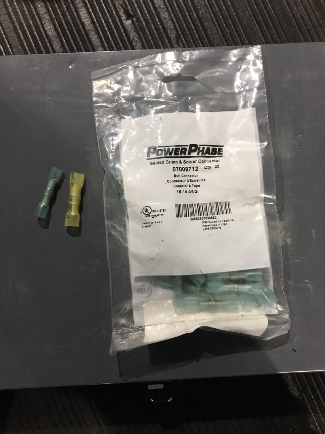

    These work well. 3 sizes pink green and yellow. Crimp solder shrink. Average about a buck each. These came from Fastenal

    I bought a kit from Napa to use in our shop before I retired, came with a high powered heat gun. My problem was this kit used a liquid flux never saw a problem in the joints but that stuff corroded a hole in the case it came in. Always wondered what it would do to wiring in the long term.

  17. Same here but I'd like to try the new self-contained-solder style shown. Maybe when I wire up an electric fuel pump [with relay] I'll give them a shot. Thanks for the hint.

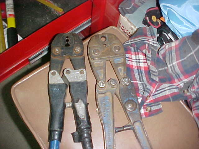

    I've been looking at these crimping pliers with interchangeable jaws. They can be set up so that you can't overcrimp, and having several different jaw sets means you can crimp most any automotive type terminal. Not cheap, but good tools never are!
    https://www.amazon.com/dp/B0045CUML...&pd_rd_r=6a4af146-d7a2-11e8-ab2d-810914121f6a
  21. Alright, I guess I need to do a tutorial. The proper hand tools exist, but you won't find them at an automotive vendor, you'll have to get them from a industrial electrical supplier. There's also some very inexpensive hydraulic crimpers now available, which while they can be clumsy for use on smaller wire, are a must-have if you're crimping any wire larger than #10. I'll take me a little while to work up one that demonstrates the differences...
    Blues4U and olscrounger like this.

  23. I've used this type and I'm not a fan of these crimpers. These generally don't deliver a 100% crimp (which I'll explain in the tutorial) and for most of the 'open' types of crimps they supposedly do require multiple operations to get a full, proper crimp. A 'open' crimp (when done right) also gives built-in strain relief (no shrink tube required), but requires separate crimping for the wire then the strain relief with two different sized dies when using this type crimper. These are very finicky to use, expect some failed crimps. The OEMs that use these crimps have a specialty crimper that does both crimps in one operation, but these crimpers aren't cheap; $300 and up are typical prices and they usually only do a few sizes, so you need more than one if you're dealing with a range of sizes.
    olscrounger likes this.

  25. Yep, AKA 'Burndy' crimpers (at least around here). Being a inside wireman, I didn't use those that often. The last shop I worked for had two Anderson 4-point hydraulic crimpers, a smaller one and a larger one. The larger one would do up to 750MCM wire. Both would be serious overkill for automotive use, besides costing north of $1K each...
    The thing about specialty crimps is most manufacturers would guarantee crimp quality, but ONLY if you used their (expensive) proprietary crimper. Use another brand crimper, and no guarantee. Using the wrong crimper could also void the UL listing on some of them.

    I used Burndy hydraulic12A presses on larger wire sizes but these are plenty good for battery cables. Have pressed wire up to 2.2mil MCM on 500KV with large hydraulic presses as well.

    You need different crimpers for Non and insulated connectors.
    A pair of T&B pliers for non insulated. Look for used.
    https://www.amazon.com/Thomas-Betts-WT111M-Insulated-Terminals/dp/B0018LD2PU
    And a pair of replaceable die Crimpers for insulated. Paladin was bought by Greenlee and the price doubled. You could get handles and 1 set of dies for less than $50. Look at pawn shops for handles cheep. I have 10+ I picked up along the way. Ideal, Xcelite, Amphenol and others make them but dies are expensive.
    https://imgur.com/ZOiq7qr
    T&B 14
    https://imgur.com/b7lg4ej
    https://imgur.com/Fd65yf5
