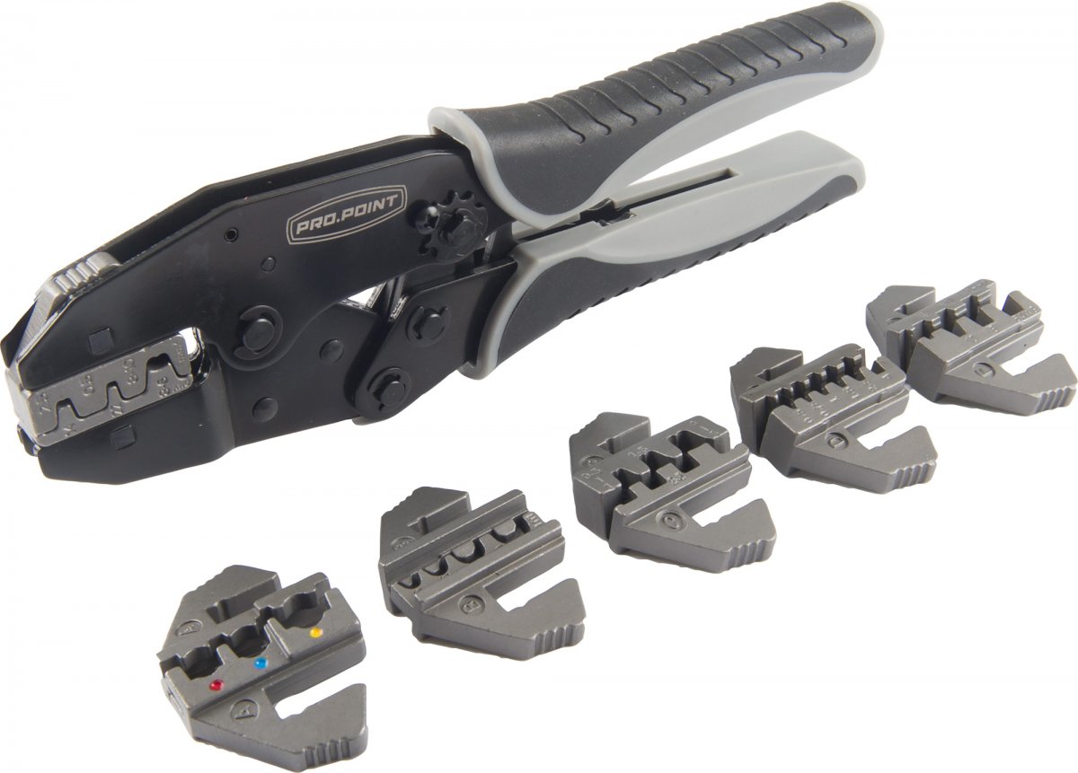

    Sorry, but $73 for a set of crimpers is "not cheap" to me. Maybe if I were an electrical professional they would be, but I'm just a hobby builder, and these seem like they would be more than adequate for the amount of use I would give them.
  6. $73 is about 1/4 the cost of quality, pro-level crimpers like these... so yes, these are 'cheap'. And because they're not as precisely built, you will have crimp failures.... So make sure you have spare crimps.

    Like I said, hobby level. I would rather spring for some extra terminals than have to spend $300 on a set of PRO level crimpers that I'm only going to use a few times. If I was to buy nothing but pro quality tools, I would never have the money left to build my car. But hey, if ya gonna do this for a living, by all means buy the good stuff

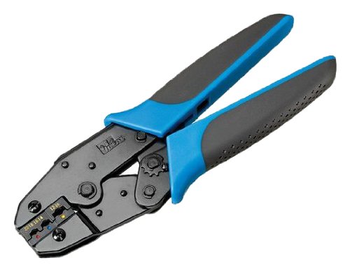

  12. Two things about the above crimper and all like it... One, if you're using insulated crimps you're not getting a 100% crimp. Two, these are designed to meet the minimum spec for UL when properly installed. This spec is IMO not adequate for automotive applications, and is why crimps have gotten a bad reputation.
    If I were doing terminations in a control cabinet, I may use something like these. But not on my car.....

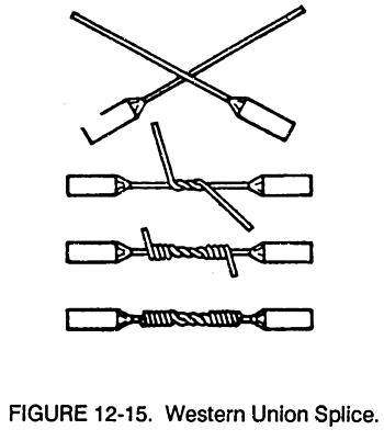

  13. I've seen multiple people bring up the 'western union' splice... Great splice... if you're using solid wire, not stranded. Try this with stranded wire and it'll pull right apart before soldering. On solid wire, this will have almost the same mechanical strength as the uncut wire before soldering. The solder is basically there to 'seal' the joint because the tapes available when this was in common use wouldn't hold up and would allow corrosion to start.
    The solder was the 1900s equivalent of shrink tube...

  15. It was used there, but the original use was splicing telegraph wire... which is why it's called 'western union'.

    As has been said previously, that western union splice means nothing for stranded automotive wire.
    It doesn’t work.
    It was meant for solid wire.
