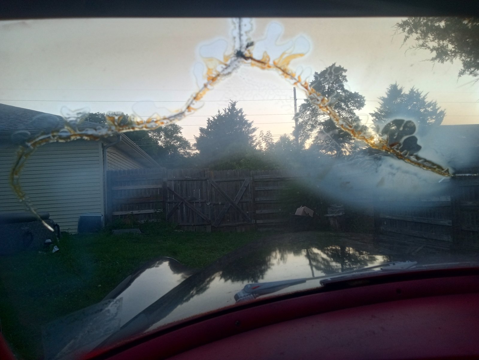

  1. Got to remembered some old dude(old as in im pretty sure if still alive he'd be old enough to call the old guys here whippersnappers lol) told me decades ago how you could clear up the fogginess from delamination using a camp torch. Tinkering in the 53 I realized that if I could do that I could postpone a new windshield much longer. Here laws on windshield state a windscreen minimum 8" in front of driver and no cracks or obstructions in line of sight. Way my windshield is cracked it'd be legal without the fog. Tried a little bit on the left with my zippo. Can see how it's a bit more transparent. Guess I need to buy a torch. Anyone else had any luck with this method? IMG_20240709_203928072_HDR.jpg

    If I was to play. along I would use a heat gun.

    @The Chevy Pope I think your idea of "drivers line of site" may be way off the mark.
    Check out the parts highlighted red in the attached document below.
    The "fog" is moisture in the delaminated glass that has entered via the crack. Applying heat might evaporate the moisture out, but it will soon return. The heat might also cause the glass to thermally fracture if too much is applied.
    I am trying hard not to comment on the excellent glue-up job............
    Time for a new windshield..........:rolleyes:

    That windshield not cracked, it’s busted!!
    My brother and I looked at a car a few years back with slightly crackedo_O windshield like yours.
    They guy had glued cool black plastic spider on the crack.:rolleyes::confused:

    That isn't just "a crack". That is totally fucking destroyed, to the point of being unsafe.
    And it looks like Shit.
    Just noticed, your profile lists your occupation as "mechanic". FUCKING WOW !
    If anyone thinks this is acceptable, imagine them working on brakes and steering.

    Back in probably the late 70s I had a couple of friends that worked for the local
    Coca-Cola bottler. The plant manager got his hands on one of the few promotional Coca-Cola Levis DENIMACHINE custom promotional Ford Econoline vans with the red, white and blue flamed paint jobs. (As designed and featured in a couple issues of Hot Rod magazine!) It had an inside rear view mirror mounted with a glued on bracket bonded to the inside of the windshield. Which was kind of redundant as the rear door windows on the van were covered with fiberglass louver panels which blocked any view out of the rear.
    The owner decided that the I/S mirror needed to be removed to provide better forward vision and also wanted the adhesive bracket removed from the glass. The mirror was easy; the bracket, not so much. One of my friends decided a bit of heat on the outside of the glass might soften the adhesive. So he laid a drop-light on the outside of the windshield over the glued on bracket. The drop-light had the typical reflector and cage over the bulb so it didn't make direct contact with the glass. My friend left the lamp in place while he was doing some other work on the van.
    After maybe 10 or 15 minutes he went back to check on the windshield and in fact the lamp had supplied enough heat to soften the glue on the bracket. But it also provided enough heat to bubble the laminate between the layers of the windshield glass in an area about the size of a 50 cent piece. The plant manager wasn't happy about it but decided that it wasn't so bad that he wanted to pay to have the windshield replaced. In the end he still had better vision out of the windshield than he did with the inside mirror in place. But too much heat in a concentrated area of the windshield may do more damage than good.

    As far as I can see, @Unkl Ian only commented on the state of the windshield........ And correctly so.
    Replacing the windshield would have been a good idea way earlier in the build process. Now you have to back-track stuff you have done to get it changed. It maybe should have been done as you say below....
    It is in desperate need of a new windshield. I work/run my bussiness in the glass industry, and that glass is compromised. Just bite the bullet and get it done.......

    The windshield damage you have makes it unusable, but hey, that's just my opinion.
    Like I said, I work in the glass industry. Have you ever had a glass splinter dug out of your eye?
    I have. Not much fun, and something you should do your best to avoid.....
