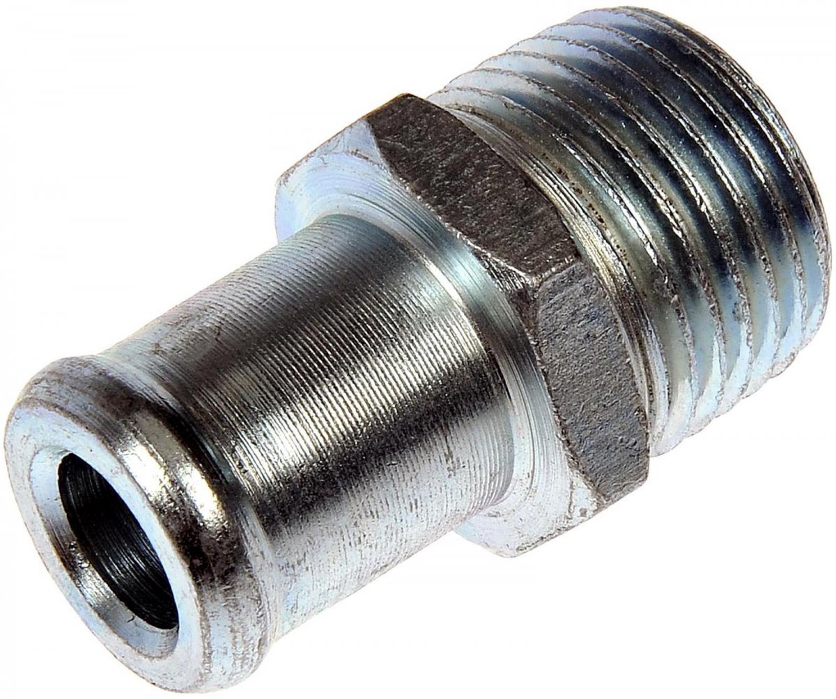

    Unless you need to use stainless steel, lots of options out there. Dorman products, same part number
    at Summit, 500-003-1 Look up heater hose connections for mid-60's Chevys, small block or large. Lots
