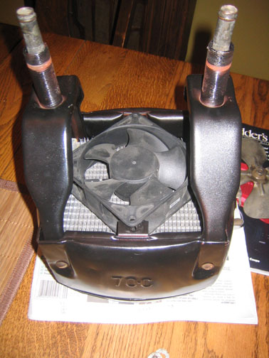

    To replace my JUNK heater, I got an old heater, had the core rebuilt, and put a computer fan in there. It was nice and TOASTY when I drove the '36 to work and it was 19° on Thursday.

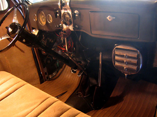

  18. I found this one at a swap meet, I have no real idea what it originally came out of but it works great in my 37 chev pickup. Sorry it's not the best picture of the heater but it gives you an idea of the placement in the cab. I had to fix the core before installing it, but now it will drive you out of the cab if the weather isn't cold enough. even with the windows down I still have to open the cowl vent to mix some cold air with the hot air.

  20. Sorry the pic didn't come through before. Here it is. Jaysins-37-Chevy-021-floorb.jpg
