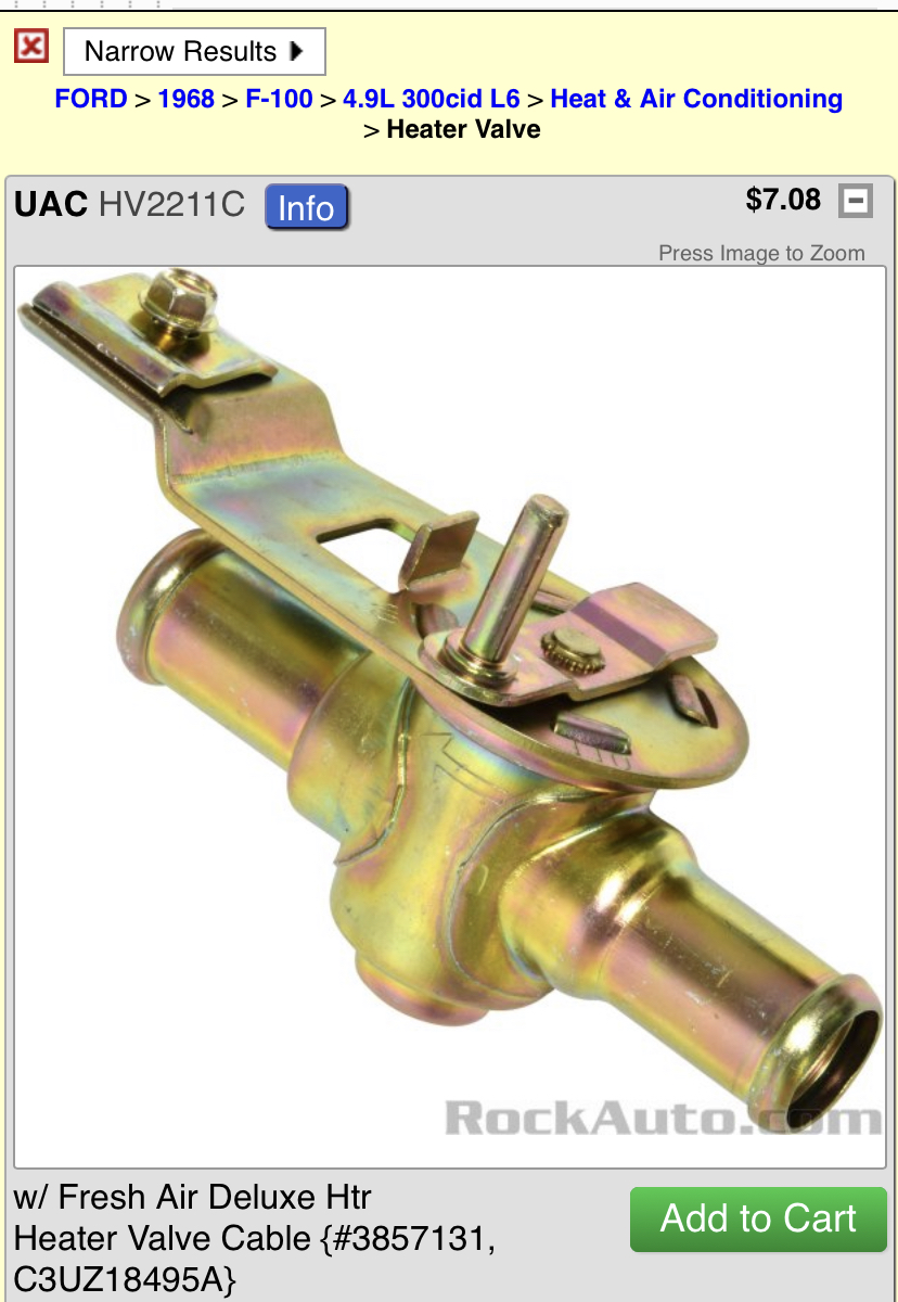

    Get a cable control valve (see pic). They have vacuum control valves too. May have to pick a vehicle to find what you need.

    I understand about the inline hose valve--WHAT makes the unit know it is time to get heat on as of now it only has cold air I got to be able to shut ac off and SWITCH over to HEATER-- got to know what kind of separate switch set-up I need -- looking for what separate set-up is needed to just turn heat on ? ? I have cable heater valve installed all that does it shut it off in summer-- I need a separate switch or set-up to just turn heater on and isolate AC side ---

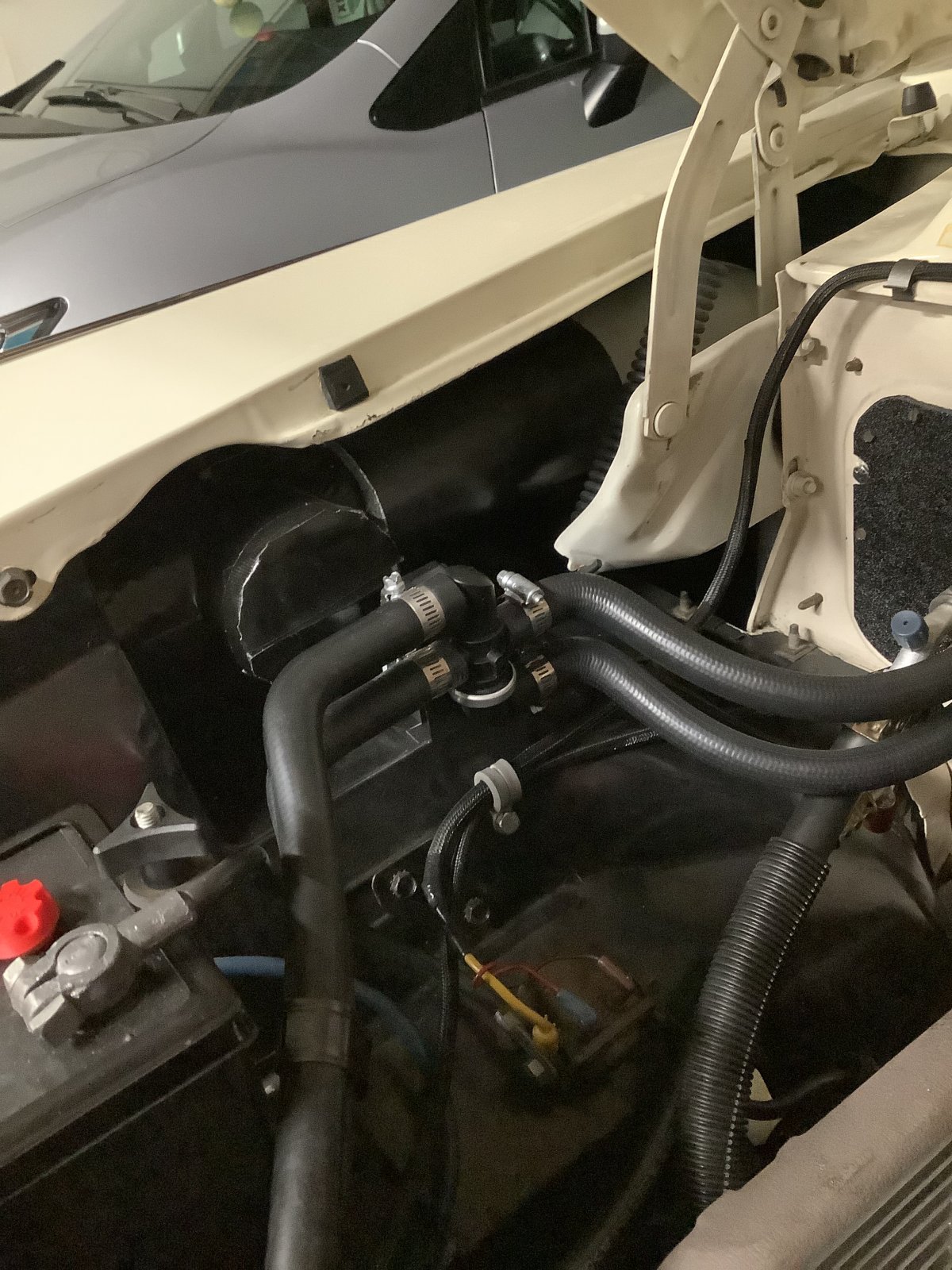

    Look at the print/instructions of your unit. I’ve personally never seen an under dash AC unit which also had a heater exchanger inside, but if yours has both there must be a knob, level, etc on the front to activate the heater which deactivates or locks out the compressor clutch. I’ll bet there is a a wire that’s for an electric valve you install on your engine whether it be screwed in to the water pump or intake or inline in one of the hoses
    Aftermarket complete systems have electronic valves which when in the AC mode continue to circulate the hot water thru hoses but not to the inside evaporator using a byp*** system.. I’ve included a photo of mine for an Old Air Products combo unit. No engine coolant circulates or dead heads at the interior unit unless I select the heater.
    You definitely do not want to blow thru a hot exchanger to then go thru the evaporator trying to cool you. 9EF5625F-5BFD-44F2-82DF-0BFA5B3A4A59.jpeg
