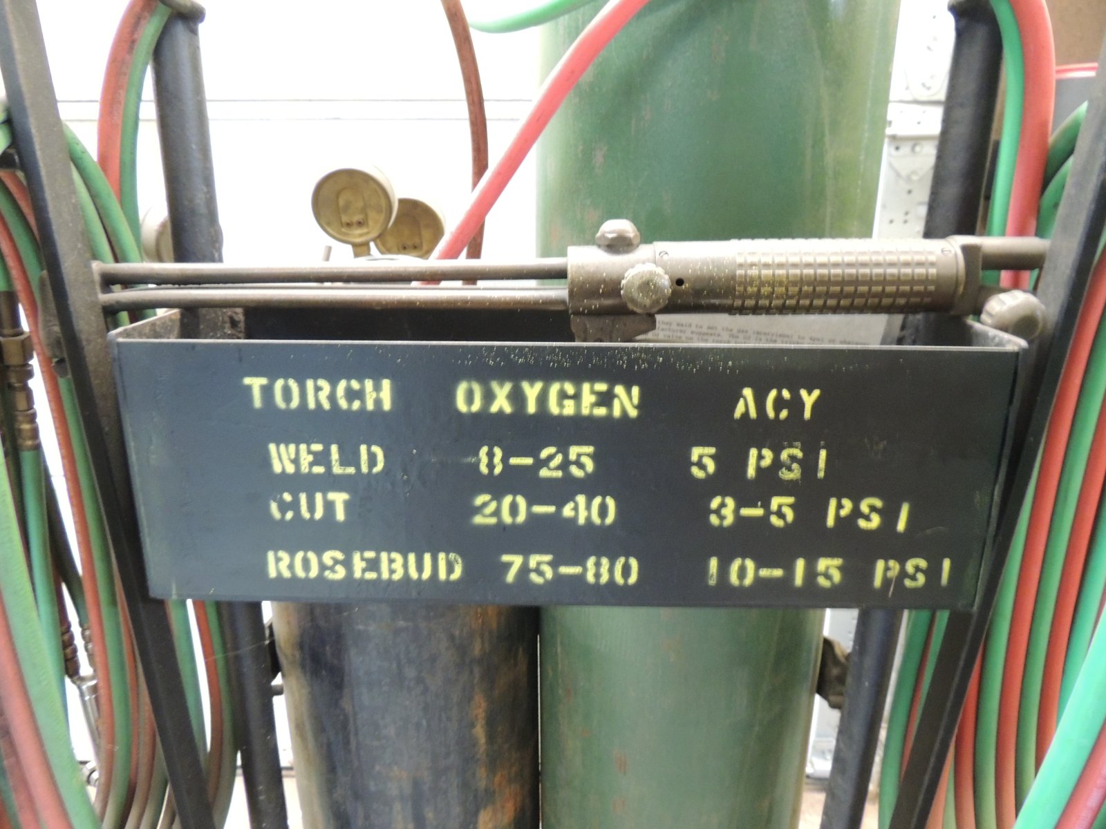

  10. ekimneirbo
    Joined: Apr 29, 2017
    Posts: 5,294
    ekimneirbo
    from Brooks Ky
    I found out that there is a big difference between the settings used for welding, cutting and heating tips. Been a while, so I made a stencil back then so I'd have a handy reference for future use as my memory cells continue to decline. Not saying these are the only settings, but you can see that the information I found several years ago shows at least a starting point for your set-up.
    This is what I work from and it seems to be fine. Your results may vary. :)
