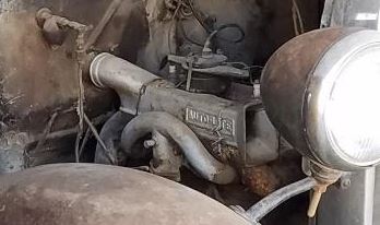

    Manifold heater.
    Provided heat and you could fabricate something similar for your individual needs. Just make sure that you have no exhaust manifold leaks.

  18. You are correct: carbon monoxide was a problem with those. For peace of mind, I would avoid using exhaust heat inside the cabin... or... you can drive with a window open to provide fresh air, thereby defeating the heater. Go with a water heater or heated seats!

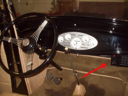

    I did a tech thread on this sort of thing a few years back, check it out here
    Technical - INSTANT HEAT, just dont add water (TECH WEEK) | The H.A.M.B. (jalopyjournal.com)
    It has been installed in my roadster for quite a while now and it works pretty well. My power gen is 100 amps and at an idle the heater dims the lights a bit. At speed it works well enough to keep the chill off. The unit was designed to heat truck cabs and golf carts and the like. It is wired direct to the battery (through a breaker but not through the fuse panel)
    I didn't want heater hoses on my blown flatty so this was my fix.
