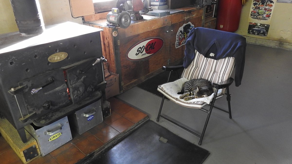

  13. Vintage all the way :D 20200424_143542.jpg
    caseywheels likes this.

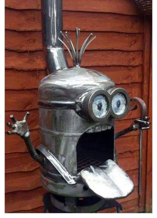

  17. I want so badly to build this, but every time the local s**** yard gets a stainless container just about the right size or shape for a start, it is so doggone expensive even at s**** prices, that I am saddened to think I may never get to build this. Screenshot_20191103-231350_Chrome.jpeg
    I know it looks outdoor bbq grille design, but I can easily change it a little to make it controllable for indoor use without ruining the cool style.
    In the meantime I have been using a thick metal fireplace insert, free standing without the actual house fireplace around it.
    I did some welding to make it free standing on a concrete pad to radiate much better, and put it on a concrete base in the corner. It has the the cool looking well sealed gl*** and iron fireplace doors that came with it, and looks like a cross between a tight control fireplace with glowing fire-gl*** windows and something out of the Nautilus nuke furnace in 20,000 Leagues Under The Sea.
    In the winter I like sitting in front of the hot fire doors with flickering glowing windows, while grading papers, or enjoying a hot meal after a nice cold bike ride. The fire gl*** sure adds atmosphere.
