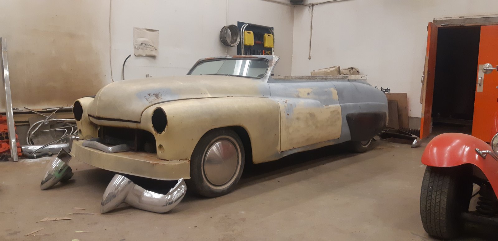

    So about 2 weeks before Christmas I walked into the room where my wife was wrapping Christmas presents. She was looking out the window leaning on the window sill watching the snow come down. I walked up beside her and slapped her **** (a love tap) and leaned against the sill watching the snow come down. She slowly turned and looked at me and said, "So this is what retirement looks like ,eh? " I knew right then and there that I should go to the shop and start working on a couple of the 49 mercs I had kicking around.

    The one with the roof cut off is a 4dr that some turned to a tub using coupe doors.It iis on an olds ch***is and floor pans so I won't show that. However I will be doing chrome vent windows , roll up door and 1/4 windows and a whittled down 56 caddy convertible top bows. 52 caddy wheels and sombreros 50 dash modified to take a 62 chrysler speedo, as well as a bunch of other stuff. I hope to use up a lot of stuff that is laying around my shop. This will be a low buck build.
    The second one is a 49 coupe that has a 56 olds 4drhdtp roof narrowed to fit the merc with a merc back window, it has 54 ft of cuts and welding in the roof . It will be going with a stock frame with a 9 inch rear end and a 401 Buick nailhead.

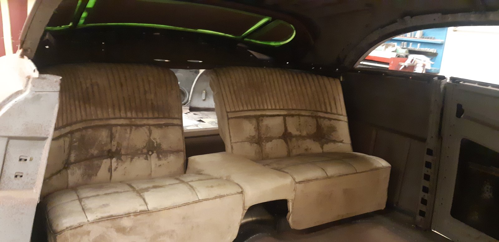

    I also included a couple of pics of the second merc. The ch***is and engine for the second merc are done, its sitting on a roller right now.

    Fortunateson, I finally started using the bead roller ! :)I did the complete roof and all the floor and rust repair as well as the complete ch***is with the 401 nailhead on the 2drhdtp and floor repair and am currently doing the caddy top bows on the convertible merc as well as a lot of other stuff but that one came in looking pretty much like the top pic.

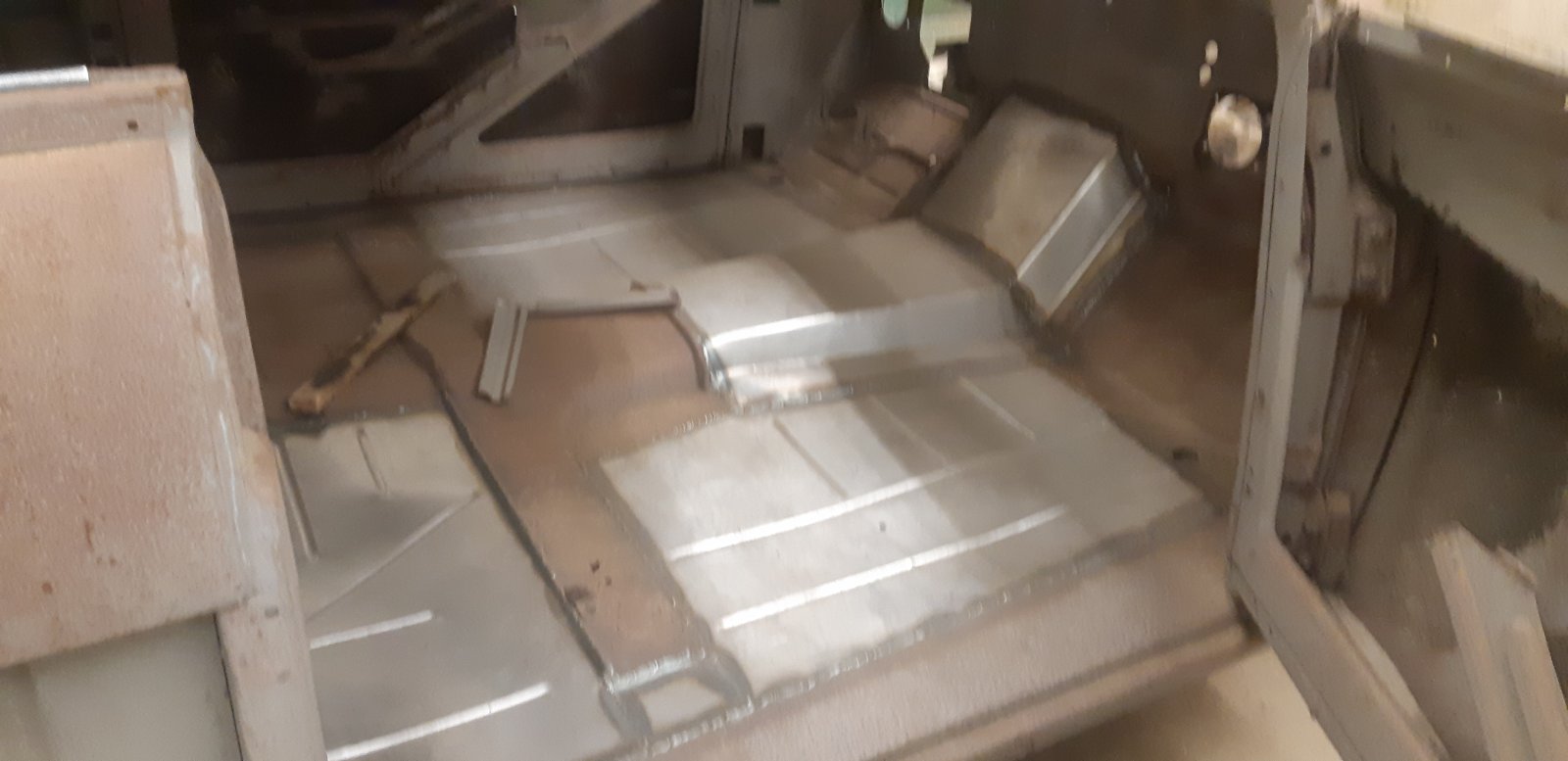

    So the floor pans , ****** hump and a bunch of stuff is happening . I also still have small rust repairs as we as deleting unneeded screw holes and bolt holes etc.... I live out in the sticks so everything has to be mouse proof.

    desotot
    The ****** hump is slightly swollen from stock to enable easier trans removal and maintenance. I have the fame set up with a 65 401 sp 400 but I also have a 401 with a 4spd and am considering going that way instead.

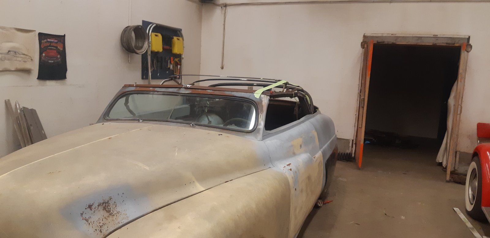

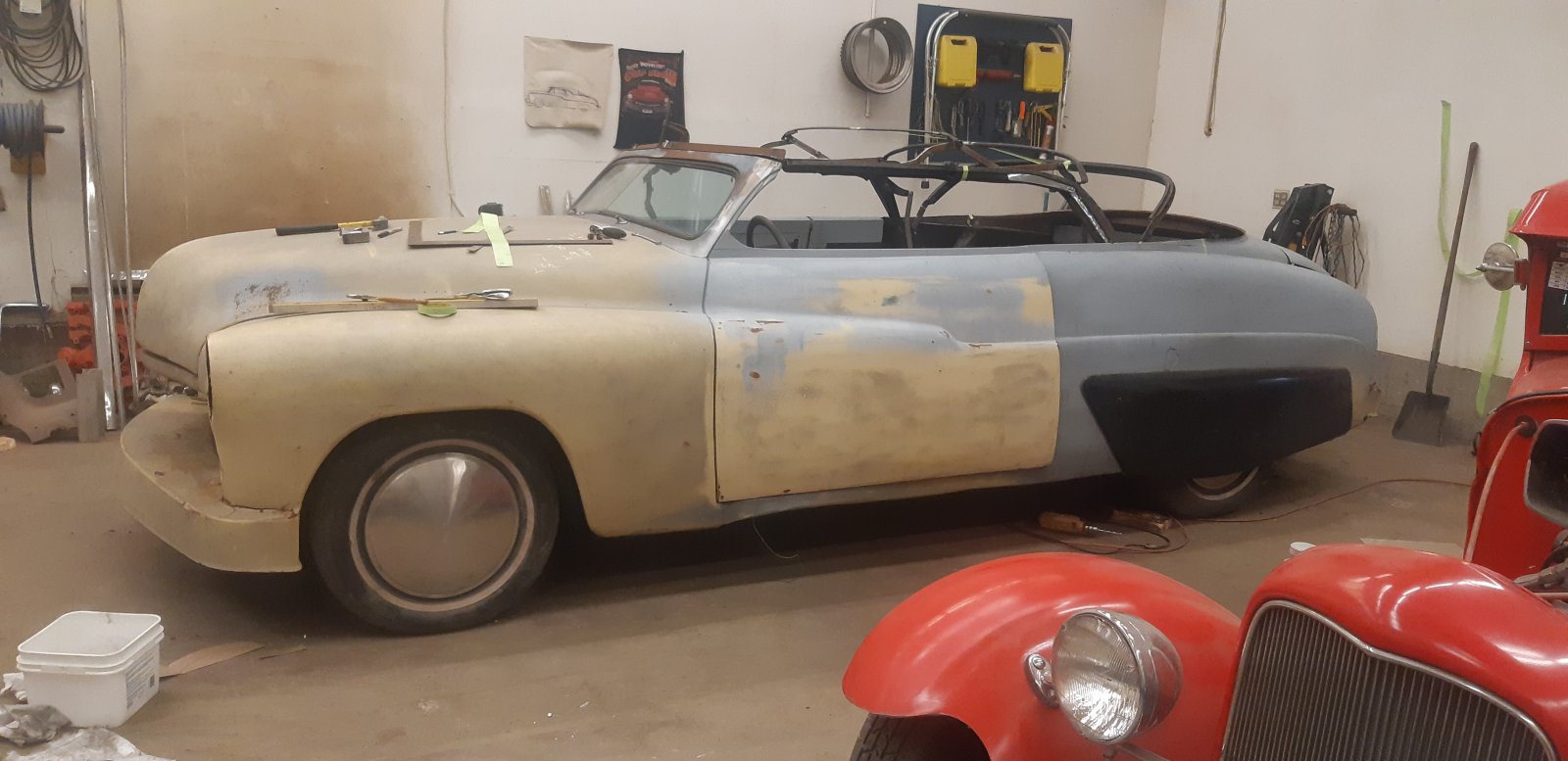

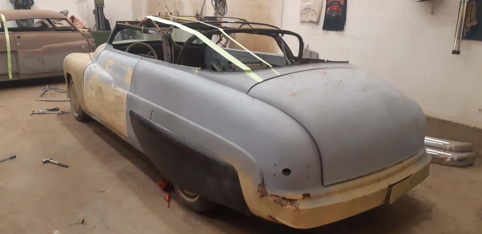

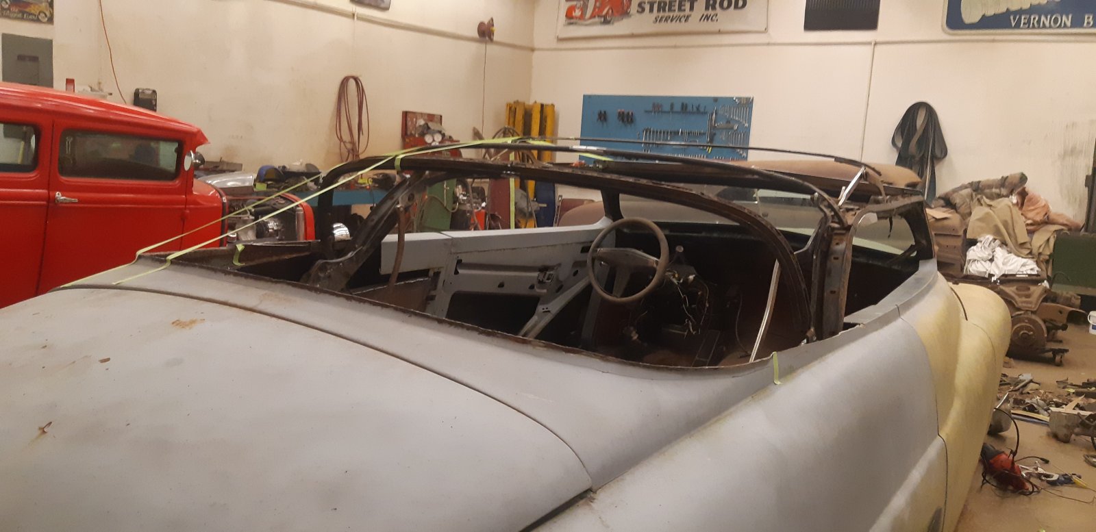

    So, I have the top mounted on the rear pivots well as narrowed, etc. It looks like I may be able to install the rams as well. It's really a lot of work, once the top is satisfactory I will work on the side gl***. At that point I will have a rag top automobile ( Kentucky Headhunters ). 20240119_170700.jpg 20240119_170918.jpg 20240119_170737.jpg 20240119_171101.jpg 20240119_171042.jpg
