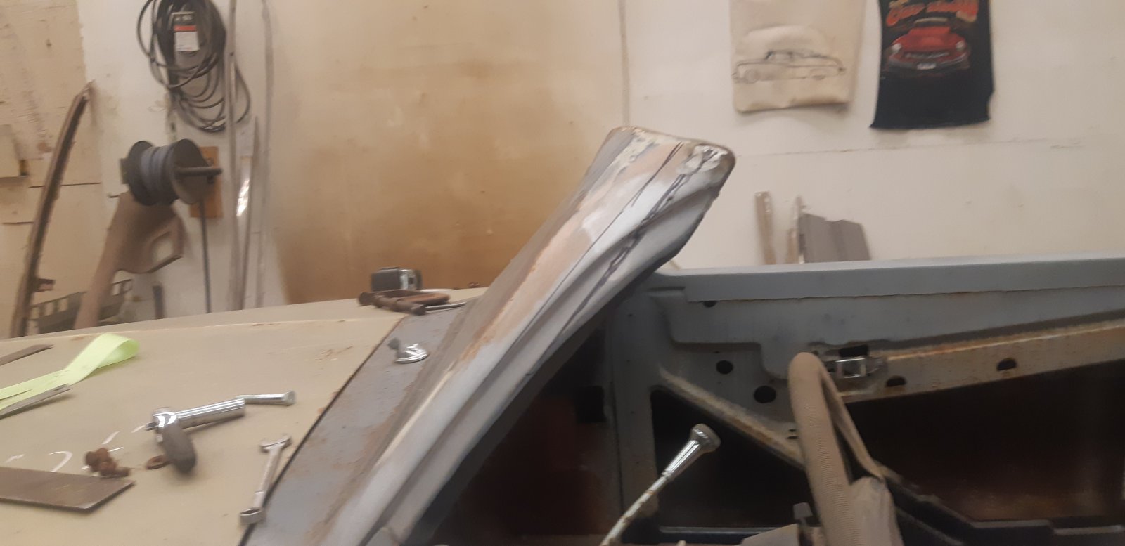

    I will need to work the windshield posts some. They need straight lines. 20240119_171150.jpg

  5. Here's mine still a 4 dr, it takes a lot of work to do the windshield posts and the inside across the top. The windwings help make the liget convertible look. VW conv windwings and side window gl*** fit right in a 4 dr merc front door, regulators and all.

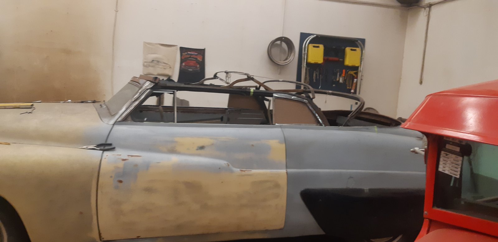

    Although I have worked on so many convertibles over the years, I personally have always preferred a painted roof over a ragtop or Carson top.... until I finished a chop on a buddy's convertible that another friend had started but sadly he didnt live long enough to finish.

    20240127_120249.jpg I have the start of the vent windows installed, as well as the 1/4windows tabbed and installed with the pivots and inside tin. Still lots to do , such as guides channels, stops and regulators. Good thing I have a lot of **** laying around. The thing is to have every thing in the right place to make sure it will work. Then I will have to dismantle it all again to finish and clean it all up .
