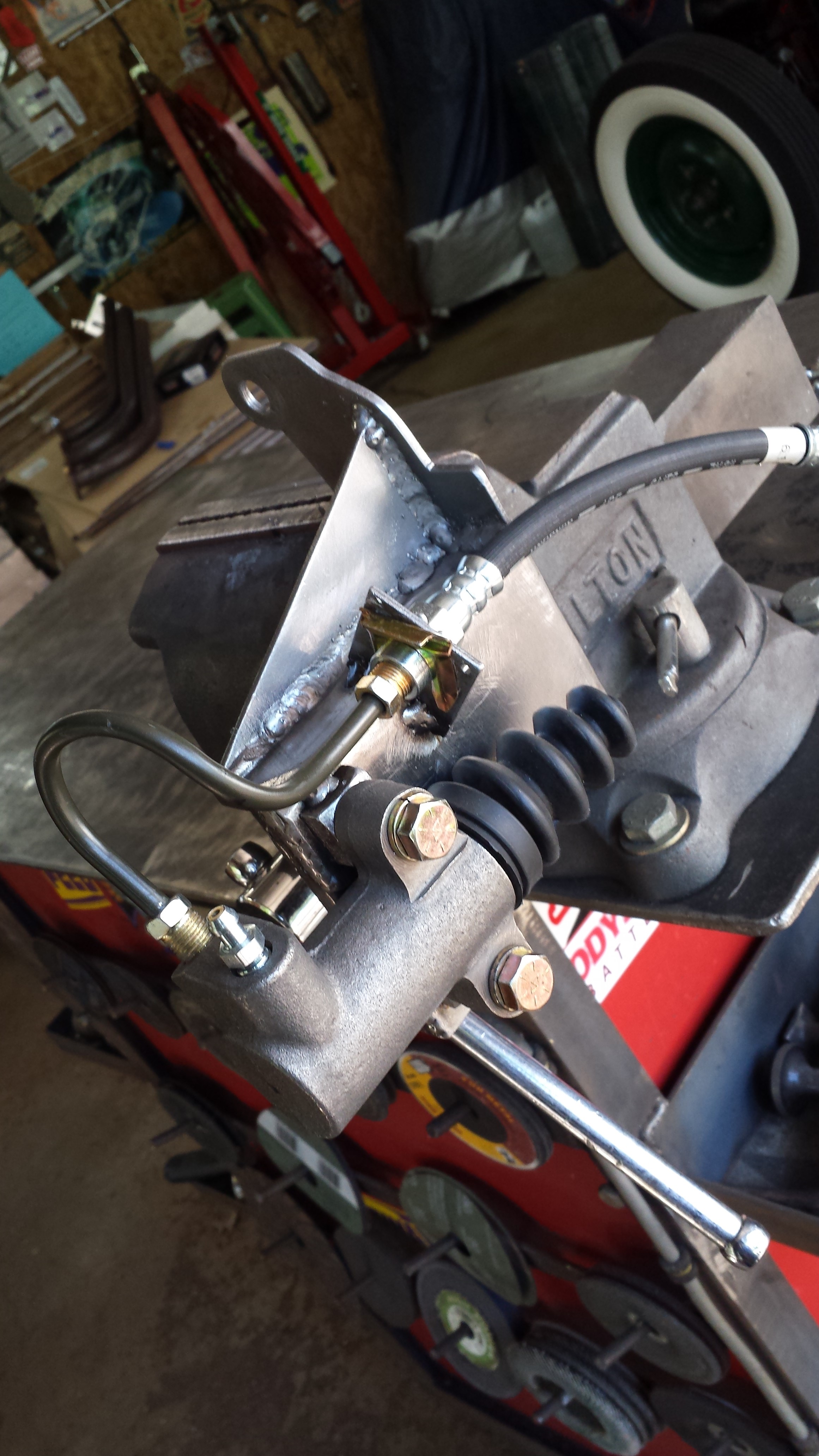

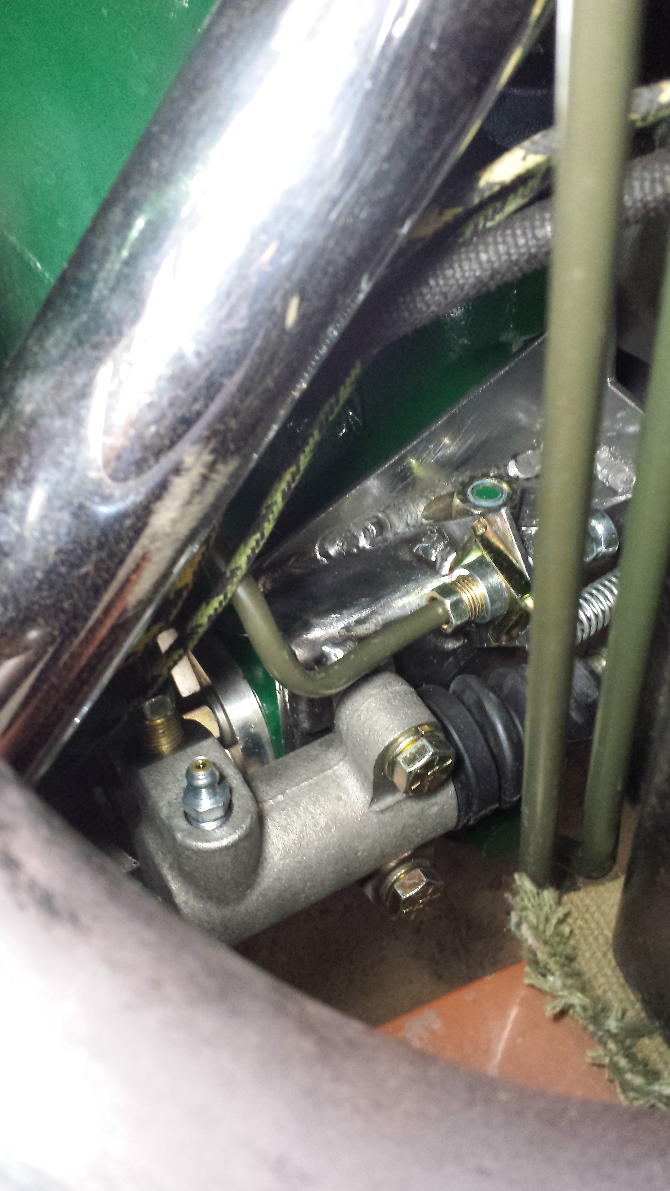

    I'm currently running a 3-speed Saginaw in my roadster, behind a 324 Olds, and my clutch pedal is much heavier than I'd like it to be. I'm running a 1940 Ford brake master cylinder, and running that to a CNC push slave cylinder via braided steel line. The stock master is, I believe, a 1.0625" bore, and the slave is a 7/8" bore. Is my heavy pedal problem just a matter of disproportionate bore sizes? Or is the CNC slave just junk? Both? master.jpg slave.jpg

  4. The 7/8" slave cylinder is too small for that master. Get a '60 Chevy pick-up slave cylinder, works good and the mounting is similar.

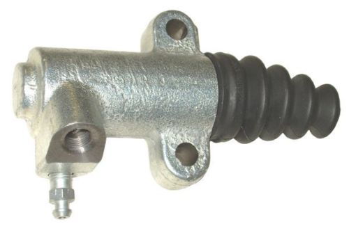

    Like this one here, Rich? These apparently have a 1 1/16", bore, so this will put my ratio pretty close. If I'm understanding correctly then, what I want is that ratio to be as close as possible then, yes?

    The 60 Chevy pickup is for the passenger side of the bell housing. I have a CNC 7/8" slave and a Willwood 3/4" clutch master, and it works fine. 1 1/16" M/C is too large.
    Ago
  9. Sure the small bore slave work would fine with the small bore aftermarket master; but I think it looks like Marx is wanting to have a traditional looking master cylinder on his firewall.
    And while Chev originally mounted the truck slave on the right side, it is easy to mount on the left side. We mounted several of them so far this year using either the Chev dual or early Ford masters.

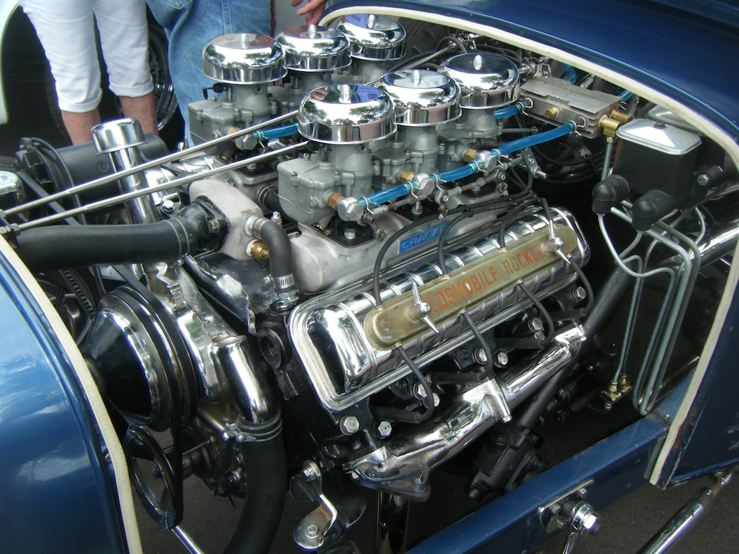

  10. Stole this picture from tb33anda3rd's Back to the Fifties post, if you look close you can see the Chev slave cylinder we used on Chad's 324. upload_2014-6-23_22-9-18.png

    I like that the Oldsmobile engine is a real engine. I don't understand why some people fake an engine that it really isn't. I also believe that if a single M/C brake system is (carefully) maintained

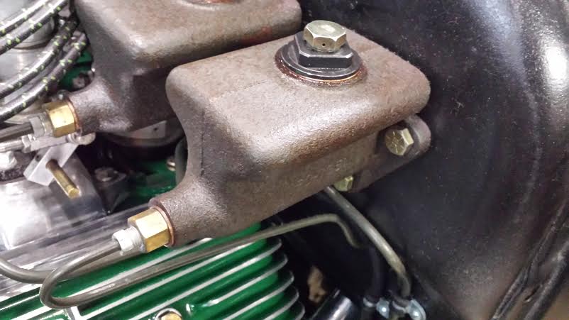

    Rich has it right. I'm running side-by-side early Ford masters because I love the look. Plus, it was a lot of work snuggling them onto that T firewall! Any solution I'm looking for will lie solely on the slave end of the equation. Otherwise I'll just leave things as they are, and let my left leg get much stronger than my right.

    That's a lovely engine bay. I'm really impressed.

    On the Chevy truck slaves: between Bendix and Dorman, each makes a 1" and a 1.0625" bore. The 1.0625" would put me at a 1:1 match with the M/C, so can I assume, from all the math so far, that this is the ideal ratio I want to start with?

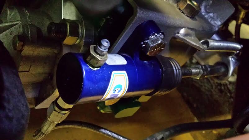

    Just wanted to update the thread. As advised, I pulled everything and started from the top. Replaced lines with 1/4" and the slave with the 1.0625 Chevy slave. Replaced the braided stainless hose with an early Ford rubber brake hose. Rather than start over on the bracket I'd first made, I was able to trim and modify it to work nicely with the new set-up.
    Long story short: it's like driving a totally different car. Problem solved! dirtracer06 put it right: it used to wear my leg out like crazy. Driving in slow heavy traffic sucked. It's more fun to drive my car than it ever has been! Going through the gears is a blast!
