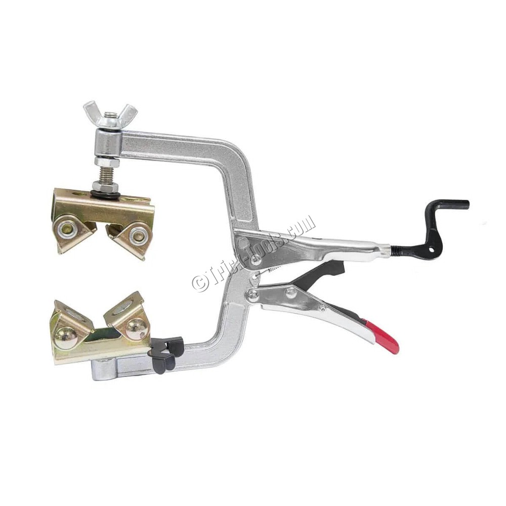

    I have taken to using these.
    https://www.trick-tools.com/Multi_Purpose_with_V_Pads_Small_Adjustable_PG635V_2039

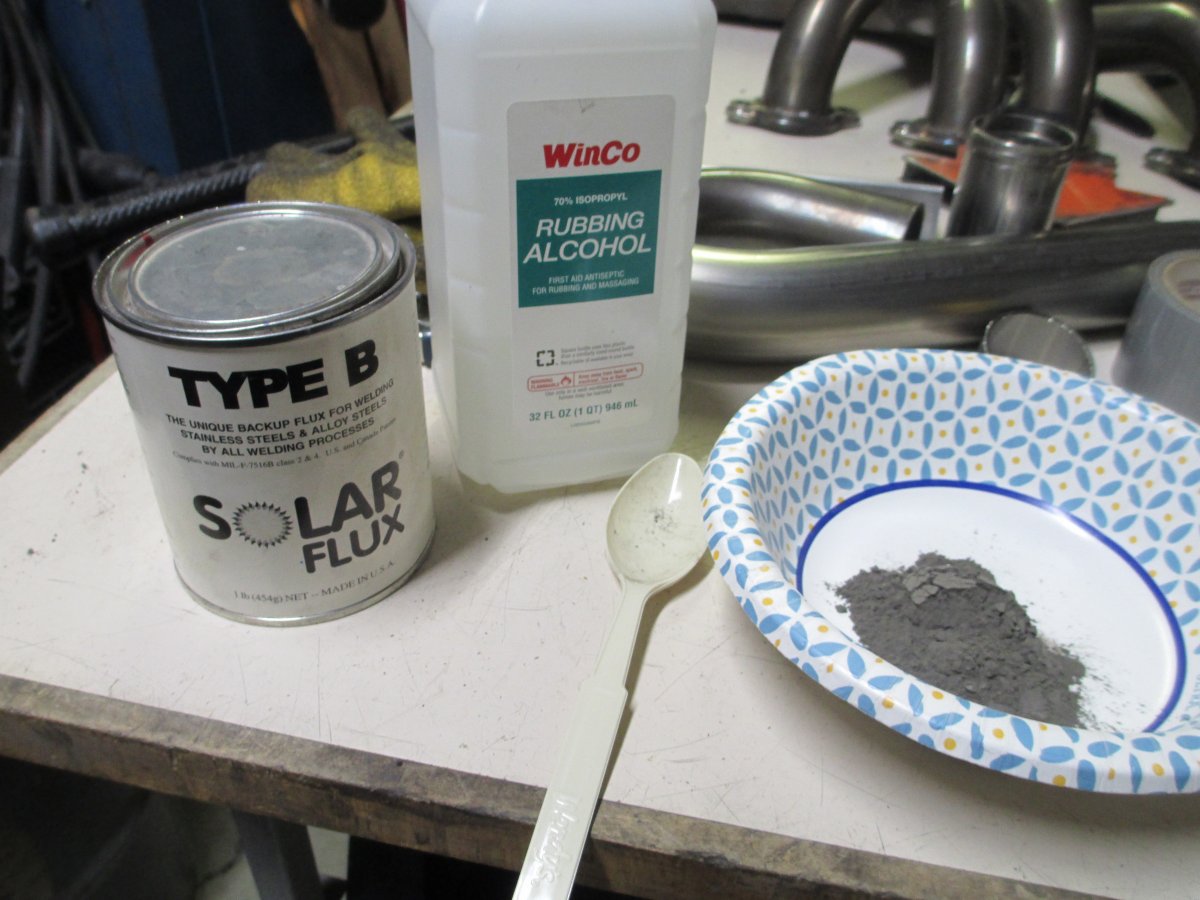

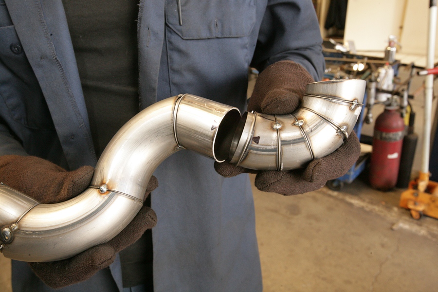

    I'm with you Mike. I drill stainless hose clamps, to hold the sections together and tack weld at the holes. Also, to prevent weld run through, I have tried Solar Flux, with great results. IMG_4765.JPG IMG_4769.JPG IMG_5443.JPG

    Marty what is weld run through? And what does the flux do?
    I'd either use some of the big clamps as shown above, make some hose clamps like Marty, or have an ***istant hold them tight while I tack. No way I'd have the inside of my pipe filled with cludgey rings.

    You mix a small amount of the powder with alcohol, into a paste, and smear it inside the weld joints, before welding. It works well, to stop the weld from leaving a rough weld protruding on the inside of the pipe. It's more of a problem with stainless, than mild steel. Purging the pipe with argon, is another way to keep the joints smooth on the inside.

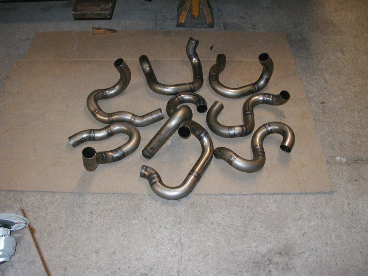

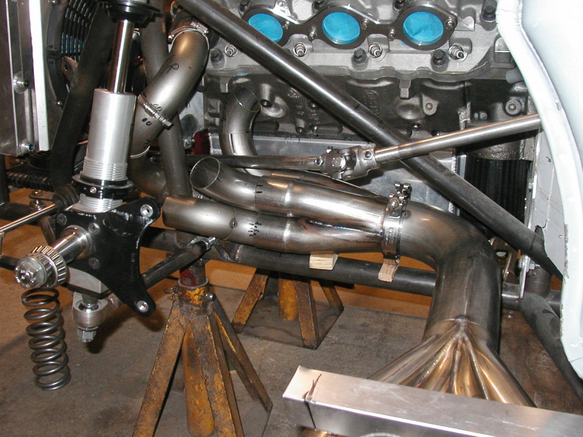

  14. Exactly how I've done it for years and many sets. Yes you can hold a joint together on a bend, look at the front pipe underconstruction. Works very well and keeps the pipe true i.d. full length.
    Here's all 8 pipes done and not yet welded to the Flanges and ready to get the inside welds cleaned up. That's called Extrude honing. Probably way past anything guys here would have done. Two reasons for it, clean flow and no hot spots.
    Turbulence inside pipes costs ya Horse Power.
    Nostrebor likes this.
