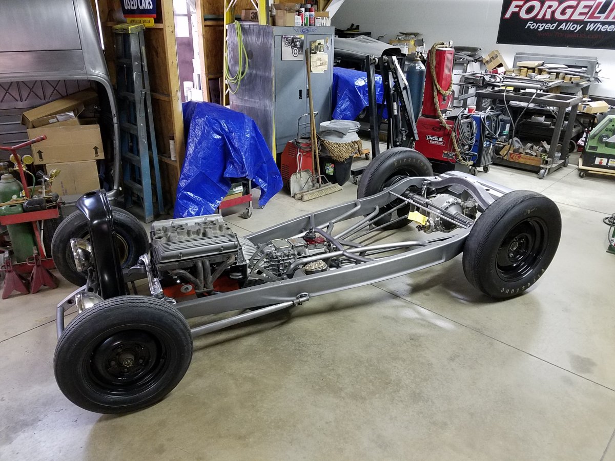

  11. PBRmeASAP
    Joined: Aug 26, 2002
    Posts: 6,893
    PBRmeASAP
    not sure if this is a really good usable pic......
    if you measure from top of the frame rail to the cyl head it's 4 1/2".
    Stock 32 frame, stock 32 body....but it's a Chevy. Not sure if this helps much, but really need something better that cheesy block hugger headers

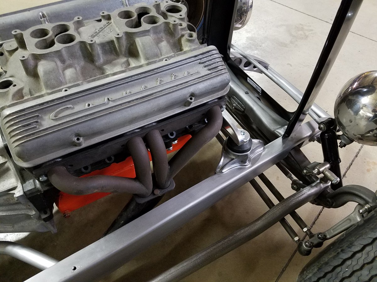

  13. tb33anda3rd
    Joined: Oct 8, 2010
    Posts: 17,595
    tb33anda3rd

  15. tb33anda3rd
    Joined: Oct 8, 2010
    Posts: 17,595
    tb33anda3rd
    thats in a 33 chevy, by the way. frames should be real close to the same width.

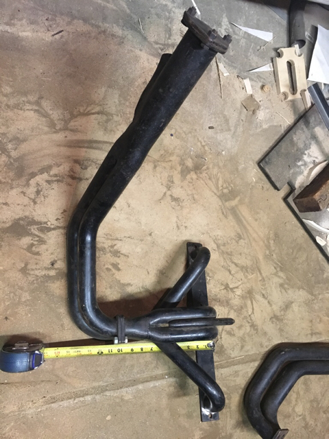

  27. guyontheHAMB
    Joined: Oct 1, 2006
    Posts: 77
    guyontheHAMB
    from chicago
    loudbang and PBRmeASAP like this.

  29. bchctybob
    Joined: Sep 18, 2011
    Posts: 6,624
    bchctybob
    Those two piece ones are nice. I used to see them every now and then at swap meets but I haven't seen any in a long time. You're lucky to have them, and they seem to be in great shape for being so old.
