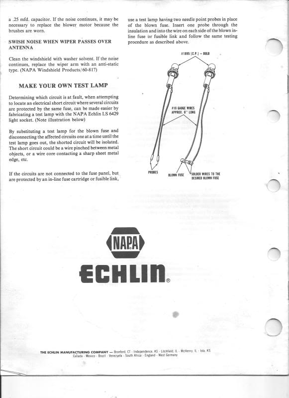

    I've got the pages out of a bulletin NAPA put out 30 + years ago on troubleshooting HEI distributors on my photobucket . There are eight pages in the booklet and it bailed me out a number of times troubleshooting these things and even saved a buddy a tow job on a road trip in his motorhome as he had a copy along that I gave him. http://s173.photobucket.com/user/mr48chev/library/Napa HEI service info bulletin?sort=3&page=1

    Napaheipages001.jpg Napaheipages2003.jpg I've got a smug mug account but haven't transferred them there as no one has complained before.

    Hopefully in order napaheipages3001.jpg Napaheipages4001.jpg Napaheipages5001.jpg

    NapaHeipages10001.jpg NapaHeipages11001.jpg NapaHeipages12001.jpg NapaHeipages10001.jpg NapaHeipages11001.jpg NapaHeipages12001.jpg That should be all eight of them.

    Thanks for all the comments. A new pickup coil seems to have fixed it. The Eichlin bulletin is also very helpful.
