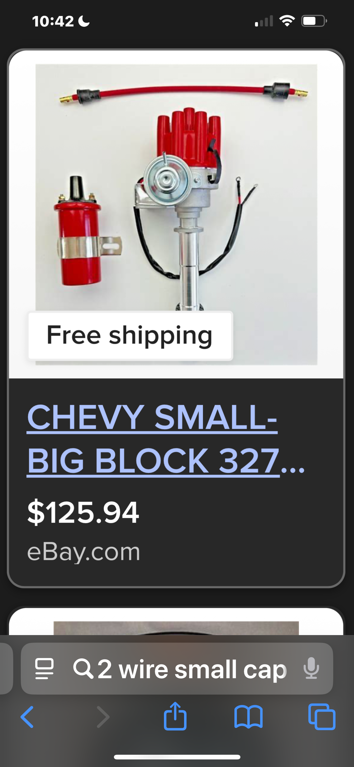

    Some being sold are likely made offshore and the electronics might be suspect. If I wanted one I’d look at davessmallbodyheis.com, he has an electrical engineering background and converts GM distributors. You will get reliability and the look of a factory point type distributor.
  3. RodStRace
    Joined: Dec 7, 2007
    Posts: 9,289
    RodStRace
    Yeah, we are all cost-conscious, but the cheap stuff is going to let you down. Is it cheap enough to buy two and have a spare to swap out on the side of the road?
    The whole reason for moving from points to HEI is set and forget reliability. If it's not, might as well buy a points setup and be able to adjust and repair.
    Some swear by points, some with unilite, others MSD. I'd look at who stands behind their work. Call the hotline and see if it's waiting room hell and if they blame install or other accessories. The thing should require a feed, a couple wires between the coil and dist. and flat out work. Having advance components that are adjustable and replaceable is a plus.

    With Thought , you can add 80s 4 terminal
    Gm HEI modules to any distributor ,
    Accle even made in 90s ,
    Mollary made a unlite kit in late 80s to convert point cap to unlite , you can still do with thought,
    MSD now $500 rang !
    hide module in a different location.
    Those cheap O -S 2 wire electronic distributors work ,
    The come with cheap cap & rotors
    Quality,
    Distributor I've seen as low as $60
    With out coil , Ran one for 20k with No issue

    I had a cheap-O eBay one on the 283 in my '34, it's still running great after 8 or 9 years.

    Mine is similar, eBay as well. It came with wires and a huge coil. I was able to swap the coil for a round one. I have 13k miles on it.
    The vendor is "the swap meet parts". I've bought other items from them since.

    That's not a bad price at all for one that seems to work that well!
