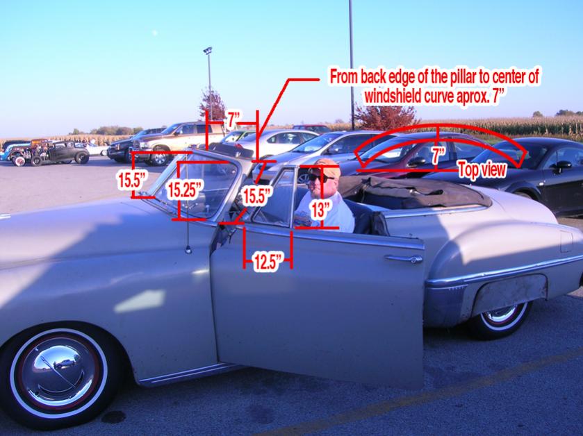

  13. modelamac
    Joined: Aug 9, 2007
    Posts: 326
    modelamac
    here is what I got....
    just quick measurements I done at lunch.
    Hope this helps.... If you need something more detailed PM me.

  15. 52carsontop
    Joined: Aug 10, 2011
    Posts: 149
    52carsontop
    from East TN
    Hey modelamac, thanks so much for that diagram. Going to check out the car tomorrow and do more research. Thanks again!
