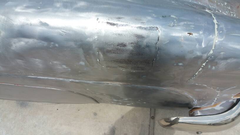

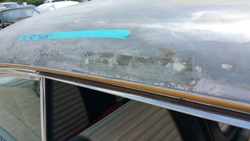

    ELGATO
    Ground down to metal , now to start the metal work . previous work started cracking, spider webed , also lifting some moisture trap was causing surface rust underneath primer . customer waned to see what was underneath so down i went . Gonna clean up and make some new patch panels for some sections were fibergl*** was used . Also go over the overlap work and recut butweld and metal finish before i start my body work .
