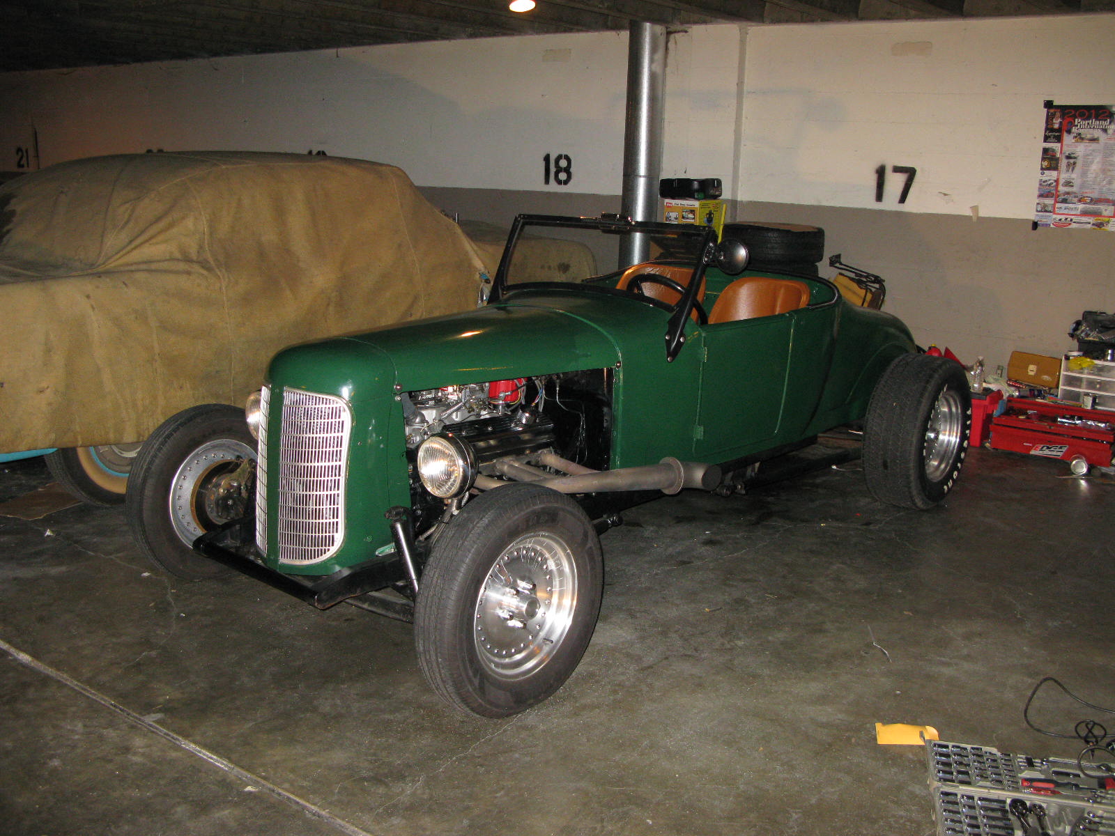

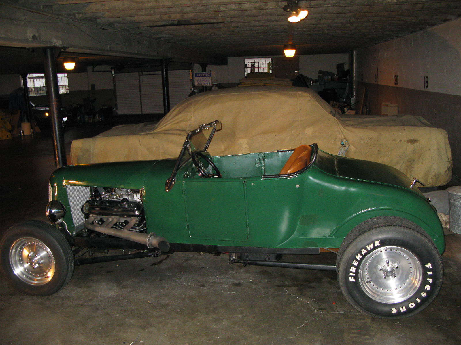

    Basic specs:
    Body: Henry Ford steel from the firewall back, 1940s era Oliver 60 tractor nose and grille (!!!) with a B grade homemade hood connecting them up. Wearing lumpy uneven green paint.
    Interior: bare metal with nice trick real leather bucket seats. Currently there is a mat I made from a doormat with a hole cut for the shifter. Glass door knob shift knob. Its only temporary
    Instrumentation: a set of mismatched but working gauges, expect the old cable drive speedo (the best looking gauge of the lot) doesn't work with the electronic output of the late model T-5.
    Frame & suspension: pretty decent homebuilt custom tube frame, with nice solid axle/kingpin/leafspring set up up front and floating coilovers & radius arms on the rear. Disks upfront, drums in back.
    Drivetrain: fresh 1999 Vortec roller 350 SBC, Edelbrock carb, T-5 Worldclass manual trans (smooth hydraulic clutch!), 8" Ford rear, Disk front. Electric fan & fuel pump. Lake headers with open metal baffles-- surprisingly enough, they sound great with the smooth modern SCB.
    Here are some pics in her current trim -- believe it or not I have spent hours and hours cleaning her up to get her to this point, including removing yards of tacky decals and stickers, covering exposed wires, weatherstripping rattling parts, and removing handfulls of tacky rat rod crap (as en example, the shifter knob was a beer tap). And I touched up the paint, although it is an open question whether that improved anything. . .
    On the list is upholstery and flooring, better gauges and dash, vented or louvered side panels (to hide the modern engine), 16"+ wire wheels, '50 Pontiac tail lights, better paint, and a thousand little things.

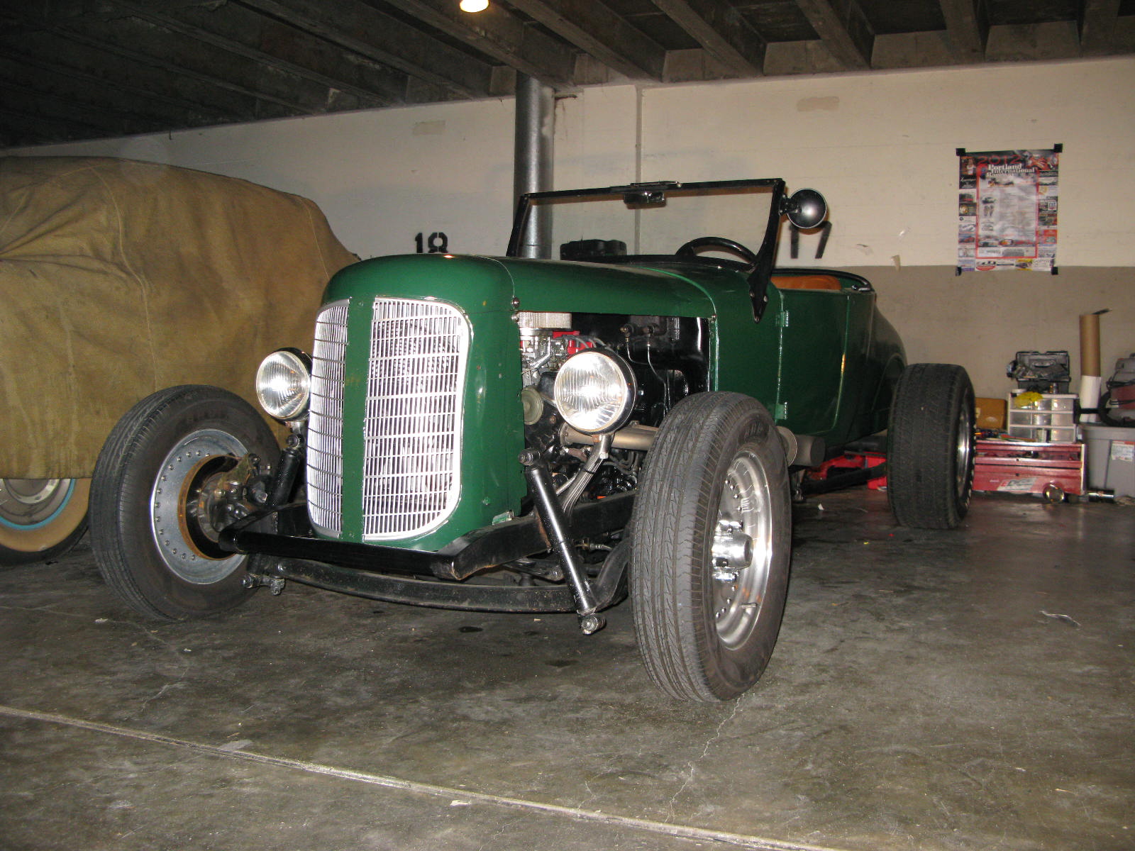

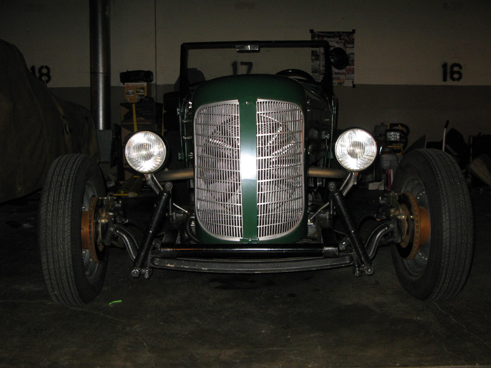

    Still making up my mind on whether to keep the Oliver 60 tractor nose and grille. On the plus side its pretty cool looking -- almost like a period racing nose, fits the shape of the roadster body perfectly, is real vintage steel in perfect shape, holds the electric fan assembly and trick aluminum radiator perfectly, and is pretty unique at least in my limited experience. On the down side, well, its a tractor nose :(
    Also, rollbar/rollcage -- yay or nay?
    And, I have a hokey set of homemade bows with no fabric that came with, but I can't sit upright with it in place. . . do those of you with tops ever use em? Is it worth the effort to get/make a top?
    What do y'all think?

  2. welcome, your plan sounds good, and i agree with you on the looks of the grill. i would keep it! did you try to wet sand and buff the paint?

    T'were it mine, maybe a Deuce shell, and a more bench style trad seat. You've got a car that is great to drive. Roll bars and cages serve, depending upon how (and in what arenas) you drive. Then it becomes a question of head knocks or a helmet, and bar padding. A top cuts down on the windburn, get a good design built, (shop around for a pro, a craftsman) it is worth the investment if you drive more often.

    Not bad at all! Even the tractor nose seems to fit, unlike most attempts. If it was mine I'd change the wheels to steel wheels with trim rings and caps, build hood sides, and drive it. Please don't spray it flat black. That would be a big step backwards toward rat-roddiness. Sand and paint it another color if you like, but I like it even in blotchy John Deere green!

    I was prepared to hate your tractor grille and hood, but damn man, they fit that car perfectly! The proportions look great and definitely give you a racer look, all while being unique enough to not get confused with somebody else's cookie cutter rod.

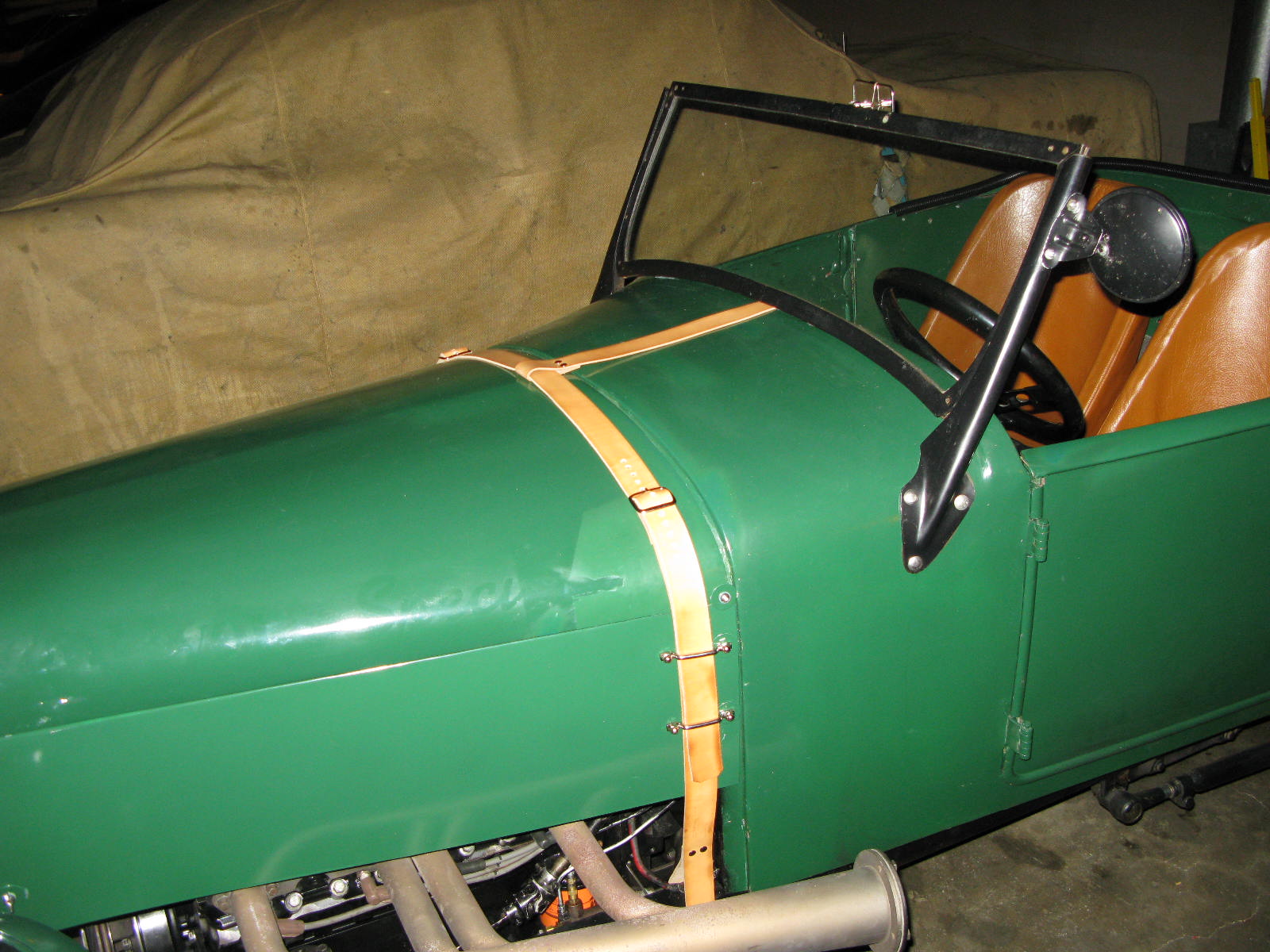

    So, I have spent a lot of hours tinkering on the '26 Roadster since I last posted.
    Major additions include fabrication of side panels (I started with sheet metal and using hand tools rolled the edges and contoured them to fit), and made some leather tie-down straps with footman's loops, did some repainting, and a hundred other smaller things.
    Opinions?

    I would change a lot on that car, but that's just me. It sounds like you've got the right idea of what this car needs to make it appear to be more traditional.
    I'd change the wheels first thing.. That tractor nose isn't too out of place either. It sort of matches better than I thought.
    As for a top.. I plan on having a top on mine and I know I will use it a lot. Mostly on the longer trips. I don't like being sunburnt. :D But there are other guys that are more hardcore than me and run without one. It's up to you.

    And it has a significant advantage over most other grille shells I have seen -- the electric fan disappears completely inside. You can see it in this pic.
