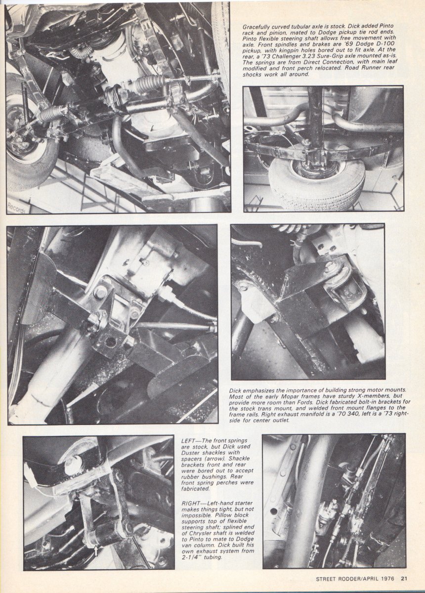

    Here's some info from an old magazine. **** Maxwell's '37 Plymouth 4 door. Magazine is older than you are! Didn't include the whole article but it says he used rear springs P3690265 and P3690266 from Chrysler. Scan-180816-0001.jpg

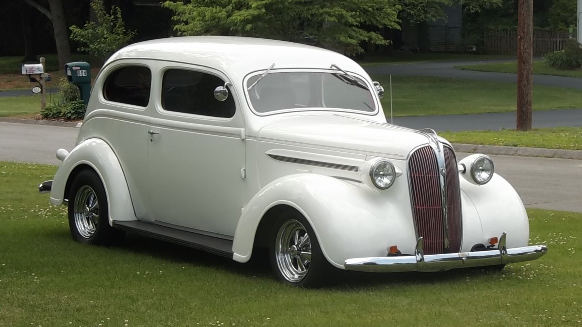

    Here is a slant back sedan I had a few years back, I didn't build it but bought it pretty much as you see it. I always thought the front of the 37's were pretty cl***y looking. 4 1937 Plymouth slantback 2 door sedan.JPG 6 driveway line up.JPG

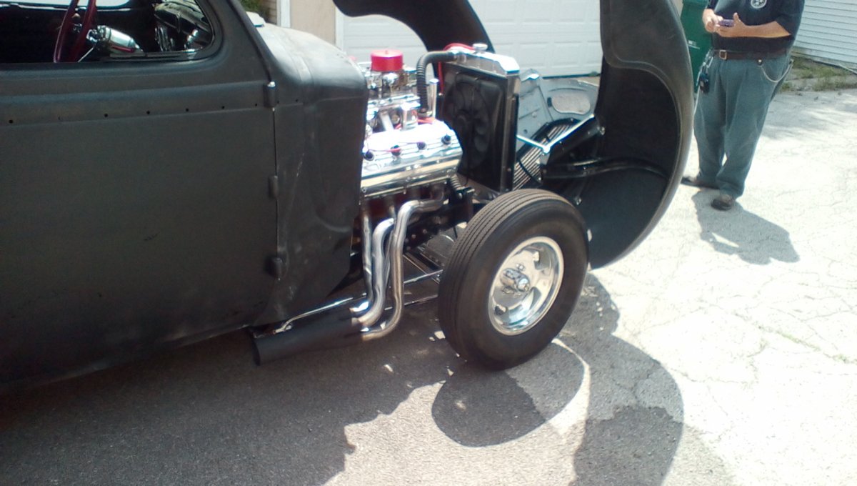

    Just a little inspiration for you. This is the 1937 dodge coupe (Plymouth front end)Dad and I are building. We still have a lot of bugs to work out but it has come a long way from the picked over parts car we started with.We Kept it almost all Mopar with a 392 Hemi, Torqueflite and 8.75 rear. Good luck with your build. 6-16-2018-3.jpg 5-26-18-2.jpg

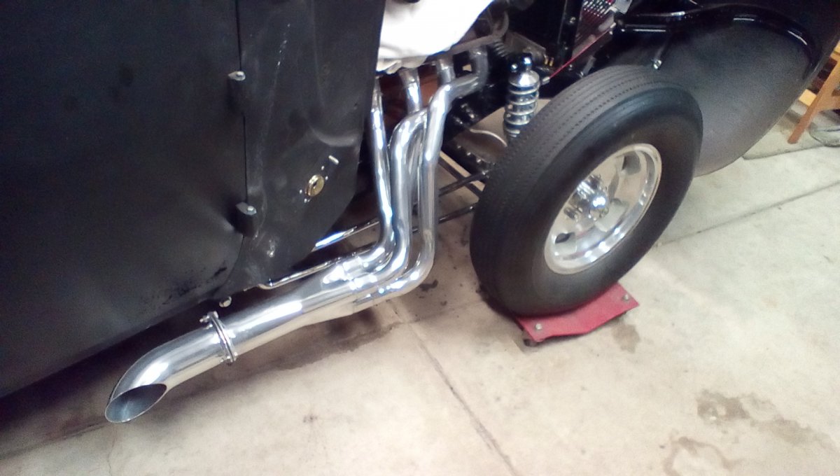

    ? Where did you get the header for your 37 Plymouth like the hemi[emoji1320]
  20. slayer
    Joined: Jun 5, 2005
    Posts: 2,073
    slayer
    I had them built by a local exhaust shop. I'm not real happy with the quality, as Dad and I had to spend a day fixing them. They don't look to bad after coating. 6-17-17 pasenger header.jpg 10-15-17 header passenger.jpg
