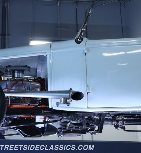

    Oh my god, look at this picture? if you get a flat you will grind the bottom off the oil pan....Run away as fast as you can

    So everything is too low, then the question is can it be raised without hitting the body. I don't mind having to modify things especially for the price. But again, I had not noticed that. And why I got here and asked questions. I knew there would be guys on here to stear me!!!
    Thank you...

    I enlarged a few photo's and spotted the oil pan being below the scrub line like Jim pointed out, flat tire and you will damage the oil pan, the frame appears to be a Model A and shows some pitting when you enlarge the photo.
    It appears the body has been channeled over the frame, the body normally sits on top of the frame.
    I am a long time Deuce guy and knowing what I know if it were me I would keep looking, there are reasons why it's priced lower than most '32 roadsters. HRP

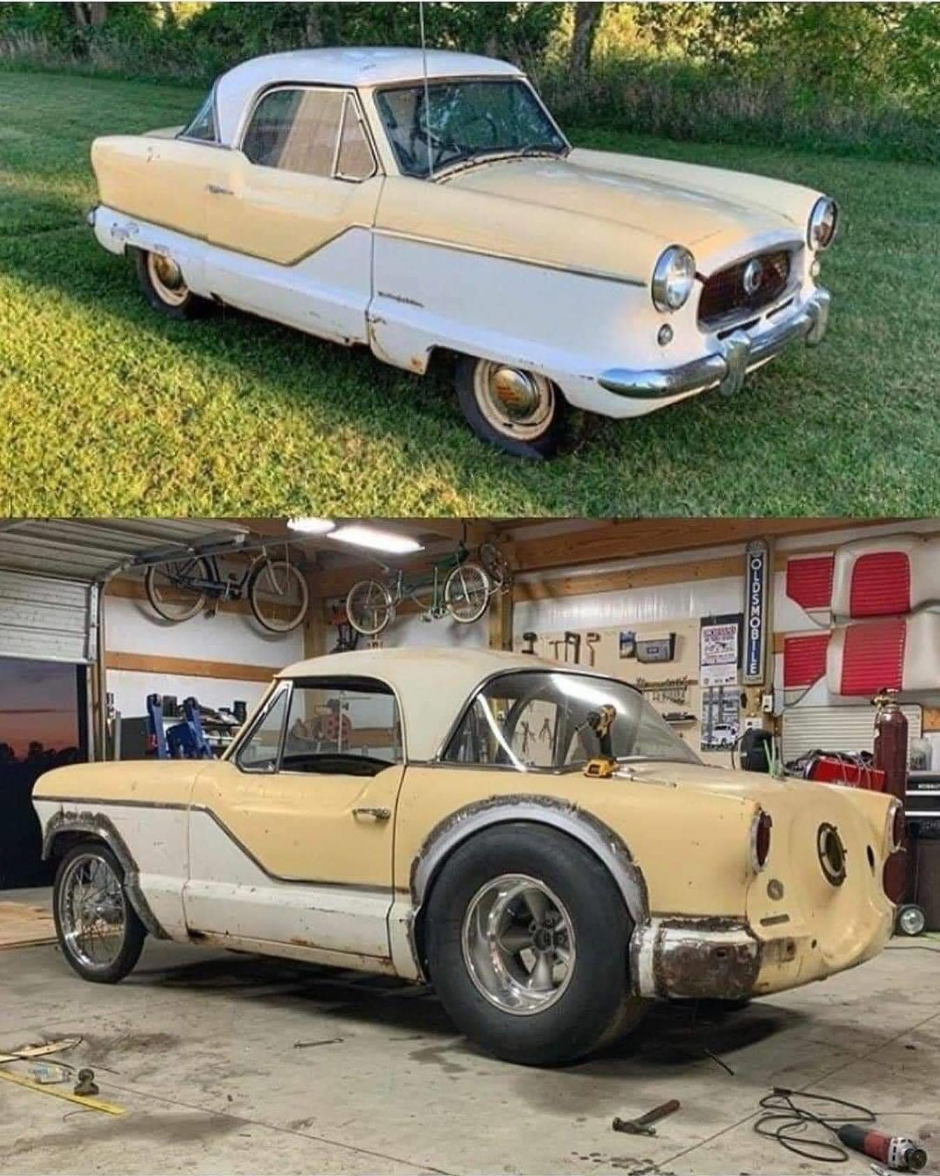

    Copy that, I think I will investigate this further before I throw in the towell. Cause then wife gets involved and she found a Metropolitan that she thought would be better...
    https://www.facebook.com/share/14wGS4XLFu/
    I don't want to have anything to do with a metropolitan unless it's like the below.

    It is a terrible idea to buy a hot rod from half way across the country without seeing it in person. who ever built that did not know what they were doing.... you can tell by how low the engine is mounted...
