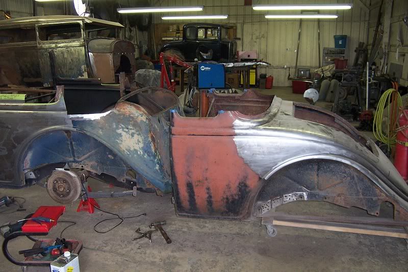

    Next on the list was cutting out the roof beltline. I won't show the pics because I probably wont use the sedan beltline, just the 5w one, but here's a pic anyway, because it's funny.
    MR. FORD and KUSTOM 7777 holding the roof piece with the sliding-bar-appliance-so-it-could-be-split-and-stay-where-it's-supposed-to-total-waste-of-an-afternoon-thingy welded to the inside:
    Anyway, to the important stuff. Had to figure out how the sedan would be cut to accept the coupe back. The plan was to split everything on the fenderwell bead in the center and join them that way. Here they are side by side:
    Did a bunch of measuring and line-drawing and discovered that the sedan fenderwell bead is TALLER than the coupe bead! That means that the radius is larger and so is the fender. Never thought to compare the coupe fenders with the sedan ones, I just ***umed that the fenders were different in the rears only, but not true.
    That is why the Chrisp '35 3W and the Norwegian Blacksmith '36 look how they do. They both use the larger sedan wheelwells AND altered sedan fenders. I want the stock coupe look, like Foster, and since I'm lucky enough to have a pair of coupe fenders...
    ...decided that I would use the entire driver side of the coupe back since its perfect and figure out the p***enger later. Cut the sedan a 1/4" behind the b-pillar on the left and in the center of the wheelwell on the right:
    I know this looks bad, but don't freak out!! Im gonna use the humpback trunk area for something cool on this car, so it won't go to waste.
    The driver's side will be a cakewalk since the weld seam has the added benefit of being right next to the 90 degree bend of the b-pillar, so minimal warping. The p***enger side will be more of a challenge. Since that side is boogered, I found another coupe back south of Fort Worth:
    The plan was to cut where the blue tape lines are and use it to replace that side on the coupe back, and join it to the sedan 1/4 in the wheelwell area. Confused? So am I.

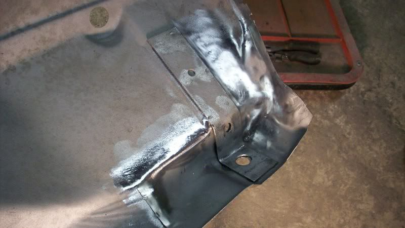

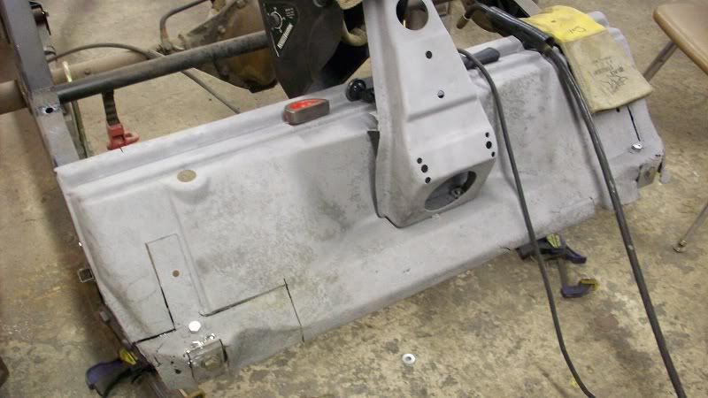

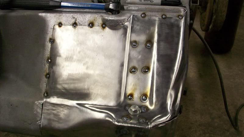

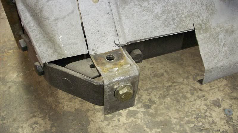

    Well, this puts us at about two months ago at the end of January. The next challenge was the tooltray:
    It's basically the rearmost part of the floor and connects the body in the tailpan area with the back of the frame by bolting through two body mount brackets:

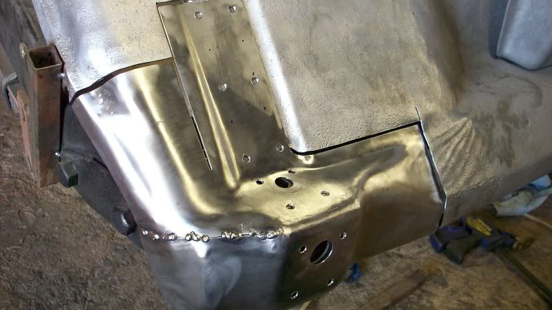

    This ****er was a ***** to fix and I even tried to make it easy on myself by spending $280 on an EMS piece. What a fool I am! Didn't fit on the frame brackets, and was about a 1/4" too narrow, like I was suprised! So whatta ya do? That's right, carve em up and pull a Dr. Frankenstein. He's my hero anyway!
    Tried to keep as much of the original tray as I could. If it's good metal, why cut it out? There's a strip of thicker steel that reenforces the area that bolts to the bracket below:
    Cutting the repop:
    Beginning to fit, you can see where I pounded out the roundy corners in the pocket so it would fit over the bracket. Made sure to weld a piece of square tubing from the frame to the tray on each end, to keep it where it should be. The center section of the tray is also bolted down for stability:
    Had to pie cut the corner to make the pocket 90 degrees, you can see that it's fitting better through the holes:
    14 plug welds attach the reenforcement strip with the tray. Now it's bolted to the bracket:
    Backside almost finished:

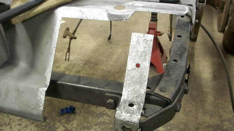

    Onto the right side. I tacked the strip to the frame bracket before I cut out all the rotten **** so it would be exactly where it should be on the bracket:

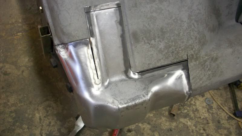

    The repop piece, after catchin' a good beatin'!
    Fitted, tacked, and plug welded to the strip:
    Didn't get any pics of the next part. Used the long, bottom, center section of the repop to replace the pinholed original. Except that like I said, the EMS tray was 1/4" short, so I had to add a small strip to make up for it. Also had to bend the bottom lip around to be more like stock. Wish I had a metal brake, would have bent up a new solid piece, but we make due I guess.
    Can't see it, but also welded the 3/8" fine thread cage nuts back where they belong after chasing the threads. Can't forget the cage nuts!! Here it is almost finished:
    With the coupe back standing straight up, clamped the tray in, fits pretty good!
    You can see that the lip at the top of the tray is still an uneven mess, don't want to cut anything till I fit the tailpan repair piece. That's right!! ANOTHER EMS product! Somebody shoot me! Haha! Looks like the tailpan will fit, seems to be a nice piece and I'm glad someone makes it cause mine is wasted!
    Can't weld it in yet though, got bodywork to do on the coupe back trunk area first. Hafta try to make all the dents as smooth as possible 'cause once it's welded in, thats it! No way to swing a hammer in there.
    This is about all I have for now, started filling in the 4 big spare tire mount holes last week but haven't been to the shop since then. Posting threads is time consuming!!! I'll post those pics when I get 'em smoothed this weekend.
    Stay tuned!!!
