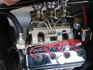

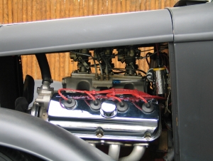

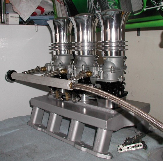

    Hello..Here are some ideas..
    Duane.

  4. Duane, Thanks for the pics. Where did you get the fuel block/manifold for your line?

    Just to nag: no filter as small as the ones shown has enough area not to restrict the carb.
    The mesh/screen ones filter money from your wallet.

    Hello..I bought the hex tub from a supply company and drilled and fit..easy and inexpensive..
    Duane..
