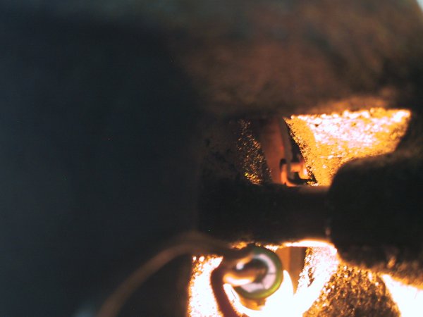

    Sorry so late- There was a hold up on the gaskets. I got the intake gaskets today and yanked the intake. The gaskets looked okay- no noticeable leak I could see. Looking into the heads the intake valves had some crud on them but not anything that would cause the gas not to get to the cylinders. I cleaned the valves of anyway. Attached is 2 pictures looking into the #1 intake runner. First shows that you can see the spark plug with the valve open (little light shoved into the port) and the second is with the plug removed and the light shoved into the spark plug hole. As you can see it opens wide enough.
    Then I rotated each cylinder until the valve was closed and sprayed a bunch of carb cleaner into the port until there was a puddle around the valve. I let that sit for about 5 minutes to see if it leaked out- None of them leaked.
    I also made sure there was no blockage in the intake anywhere.
    So I put it all back together and it runs just the same as it did.
    So I am still chasing the problem. Good compression, valves open fine and no leakage at the valve. means I left wth Fuel and spark again. Why its only effecting one side I dont know but it seems that the heads and cylinders are okay.
