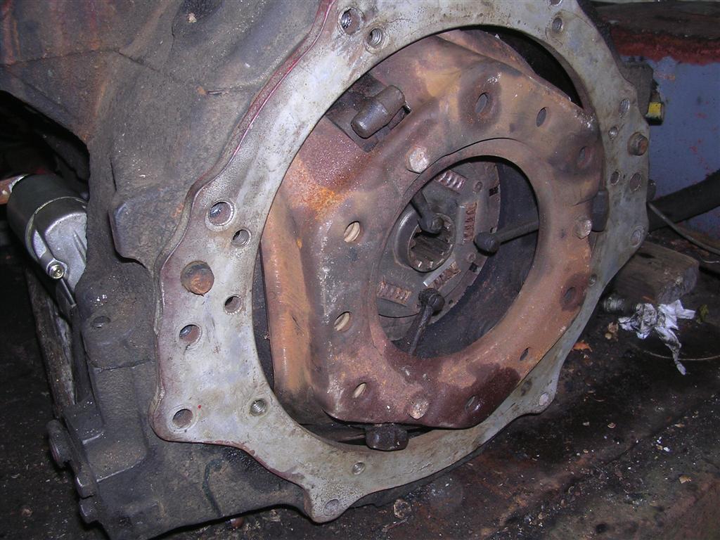

    ... here is my early Olds 303 going into the 40 with stock 40 Ford trans.
    That is a stock early Olds pressure plate. I believe I adjusted the finger screws outwards, but not sure. The disc I found almost new at a swap, and the seller said it was for his Merc..maybe he said 1950 or so.
    The Merc disc, I forgot what diameter, but was bigger than flathead Ford, but not as big as Olds.
    The Olds pressure plate can take discs up to 11"
    The only point of my post, is that if a person can't get a Merc plate and needed to redrill anyways, maybe an Olds plate could be found

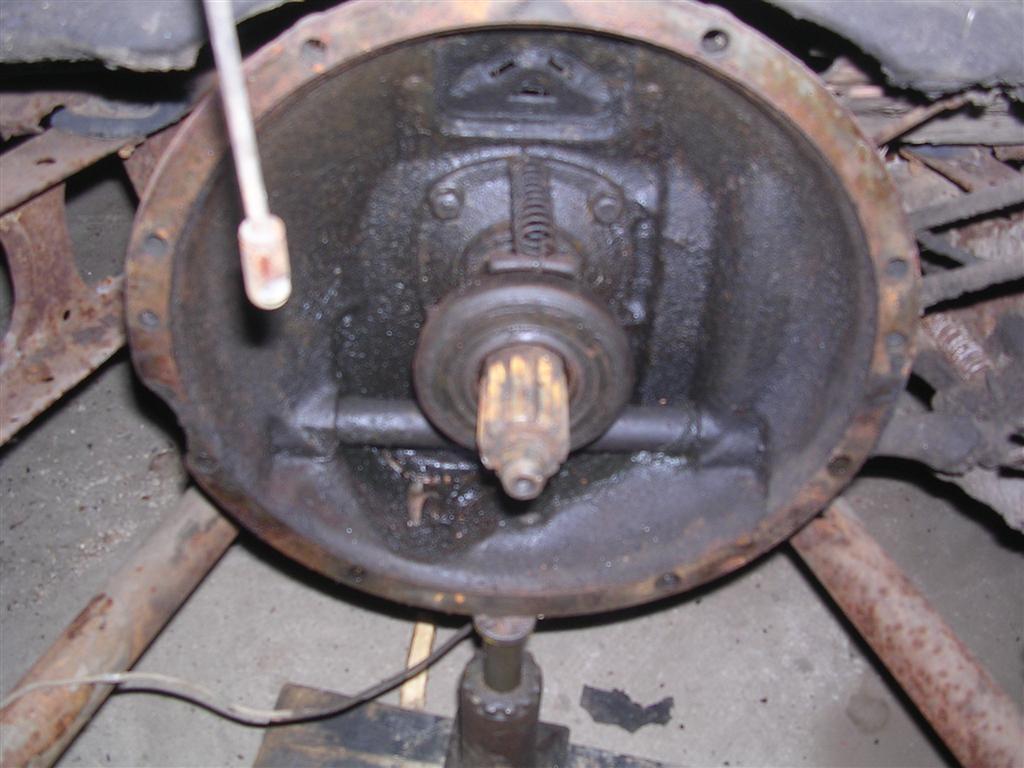

    here's a photo of the TO bearing i have installed right now...
  8. As far as I know there is only one T.O. Bearing for all pre 49 Ford trannys. It measures 3-9/16 O.D.

    Throwouts 1932-48, '49-50 Mercs, 48-52 atleast truck are still the same part. The pressure plate on left that uses an 11" clutch is NOT merc. If it is early Ford, it is something like '35-52 truck...it could also be Cad or Olds, but fingers would be longer for smaller throwout used on Nonfords.
    '49-50 and '51-53 Merc used pressure plates looking like one on right (Ihave not looked at Merc ones recently enough to full ID from Pic), a Borg and Beck, not a Long like the one on right. The two merc plates differ in finger length and quite possibly height. Finger height can only be measured woth plate bolted over a clutch plate on a flyweel. This is drifting all over the place...whatever is what, you need a '49 type pressure plate, 10" disc for early Ford, or your current plate brebuilt with '49 fingers!
