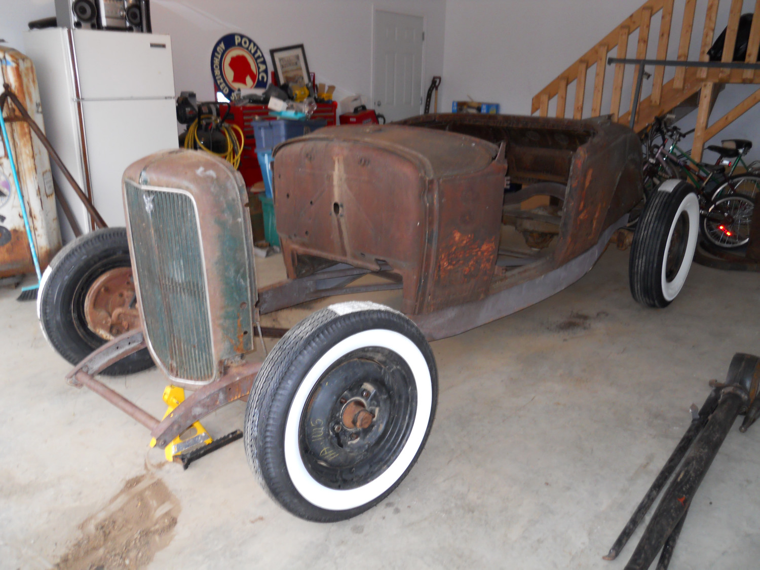

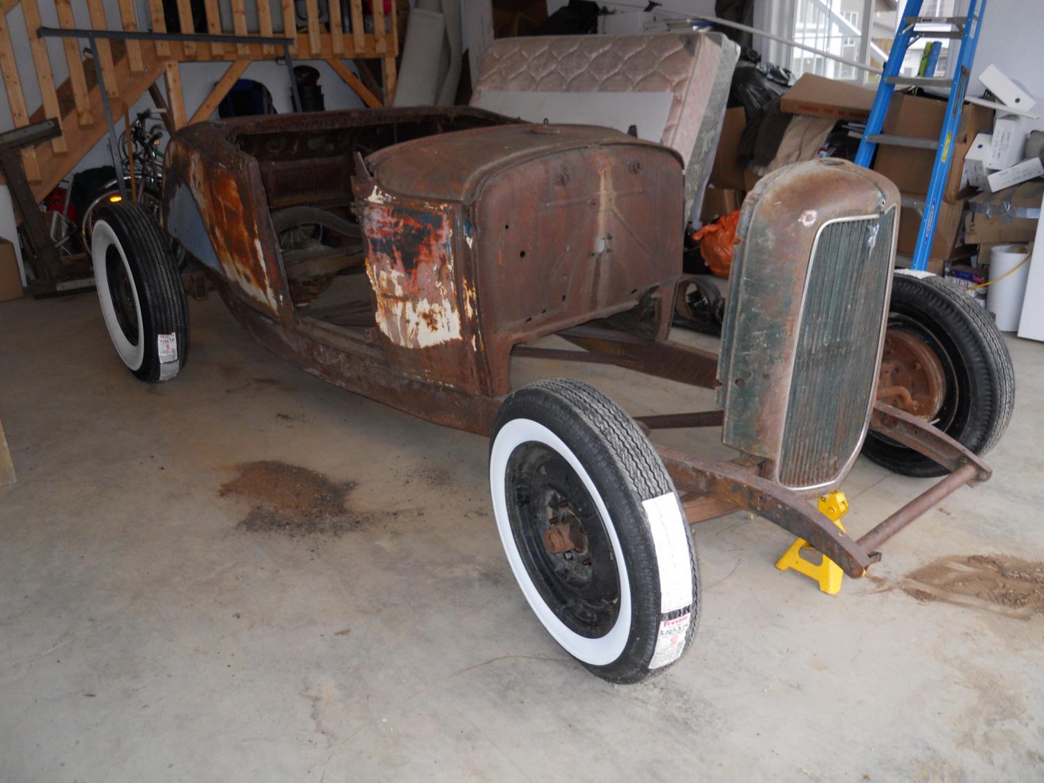

  3. STICKMAN
    Joined: May 9, 2004
    Posts: 134
    STICKMAN
    Couple pics I snapped before I left the shop - hope you can kind of see the rear!
