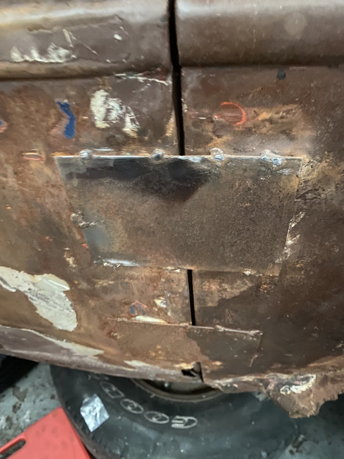

    Hi maybe a silly question
    but whats the best easiest way to remove these welded steel plates on my little hot rod project please? That will do the least damage to the body
    it was like this when i got it, i presume it was done to keep the body safe body/flex for transport at some point in its life
    thanks
  2. If you have one, I would use a small air powered cut off disc and just cut each spot weld one after the other trying not to get it too hot.

    It is only tacked, I would use a cutoff wheel and carefully just go thru the tack welds

    Pretty easy with a thin cutoff disc on a die grinder, a little care needed to keep from cutting into good sheetmetal, just cut about 90% through then knock loose with a thin chisel under the edge of the sheetmetal next to each tack weld, touch up the remainder of the tack with the same disc but don't use the face of the disc unless you change to a thicker one.

    Suggest grinding the part sticking up above the patch plates down to smooth with the plates to help establish a line to "hit' lightly with a cut-off disc & pop the patch plate off so you can smooth off the remaining tack without digging in to the body. edit: I also type WAY TOO Slow... LOL

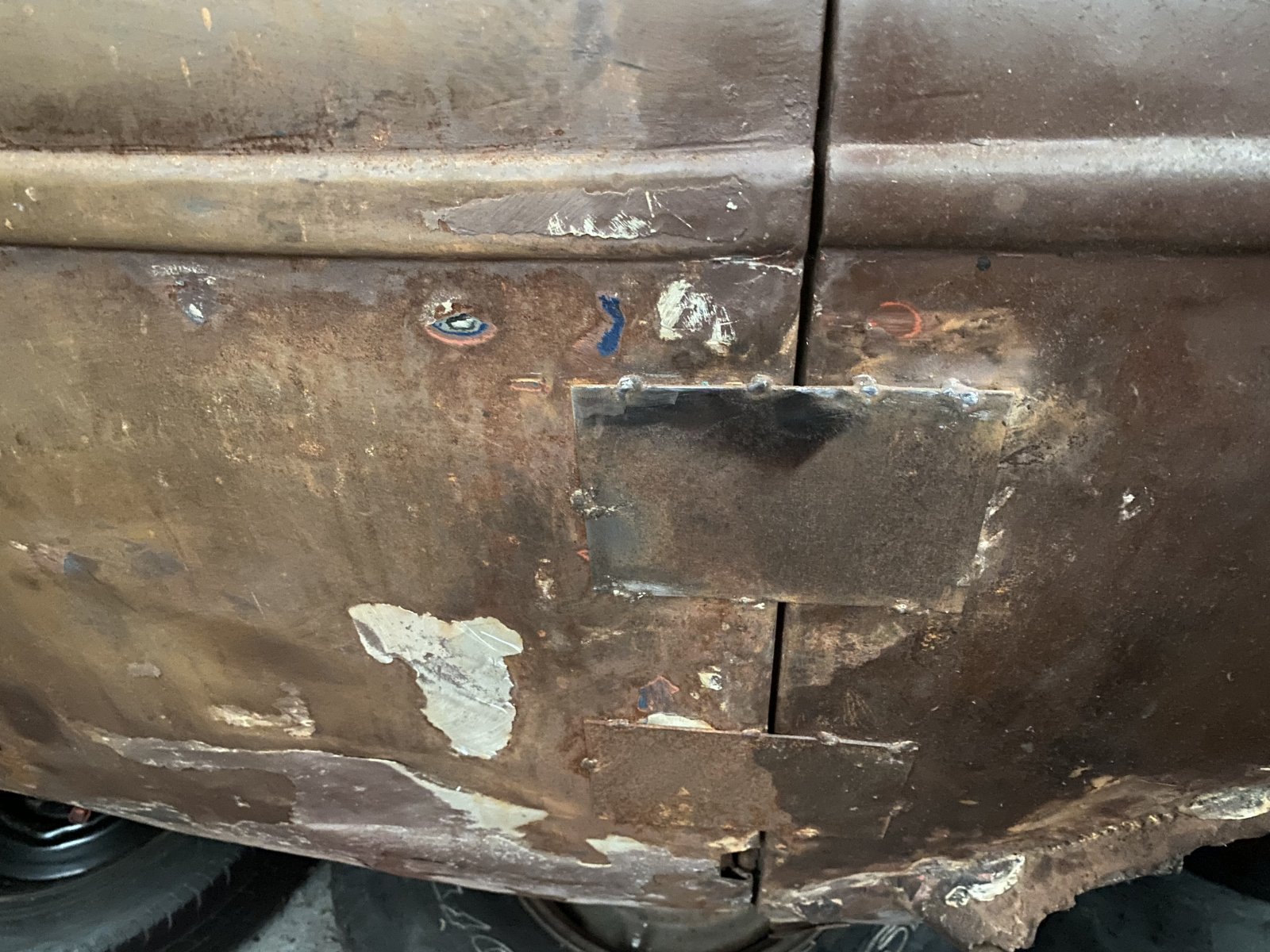

    Those patches look like the way a buddy of mine used to get panels to fit when he was welding a panel on or even fitting door gaps.
    I agree that the gentle use of a cut disk is the way to take them off.
