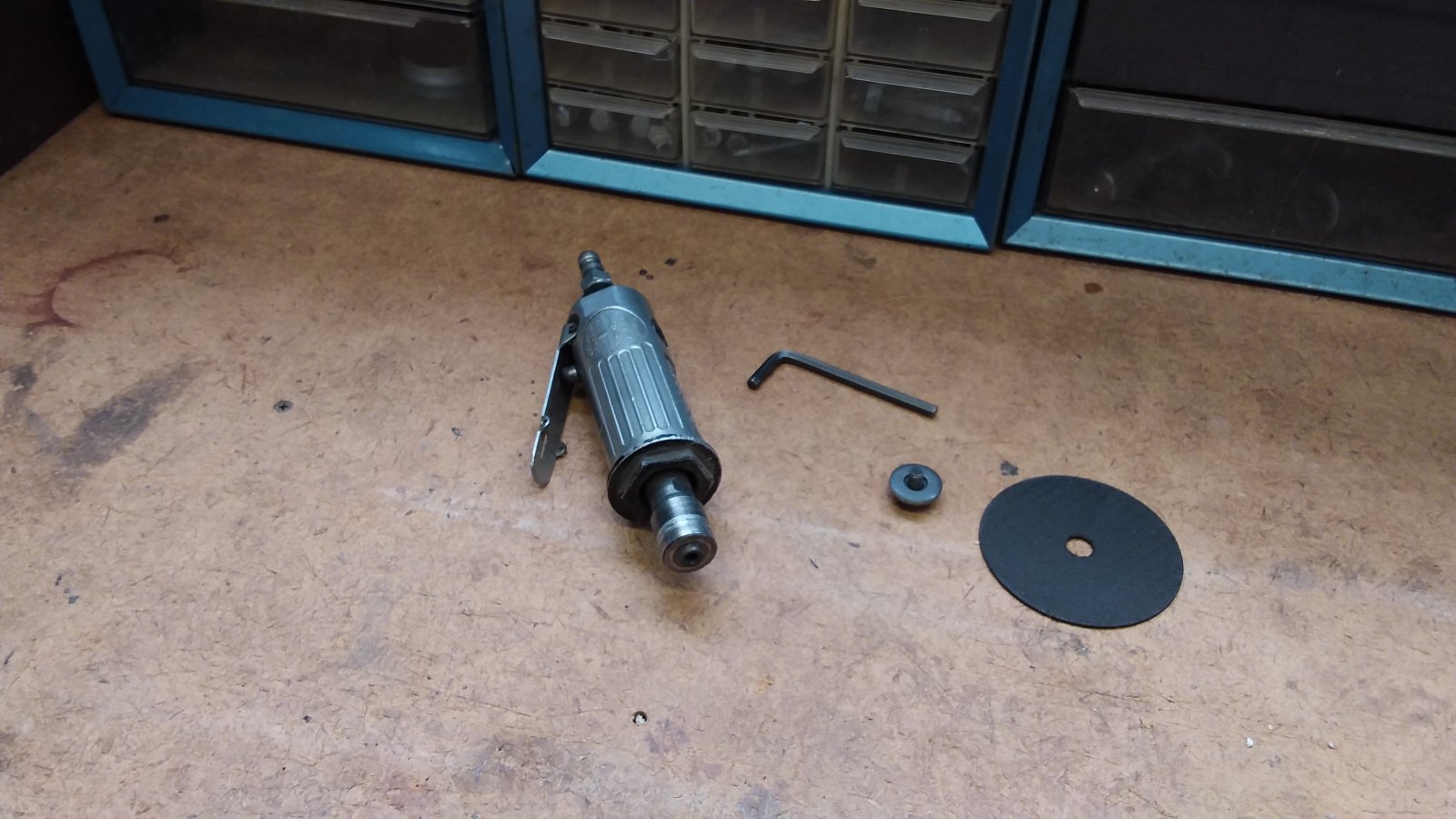

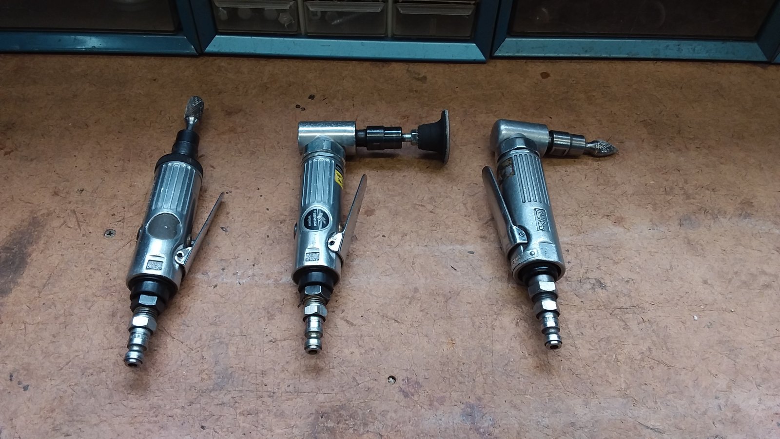

    With this style grinder not having the capability of holding an arbor or shanked cutters, the one bad thing about these is that they can't really be used for much else other than light grinding (with thicker discs).
    The good thing is it gives you an excuse to buy more grinders!
    X-cpe and Budget36 like this.
  2. Budget36
    Joined: Nov 29, 2014
    Posts: 15,303
    Budget36
    I see now. My cut off wheels are like that too, uses a socket head bolt to hold the wheel in place.
    Took me a bit to catch on;)
