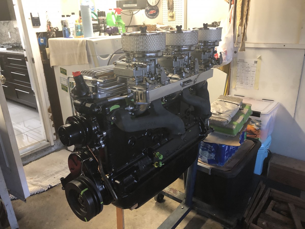

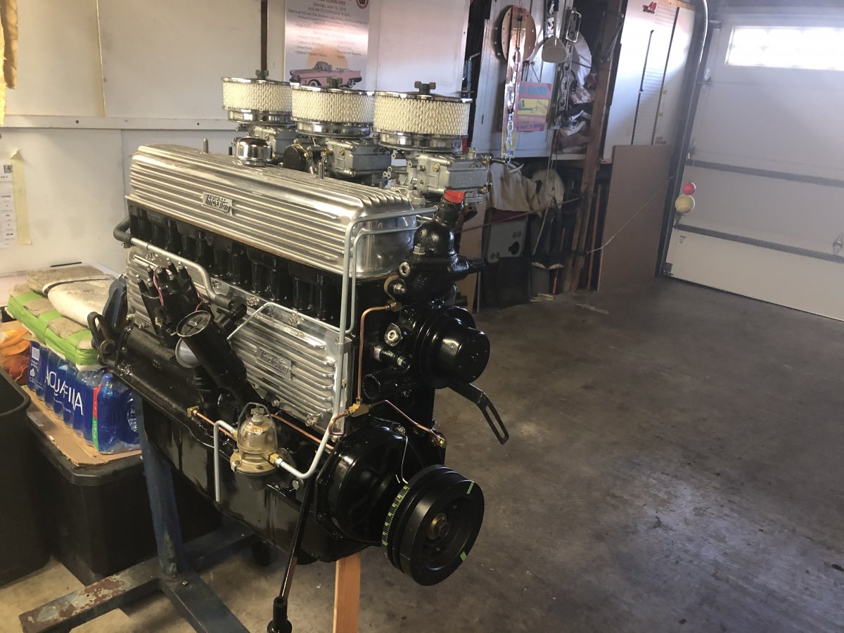

    You made me curious as I have a complete assembled engine on a stand. It took #40 to turn the crank off dead stop and #30 to keep turning it. No spark plugs and only assembly lube on the bearings, rocker tips, and push rods. There is no oil in the engine yet and it will be primed before starting. C4567605-0A2B-4C96-989A-71C7411FA413.jpeg CFD68DF3-6B8C-4A84-805F-DE536B281610.jpeg
    oliver westlund, loudbang and egads like this.

  26. Jimmy six,,,that is an excellent looking engine.
    Now,,,your torque readings are with it completely assembled and pushrods in also,,right ?
    What about rear main,,,rope,,,,that is not bad for a completely assembled engine.
