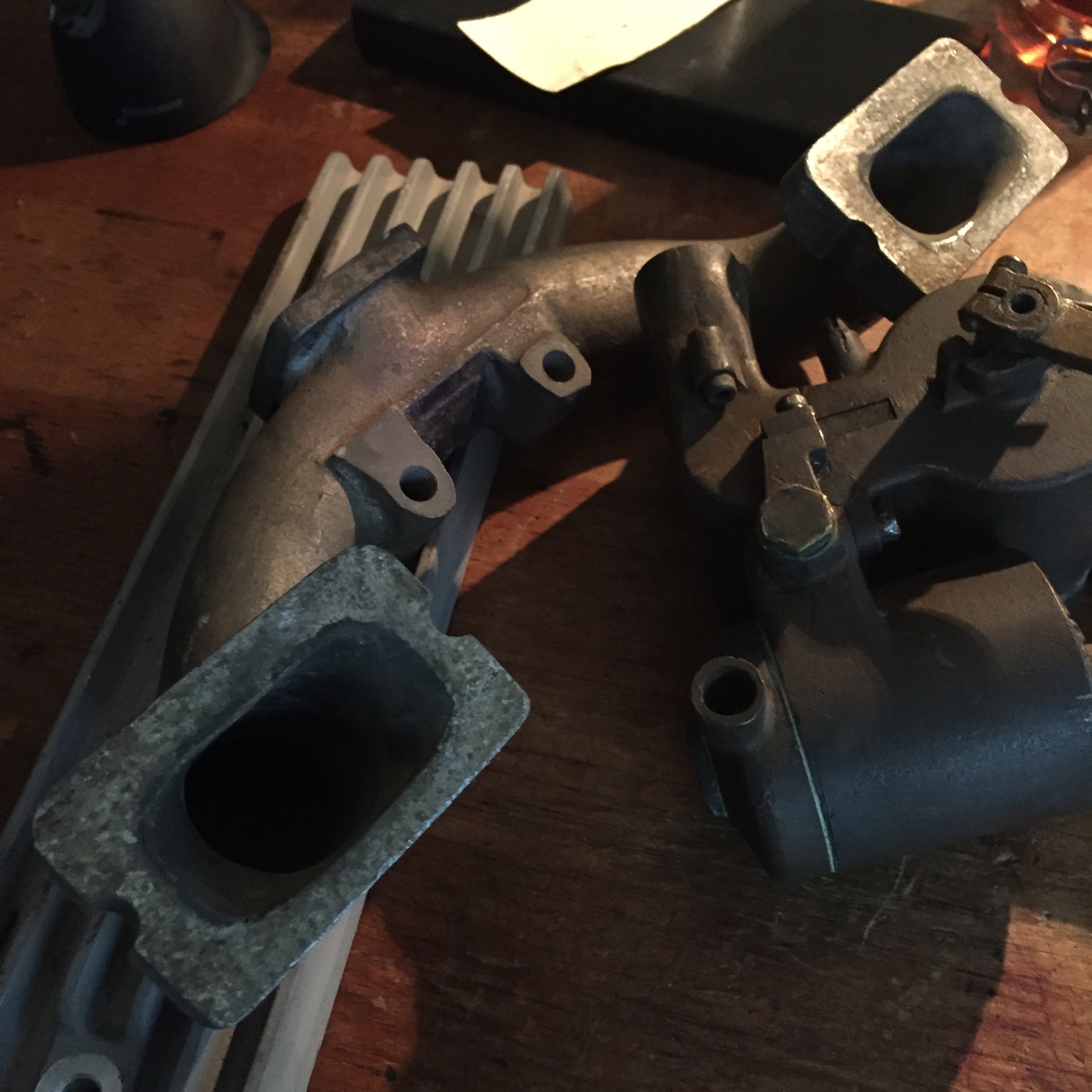

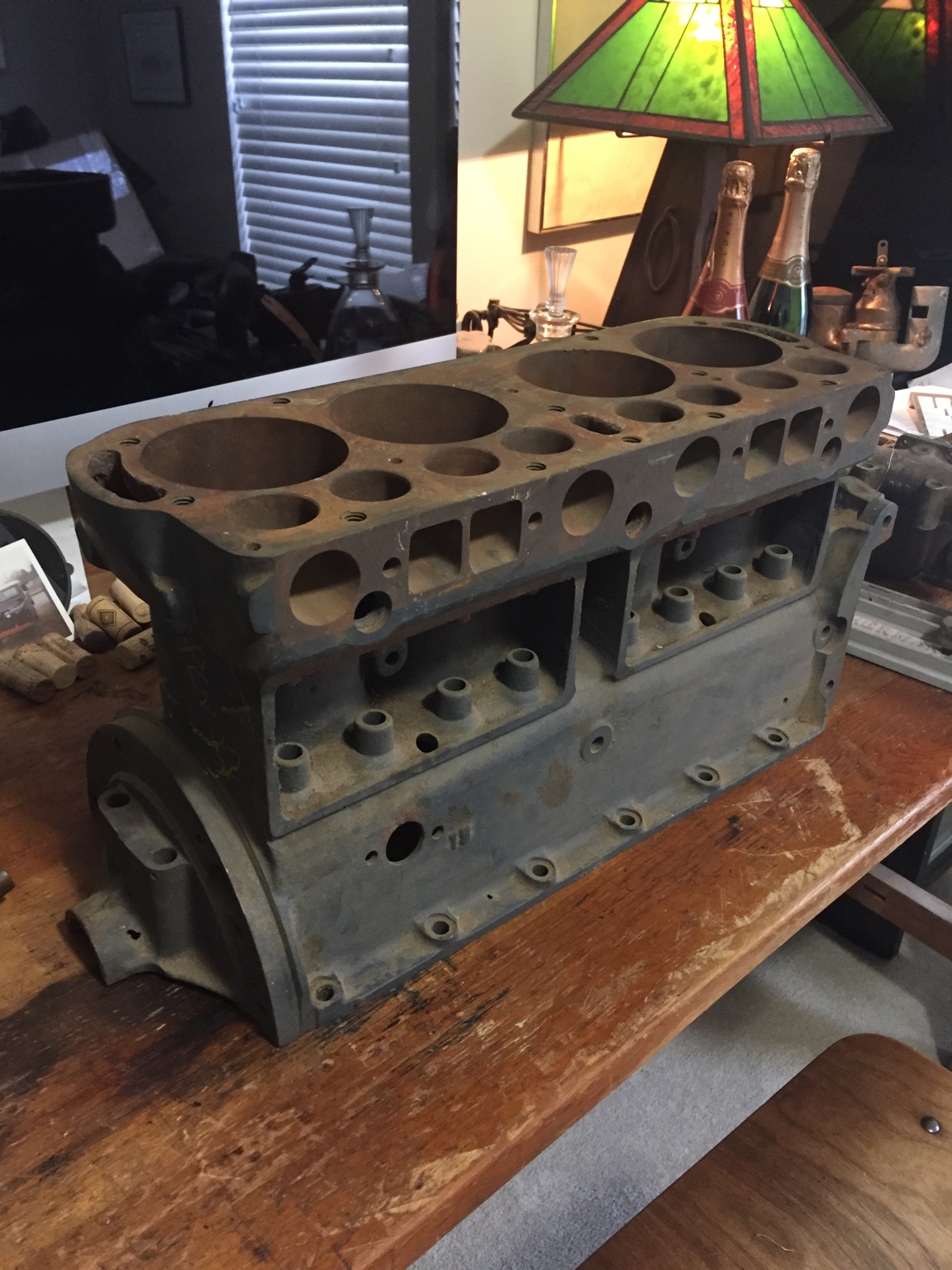

  1. Local Craigslist score, thought it was model t, but not sure?[​IMG]

    Model T had all round ports on side.

    Lot of ports. Is it welded?

    Let's see the other side....????
  5. R Pope
    Joined: Jan 23, 2006
    Posts: 3,309
    R Pope
    8 ports, not a Ford. Plymouth?
  6. RichFox
    Joined: Dec 3, 2006
    Posts: 10,020
    RichFox
    Not a plymouth or a Dodge
  7. What's the bore & stroke ? Nice porting, but the crank looks kind of flimsy,,,:(
    Might check with the guys at "SMOKSTAK.com.
    More pic's,,is that a carb with it ?

  8. studebakerjoe
    Joined: Jul 7, 2015
    Posts: 1,182
    studebakerjoe
    I'd say modified t block with shortened a crank in it. If you check out the mtfca forum you'll see other t blocks modified that way. Ed Winfields 2 up 2 down had similar ports.

    Joined: Mar 11, 2005
    Posts: 11,360
    BJR
    In looking at pictures of model T's on the net your block looks like a T except for the rectangular ports, as all the T's are round. But the T's have the same half moon water p***ages on each end of the block like yours. Now I would say you have a modified T block.

  11. Pete Eastwood
    Joined: Jul 27, 2011
    Posts: 1,328
    Pete Eastwood
    from california
    It's a model T, it has two valve doors & provision for a generator so that makes it around a 1919.
    It's been highly modified / ports / valve size. The crank is a model A, a popular conversion to put in a T block.
  12. Leave it to Mr. Eastwood to spoil the fun! ;)
    The block was done by the late Jerry Sherman. Pretty stoked to get such a cool bit of socal speed history. Will have my work cut out dealing with the main caps and bolts though. Thoughts?
    mike in tucson and kiwijeff like this.
  13. I think they are brazed in. Will have to clean it up to find out.
  14. Pete Eastwood
    Posts: 1,328
    Pete Eastwood
    from california
    Dan McEachern makes nice main caps for the A crank conversion, I have them in one of my engines.
    He also make other stuff for T's, timing gears, safety hubs & more.
