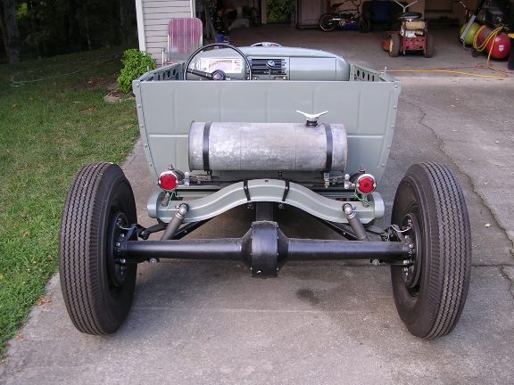

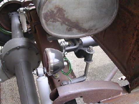

    It's the only way to do a modified, IMHO.
    It works just as good as the original config, but you will need to swap the axle housings side to side, and move the crossmember forward about four inches.
  6. I swapped the axle housings side to side (be sure to replace the outer grease seals while it's apart), put the crossmember where I wanted it, & went to welding. Had to make my own upper & lower shock mounts. Shocks were '70 Chevy PU 2wd front shocks.
    It's hard to beat a bare banjo out back.
    Let us know if you have questions.
    JH

    Excellant pictures! Why does the rear end get swapped end to end? This is close to the set up I would like to put together on my project. Is the swap done if you are using the factory brackets and wishbone?
