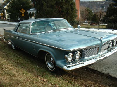

    So.. any suggestions gals/guys? Here is a picture of the car for some eye candy..

  23. Tinyelvis.....great looking beast!!
