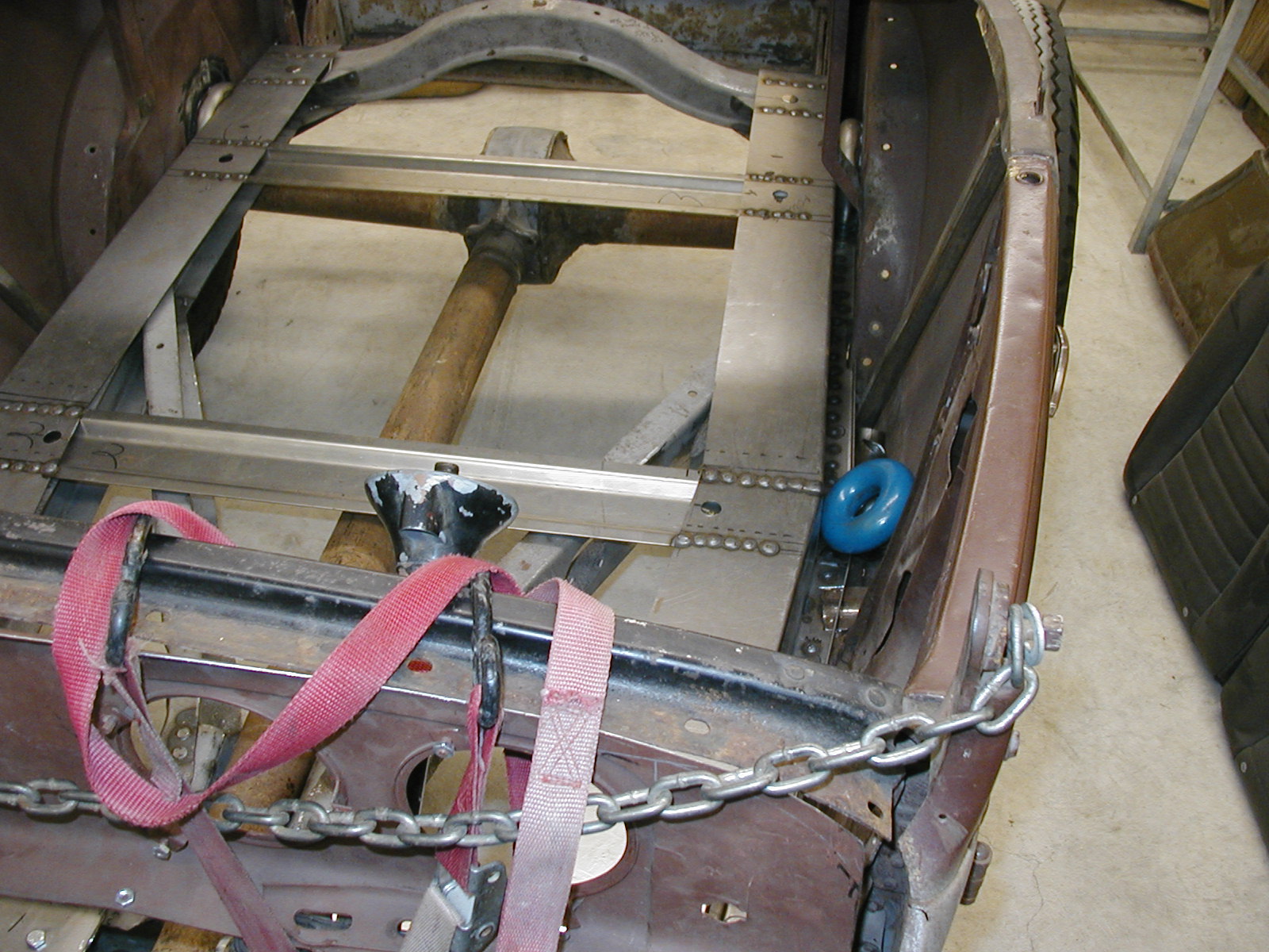

  4. I have done this project more than once. A few years back I posted several photos of doing my 30 Roadster. Like you I can't even find mt old post on this new system. Also I type with only 2 fingers but I'll try to help out some anyway. I tend to do things totally different than most and often hear " Why didn't I think of that?". I just live by K.I.S.S. If you have a solid and good fitting Coupe to start with do not start your project by cutting out the floor and sub rails. Work on top of what you have then cut out the old. That way you won't fight realignment. You should still do some bracing but leave it bolted to the frame. This Roadster got channeled 4". Here are a few construction photos. Rather try to explain it all step by step. Ask me some questions. Less typing for me and in shorter time.
    The Wizzard
    Holly Crap!! Where did the manage your account go so I can attach photo's? Upload a file don't give any options. Just says no file selected. W.T.F?
  5. Thought I'd try this photo post again. Got the 12 year old neighbor kid to help me.
    The Wizzard
    30 roadster floorboards 001.jpg 30 roadster floorboards 002.jpg 30 roadster floorboards 003.jpg 30 roadster floorboards 007.jpg

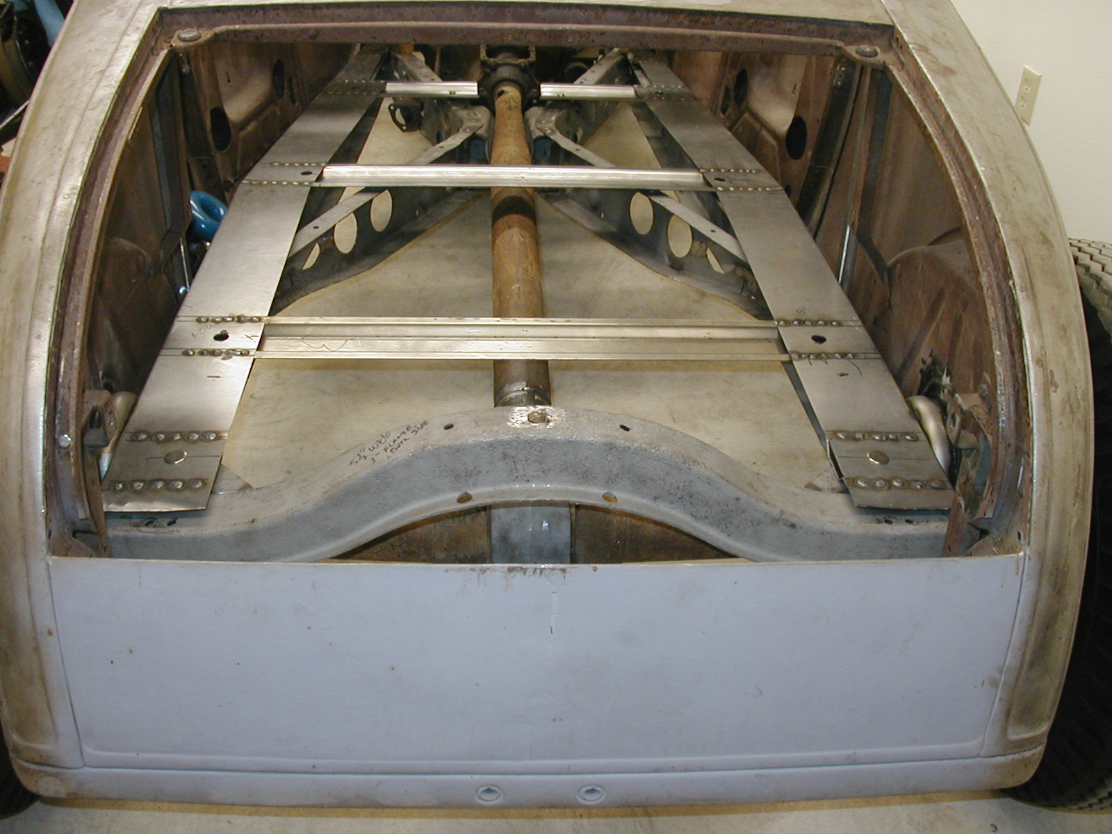

  8. Take this into consideration. How much trunk space do you want? My Roadster is Flathead and closed drive. My first chassis was Z'd 4" and Channeled 4". That put the trunk floor above the bottom edge of the deck lid. That didn't work for me. I built a new chassis using a 36 rear axle and got back 4" of trunk space. It just ment streching the frame to move the crossmember back for the spring. I'll see if I can get some photo's of that up in a bit.
    The Wizzard
  9. Here's some photos. First is Banger power with 4" Channel and 4" Z. Next is 4" channel and 4" Z inside the trunk opening. Notice how far up the side brace is for the floor. Next ones are of the flat floor. I like it a lot better.
