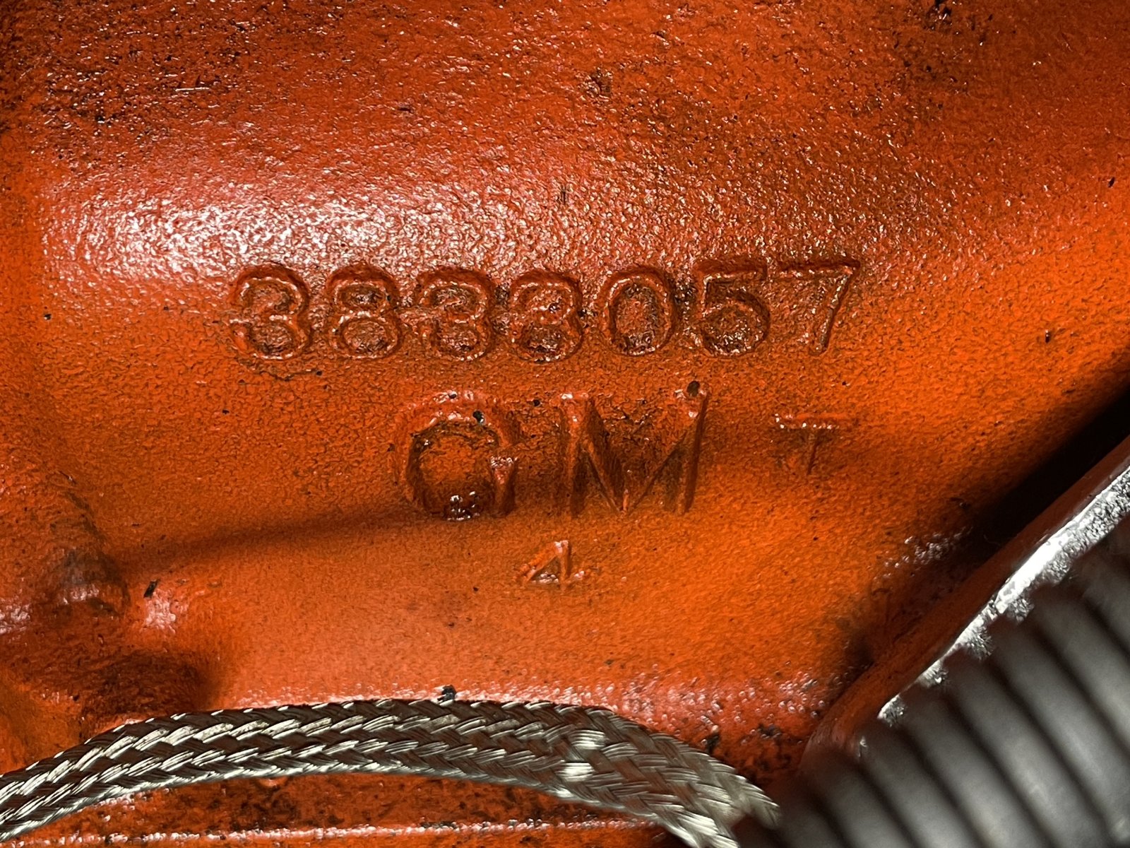

    Block casting number is 3833057 which my research showed to be a 194. However the seller told me it was a 230 ( I know, not a big difference, but I’d like to confirm).

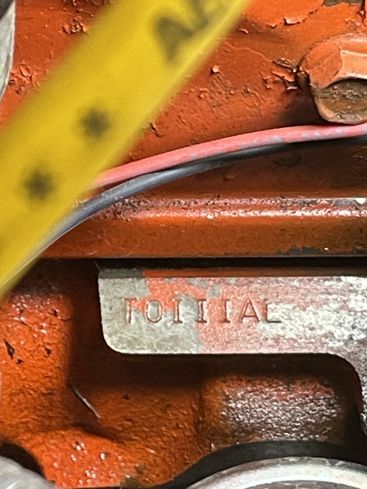

    The distributor stamped “number” is the one that’s really odd: TOIIIAL Can’t find that one anywhere.

    AL was used in Chevelles, in 1965-66, it's a 194.
    finding the casting date code near the starter could confirm the year. look for something like A 3 5 and report back

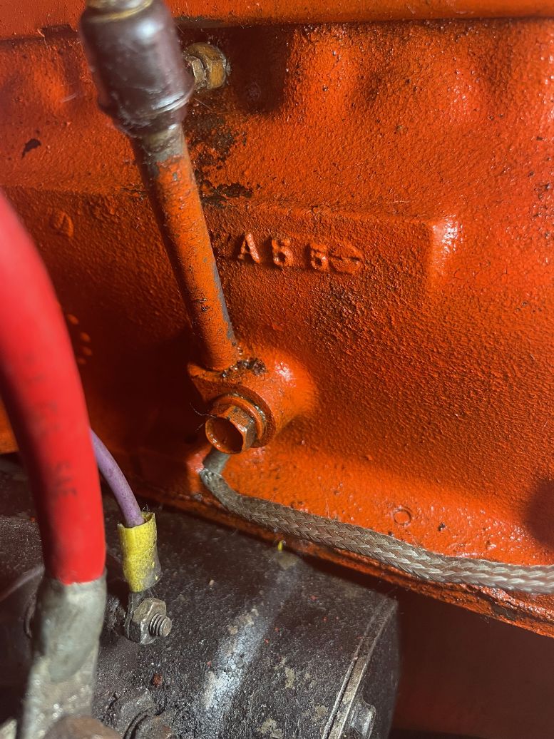

    Got the block casting number from above the starter. Looks to be A 55 . squirrel, hope this helps. right side engine block 1.jpg

  5. squirrel
    Joined: Sep 23, 2004
    Posts: 59,931
    squirrel
    yup, block cast Jan 5th, 1965. The ***embly date in the stamping is 0111 which is Jan 11th, 1965.
    Now you know what your engine is from, and that folks don't always know what they have, or don't always tell you what they have.
