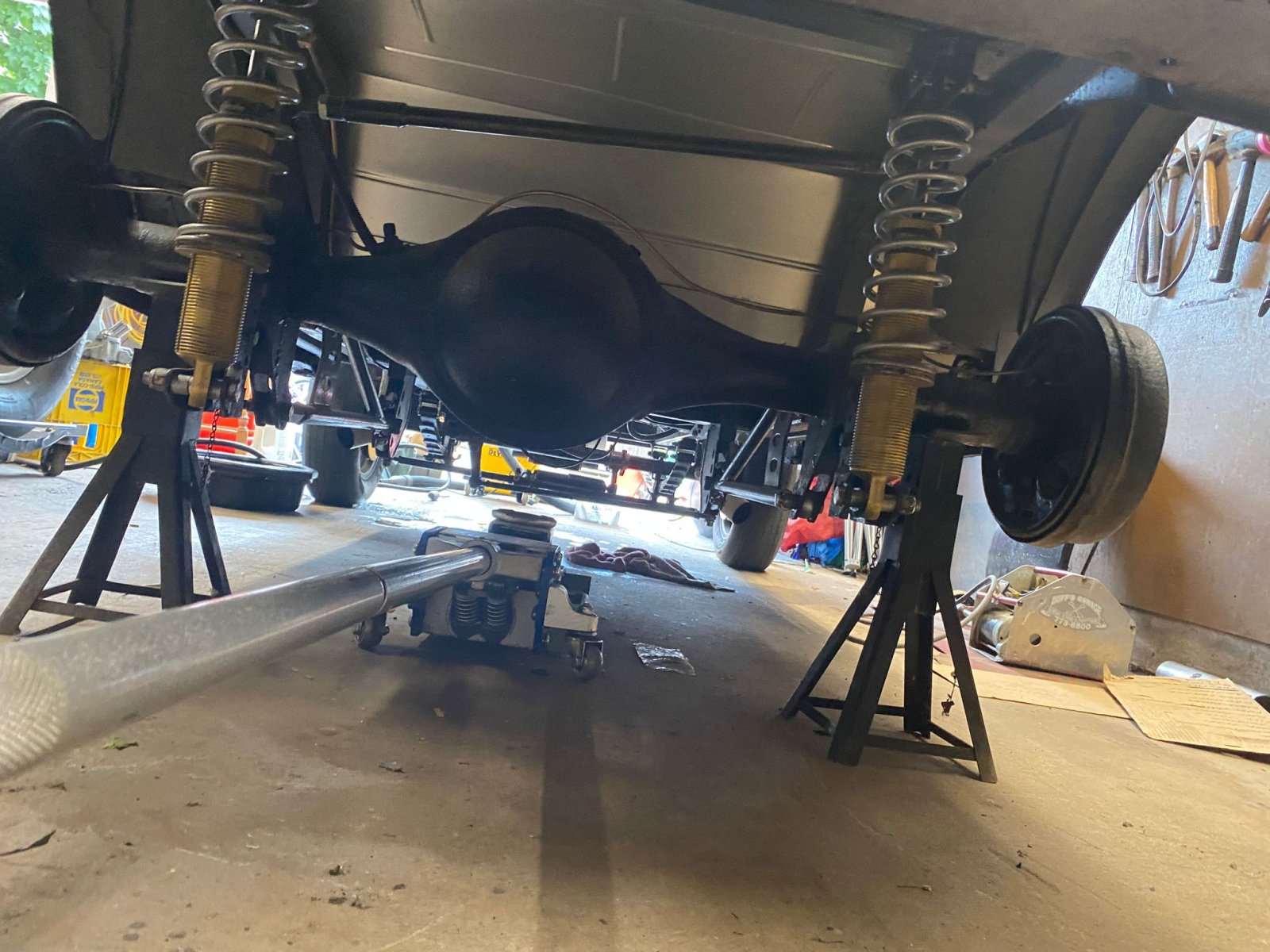

    I’m helping my friend sort out his drag car and it has a suspension issue we haven’t seen before.
    Hopping someone here can help.
    It’s a short wheelbase gasser built from a Hillman Husky on a custom ladder frame.
    The rear suspension is ladder bars with a panhard bar and coil overs.
    The best way to describe the problem is that it feels like it’s leaning side to side at speed.
    Like a metronome or upside down pendulum.
    The faster you go the worse it gets.
    I’m a body guy, not a suspension guy.
    Appreciate any suggestions!

    Post some pictures, though, so we can see what we're talking about. Or several more thousand words describing the car.

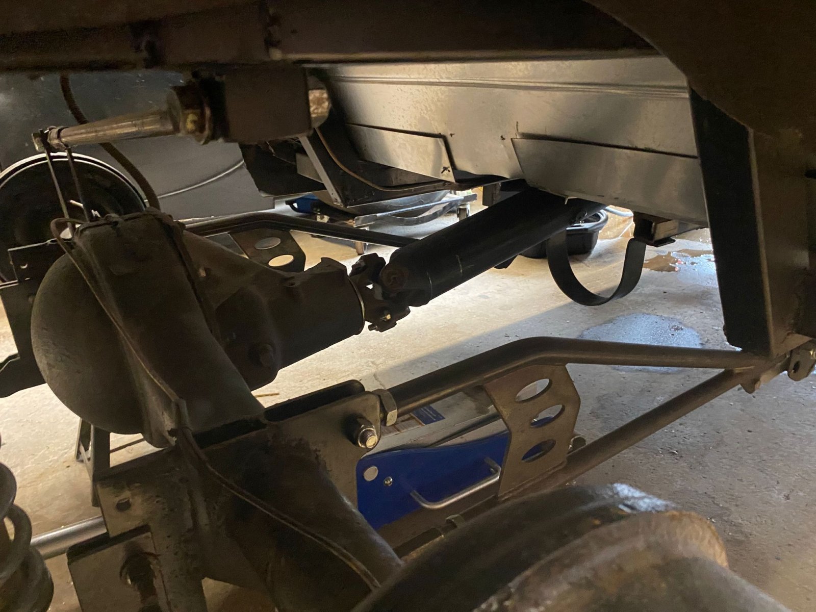

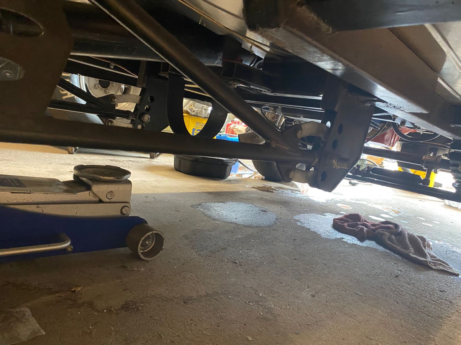

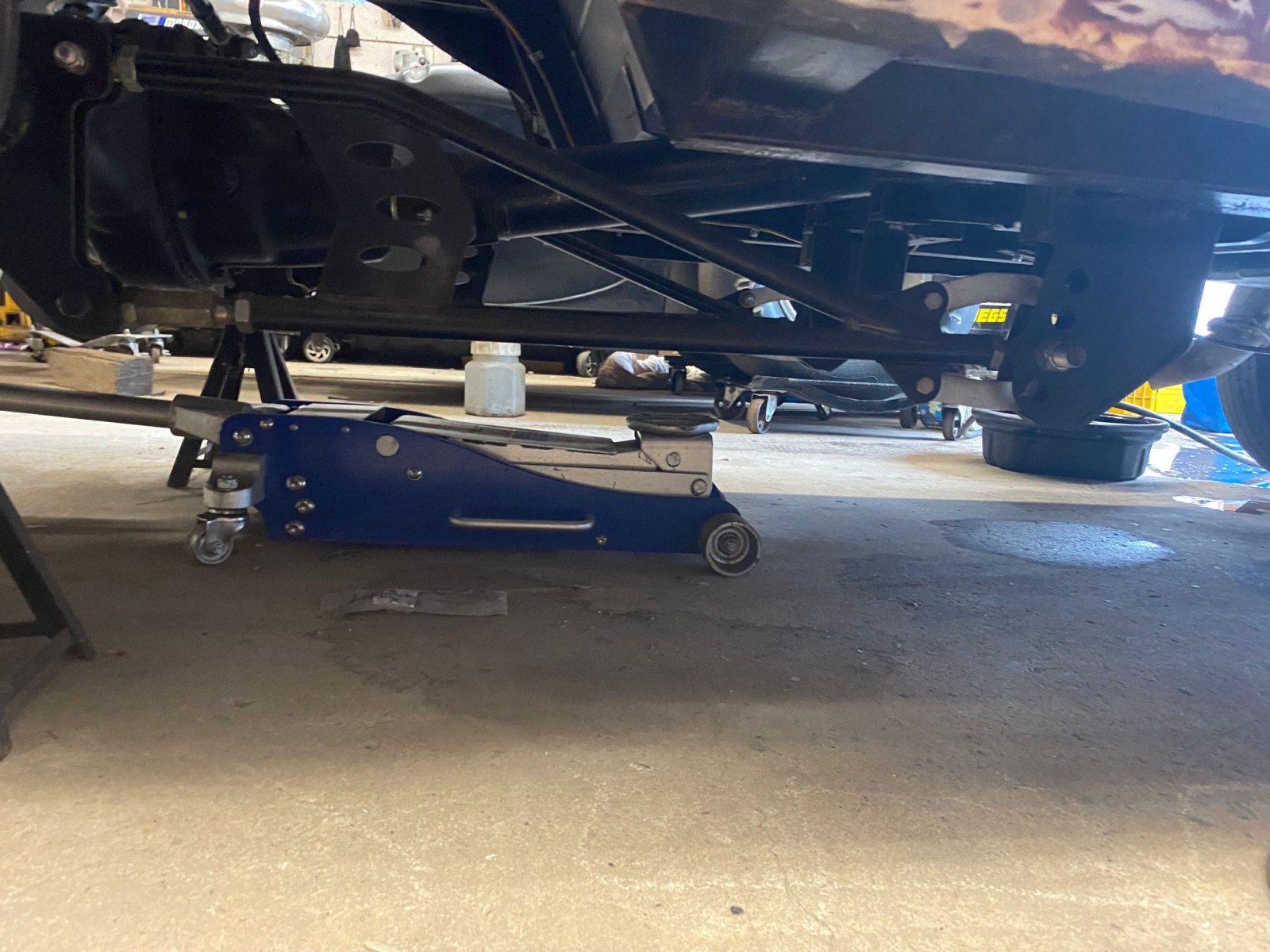

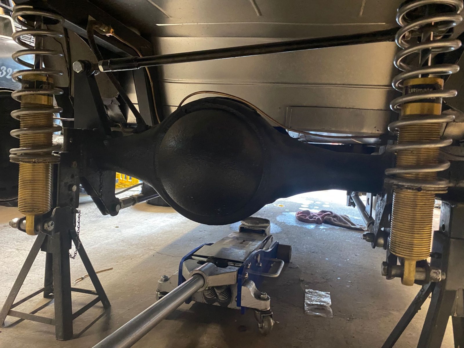

    fc2b5f11-c0dc-406b-8f10-1cf91476d6ad.jpeg 437ac4eb-4c9b-42f1-8501-caabe4c2f8e0.jpeg 380eeb4a-5f21-4019-998d-2075a0a492c2.jpeg 96334e34-228e-4374-b600-51a1aeb153a4.jpeg 8e6891d2-a696-4842-9578-500804edb3a0.jpeg 7c8a3455-4ac2-45c0-8ebd-79ea60753cbc.jpeg 2e15a97d-f529-479a-85c3-d151dd7ccf6a.jpeg fc2b5f11-c0dc-406b-8f10-1cf91476d6ad.jpeg fc2b5f11-c0dc-406b-8f10-1cf91476d6ad.jpeg 437ac4eb-4c9b-42f1-8501-caabe4c2f8e0.jpeg 380eeb4a-5f21-4019-998d-2075a0a492c2.jpeg 96334e34-228e-4374-b600-51a1aeb153a4.jpeg 8e6891d2-a696-4842-9578-500804edb3a0.jpeg 7c8a3455-4ac2-45c0-8ebd-79ea60753cbc.jpeg 2e15a97d-f529-479a-85c3-d151dd7ccf6a.jpeg 437ac4eb-4c9b-42f1-8501-caabe4c2f8e0.jpeg 380eeb4a-5f21-4019-998d-2075a0a492c2.jpeg fc2b5f11-c0dc-406b-8f10-1cf91476d6ad.jpeg 437ac4eb-4c9b-42f1-8501-caabe4c2f8e0.jpeg 380eeb4a-5f21-4019-998d-2075a0a492c2.jpeg 96334e34-228e-4374-b600-51a1aeb153a4.jpeg 8e6891d2-a696-4842-9578-500804edb3a0.jpeg 7c8a3455-4ac2-45c0-8ebd-79ea60753cbc.jpeg 2e15a97d-f529-479a-85c3-d151dd7ccf6a.jpeg Here are some pics of the rear suspension.
    I had nothing to do with this part of the build.
    We’re going to look at the tires and wheels but these tires and wheels were on another car that ran straight and true.
    We were going to try more air at test and tune last night but ran out of time.
    I’m also going to check for a bent axle.

    The first thing I'd do is box the transverse bracket! I wonder if it's flexing under load.

    Something looks funny to me with that panhard bar. Try jacking up the rr of the axle ( simulating it being loaded) and see what the other side does. Maybe just a bunch more preload on the rr?

    That panhard isn't enough, stops only 1 force, side to side. As high as that mount gig is on the left I'm surprised it hasn't broke yet. Not boxed at all. Interesting. Car needs a diagonal link from the left front rod end to right rear lower adjuster. This will effectively stop the ladder bars from articulating independently.
    I'm surprised nobody else caught that, sorta...

    There's no way that those panhard mounts on the rear end aren't flexing as tall as they are imo, I agree with you that they should've already broken.

    The pan bar needs to be addressed especially the way it's mounted
    Size , angle , length,& bracing the way its set up Now !
    The Forward mounts for ladder bars,
    Needs more bracing & side to side bracing , ( for how long mounts hang down )

    The Pan Bar Should be Horizontal @ ride Height,
    Or Add Trac Locater,
    better/ stable then Pan bar on
    Coil over Ladder bar set up !

    I agree that the frame and diff brackets should be boxed.
    And the frame brackets should have a brace from the bracket to the frame on the inside. Triangulated so to speek to keep them from bending.
    May even need to triangulate the diff housing brackets also, if they bend.

    We found a seriously bent rim.
    That is probably the main source of the issue we we were trying to solve,
    However, I’m glad looking for problems caused us to identify the other issues that need to be addressed such as boxing mounts.
    Thanks for all the advice and suggestions!
