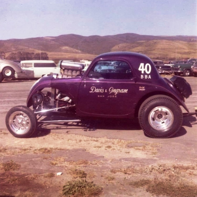

    Well, first off I don't even know what kind of car it is. lol Is this a doorslammer?:) 1964 (by Pete Jensen).jpg
  6. Marty Strode
    Joined: Apr 28, 2011
    Posts: 9,680
    Marty Strode
    It certainly was after it got the shortened 64 Mustang body installed, and was named Colt 45.
    lippy likes this.
