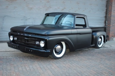

    You can actually buff it to a sheen, or wipe it down with Pledge. Here's a pic of a friends coupe that was buffed. parts for sale 043.JPG
