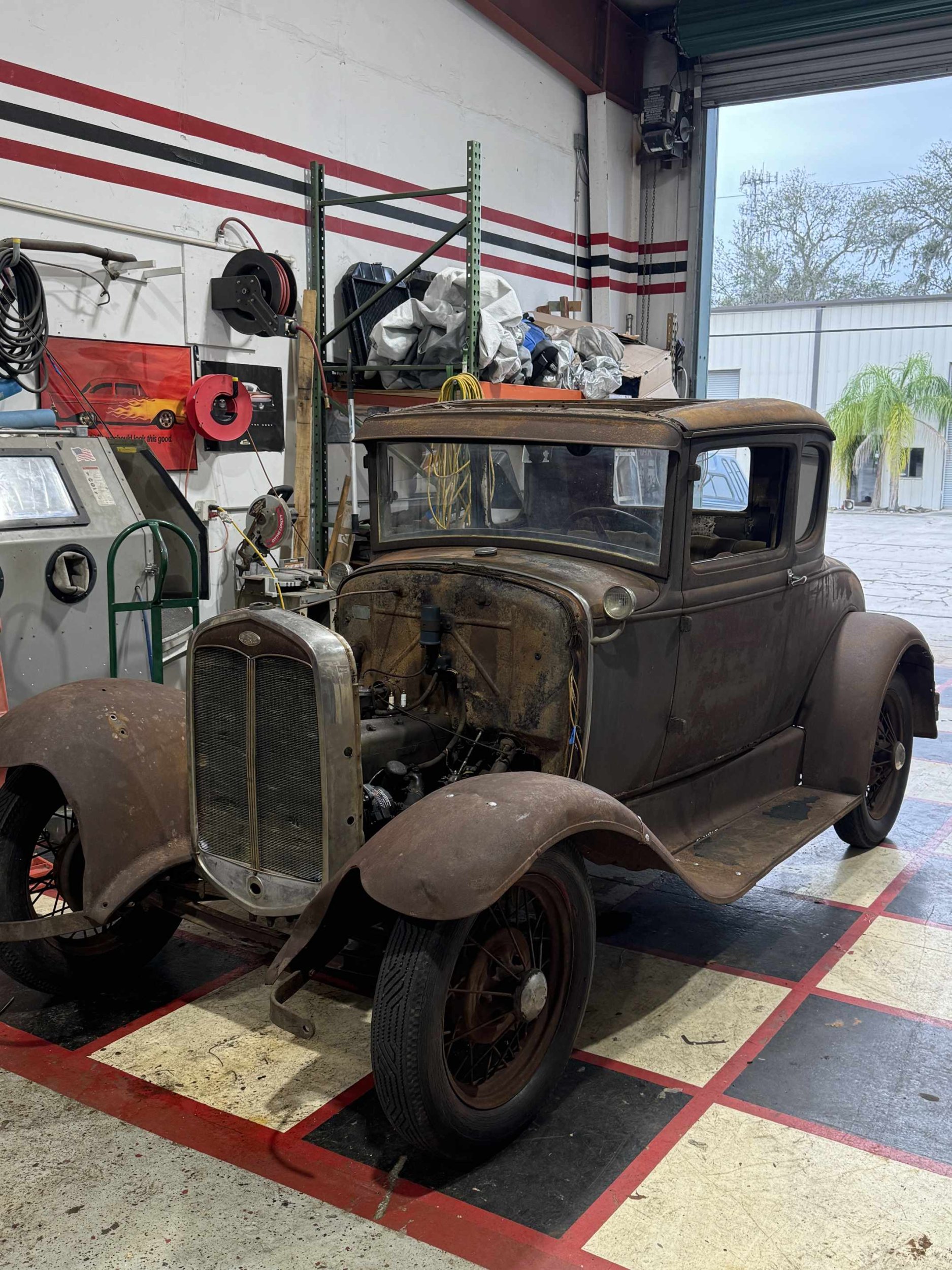

    Hi everyone,
    I just finished watching the 2024 T.R.O.G. on YouTube, and I’m fired up! I've got a '31 A jalopy coupe that's gonna fit right in there come October 2025 IMG_8334B.jpg . It’s got that rustic, no-paint look, and it's rocking an original refurbished 4-banger with Babbitt rods and mains. I'm looking to soup it up for the drags but need some help finding parts.
    So far, I’ve tracked down a used Weber carburetor with an intake manifold and picked up an FSI kit to convert my distributor to centrifugal advance and electronic points. I know I can't go too radical, but I’m on the hunt for a used 6:1 head, a high-lift cam, and anything else you gearheads can suggest. I’d also love a transmission with better ratios for 1st gear and maybe synchromesh.
    Any suggestions on what I’ll need to qualify for the drags and recommendations for parts are greatly appreciated. Finding used speed parts has been a bit of a challenge.
    Thanks in advance for the help!

    All good advice. I ran this year and it was one of the best car-related events I've been involved with.
    Take a look at the TROG website. The rules are listed. You may get declined with the Weber set up. A Stromberg would not be a problem.
    Good luck. It's certainly worth it.

    Good advice from the folks here. I can tell you that using the early Ford V8 transmission (32-39 types) is apparently okay with the TROG group as we’ve built several for guys running in the race. The 32-39 transmissions will fit with the right adapter and all are synchronized into 2nd and high gear. The 39 version had the latest version synchro which was the best. Check with the other racers but I think they found that they had the best experience running on the sand by starting out in 2nd gear instead of 1st gear. Model A rear end gears were generally around 4.11 so they could start in 2nd no problem.

    Making it lighter is free horsepower gain
    may want to loose the fenders and any other unnecessary items
    Good luck

    100%. My first run, I started in 1st and the car was squirrely the entire run. Almost lost it getting sideways 1/2 way down the course. After that, dropped air pressure to 10 psi and started out in 2nd for the rest of my runs.
    Since OP has a coupe, I don't think he'll need a roll bar. He will need a five point harness and a way to mount it securely.

    Check the rules.They might not let you run a weber or electronic distributor. They used to be pretty strict. I tried to run my Model A and they told me i couldn't run an alternator.

    Weber would not make the cut for sure

    Probably need to loose the fenders and headlights , remember it has to look modified.

    IIRC, they don't allow stock Model A wheels.

    You’re gonna need to strip that car of its fenders and lights. I doubt that Weber setup will fly. Pretty sure model A wheels are a no no too but you’ll have to look that up. Go on the website and you’ll see the rules. It isn’t complicated. It’s a fun time.

    I greatly appreciate all the advice that everyone gave me. Only thing is, the question I asked about anyone having used speed parts was not answered by anyone. Without these parts and the shedding of some I already have, I want stand a chance. You can look at my ride and tell new will not go very well and the hunt is much more fun.
