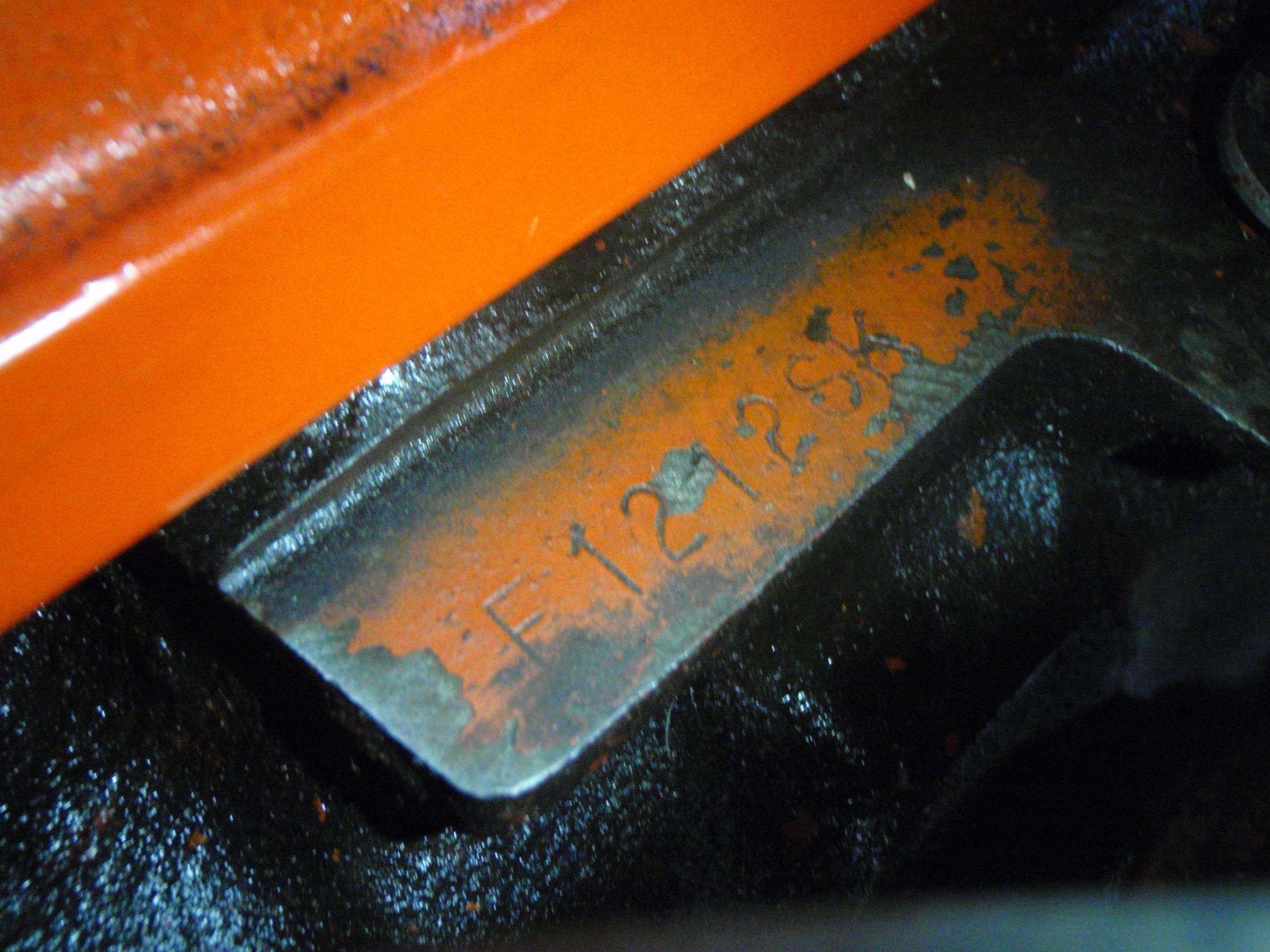

  19. Loppy
    Joined: Oct 22, 2007
    Posts: 422
    Loppy
    The stamped serial code next to the distributor is F1212SK.
    Haven't found what the S and K mean. This is what I dug up on it so far. Please correct if wrong, and fill in the missing blanks.
    F = Flint manufacturing plant
    12 = December, month of manufacturing
    12 = 12th day, day of manufacturing
    S = ???
    K = ???
    1Nimrod likes this.

  22. Snarl
    Joined: Feb 16, 2007
    Posts: 1,639
    Snarl
    According to my Hollander interchange manual,
    SK is a 1966 or '67 Chevy truck 230 with manual transmission, or a '67 GMC 230 with manual transmission.
    1Nimrod likes this.
  23. Snarl
    Posts: 1,639
    Snarl
    Read the first site again CAREFULLY... the F, S & K that they talk about are in reference to the first letter, not the last letters...
    F for FLINT is what you have.... the SK has nothing to do with location as they are not the first letter in the code. understand?
    1Nimrod likes this.
  24. Yeah, the SK is the motor ID code. Sometimes Motors and Chiltons manuals have those codes listed, too, I'm not sure where my Motors truck books are or I'd look them up just for the cross-reference.
  25. Loppy
    Posts: 422
    Loppy
    I think we've found the magic bullet!
    Snarl, Yep, it was Assembly Plant, my bad. And, thanks for taking your time on this hunt.
    Are you sure of the decode? From some information I've read, trucks (C models) can have different codes than van (G models). Just laying it out there to be sure. Had no luck on-line finding a list of all the suffix code's for the G model vans for 1967.
  26. Loppy
    Posts: 422
    Loppy
    SUCCESS ! ! !
    The long awaited answer is a 230.
    Of all the places I searched local and on-line, the local Chevy Dealer had it in an old manual they still had shelved. It was the Chassis and Body Parts Catalog 1946-72 1/2 thru 1 Ton Trucks Series 10-20-30., page 29 (see pics).
    Finally got it in black and white. I'll double check this against the crank forging number in a week or so.
    Thanks to all who contributed to this thread. You've been great help and it's much appreciated.
