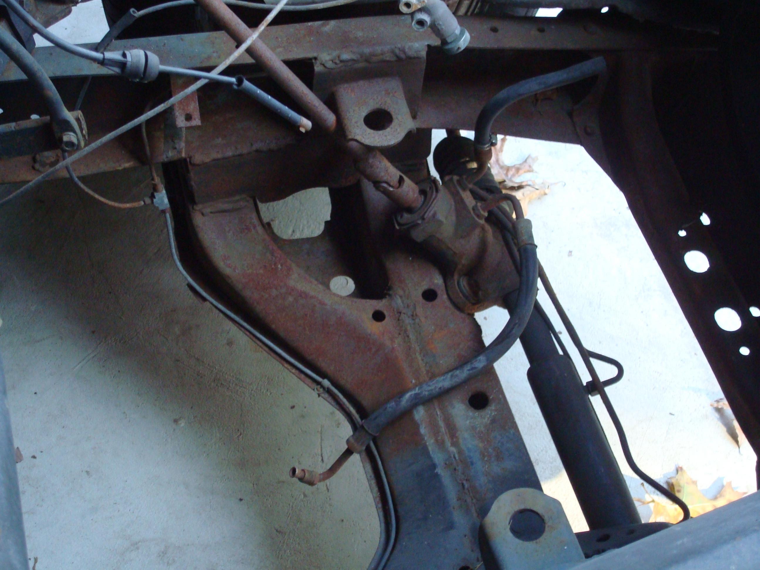

    I was told I had a mustang 2 front end under my truck, but today I was told it is not. Can somebody tell me what front end I have.

    hey hey, i dont know,,,looks like they installed real nice though....mac

    its either a pinto or a bobcat(mopar).

    I'd guess pacer. They used R&P and normal A arms like that.
  5. get the number off the rack and pinion.

    Ill second mopar. Volare clips are real popular on effies.

    uh....volares do not use rack and pinion. They have a good old fashioned steering gearbox and linkage. And torsion bars, no coil springs. Ever looked at a "modern" mopar?

    What bolt pattern is it?

    Heo
    Volare have torosionbars so noo not a Volare

    Volare's are torsion bar suspension, Bobcats are kinda like pintos or Mustang 2's

    but what does an AMC Pacer front suspension look like? Do a search...

    After a brief search it looks like it is probably leaning toward being a pacer front end. I am building a 53 chevy truck, is it worth my time to keep this or should I look for a mustang II clip.

    I'd check on " normal wear parts " availability, and if they have parts I'd use it. you have discs already and if it was cleaned and painted wouldn't be much different than Mustang II. JMO

    If you can get parts to replace all of the wear components I would stick to the Pacer unit, The Pacer was a big heavy car, not so for the 2800 pound mustang 2. These look like stock components, the only thing that looks remotely mustang to me is the lower arm, if they are Ford they will have a Ford oval stamp on them somewhere, most likely the top of the lower just behind the ball joint connection. The ball joints may also have an oval. Another tell tale stock Ford trademark is the absolute lack of any type of grease fittings on anything.

    Looks like Pacer. They work fine, and parts are available, but they tend to develop leaks in the rack. They also use lower pressure pumps than the Fords. I would suggest putting an 82-88 T-Bird rack .Then you have the best of both worlds. Pacers also have 11" brakes, besides being heavier. You also also can put 2600 lb. bags on a Pacer that won't fit on a Mustang II.

    One other thing, a Pacer front will not sit as low as a Mustang II. I have one under a 55 First Design panel.

    IF it is a Pacer the spindle will be two piece. The AMC spindles have an upright section and then the spindle snout that bolts to the upright with four horizontal bolts. Hope this helps ID it for you.

    Sure looks like a Pacer to me. Ran one under a 47 Ford pu for a couple of years. Liked it so much, was the only thing I saved from the pu. Well worth keeping, even if you have to "adjust" the P.O.s' installation. As mentioned, AMC had the two-piece spindle, allowing different drum brakes, a good-sized solid rotor, & the huge-by-large vented rotors; like you have. Last time I checked, parts avail was a non-issue. & I think, IIRC, you can get a non-power rack also. Nice sized swaybar [well, anti-roll-bar], too. Everything is H.D. componentry. You will like it...

    If the front tires barely clear the front fenders it's a Pacer. They were popular because the whole unit just bolted under the frame like the Corvair. Not a lot of welding required. They quickly faded because they were so wide. You had to run rims with all the offset to the inside to clear the fenders. A friend had one under a 40 coupe and finally replaced it with a MII.
