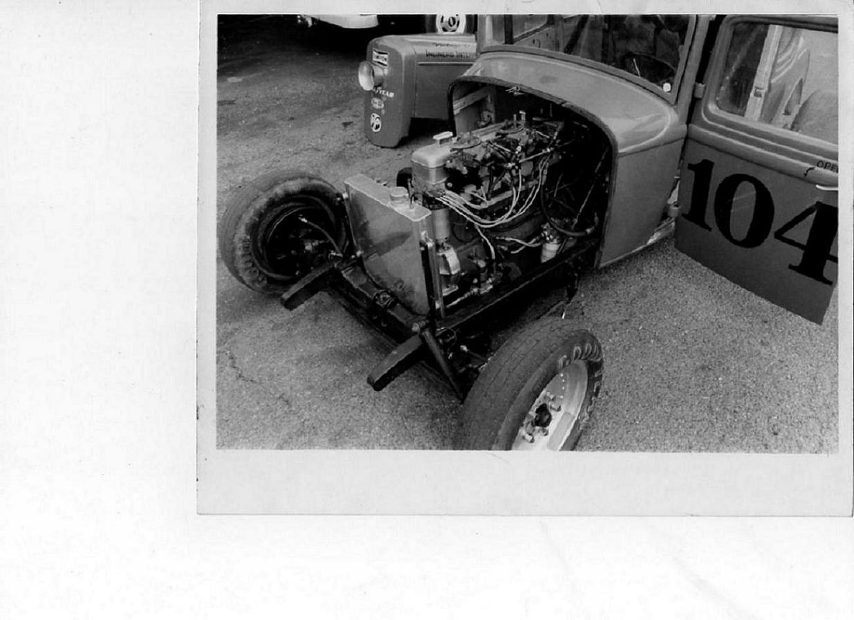

    I have run 270 GMC motors in my car and I like them. The engine number is next to the distributor. 270768053 I believe you said. They were run is some pretty big trucks and are well built. If there are no cracks in the exhaust ports, go for it. I still hold an El Mirage record set with a 270. The 302 engines have a closed chamber head and large ports. The late 270H has the large ports but I guess still the open chamber. I always used 302 heads or 12 port aftermarket heads. If you go with the 302 head you need flat top pistons. 270 pistons have a big popup.

    I think it's 2 inches longer than a Chevy.But the bellhousing is the same. You need to reverse the radiator as above. I think you can buy new Fenton headers for it. I made my intake. You should check out Inliners International. They have a news letter with ads both commercial and private. My 270 in '78 in color and in '84 B&W

  16. RichFox
    Joined: Dec 3, 2006
    Posts: 10,020
    RichFox
    If you scroll up to post #9 you can see a Howard 12 port head, which is a Wayne 12 port with the intake ports raised to 45 degrees to give a better angle towards the valve.

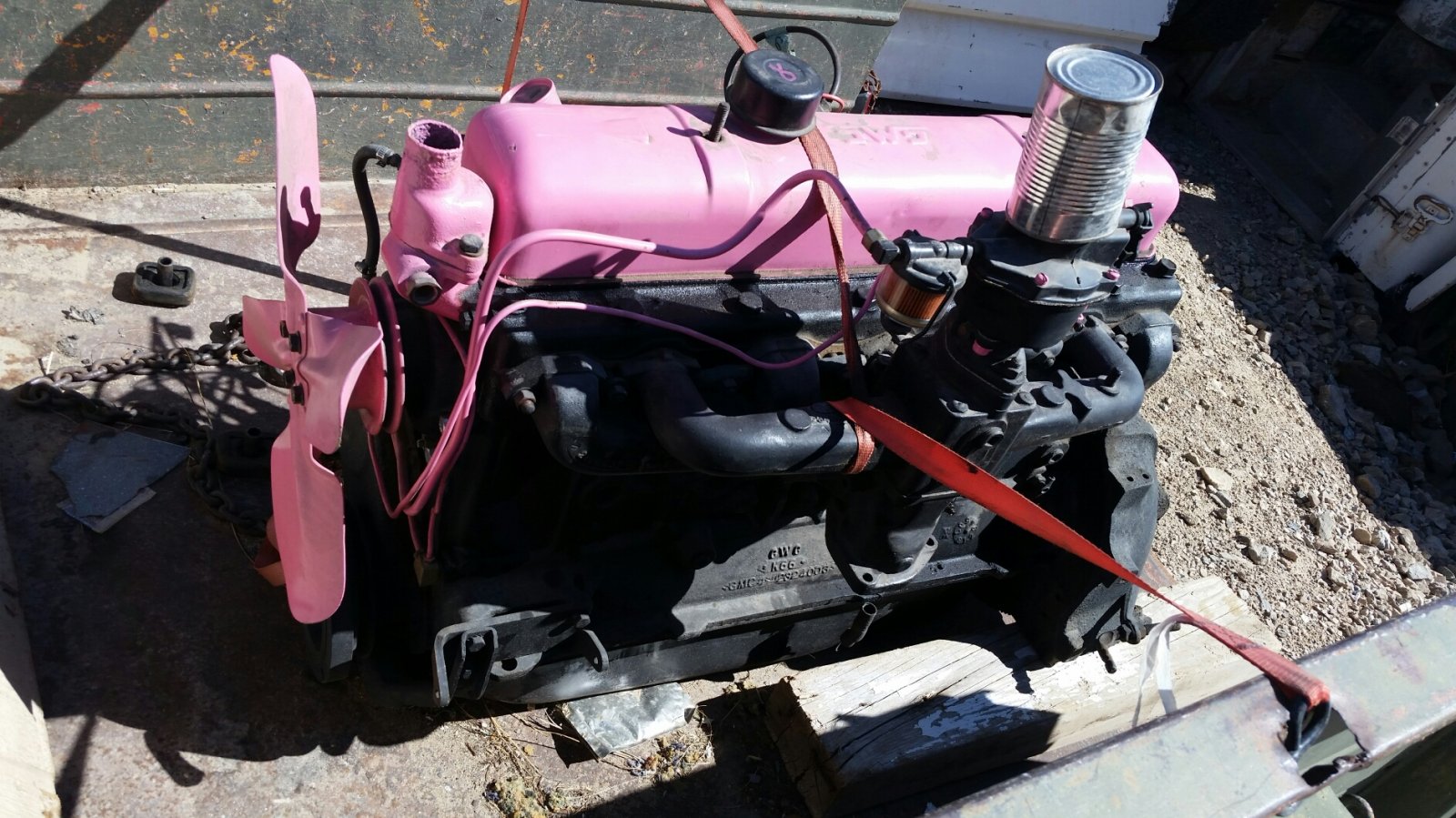

  20. Theres a chrome valve cover in IE CL for a 248/270/302 and an Ellis Intake manifold on ebay right now..
    I just picked this up last week:
    I dont know why!
    I just like them.
    I have 2 of them,one with the H head.

  22. I know!
    I asked the seller what was the deal with that,he said it was a project for a cancer survivor.
