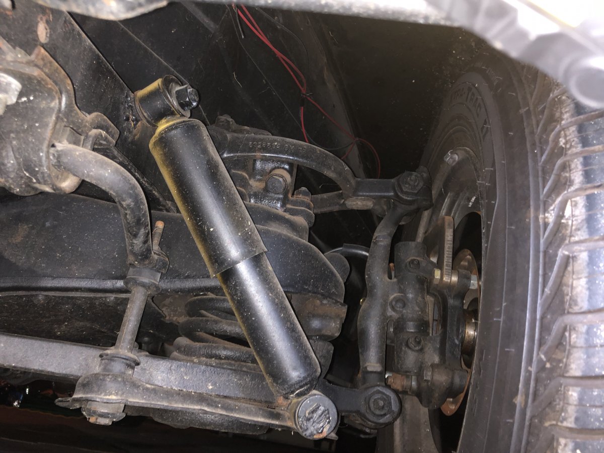

    I just bought a 40 Chevy that has an ifs subframe bolted under it. It’s not one I recognize and not sure these pics will be much help. Any one got any idea what this might be? A534FD7B-0335-4400-88E5-18B6AB334A96.jpeg B6F97B37-B9FA-44B1-A75C-D4DC5EFDD44D.jpeg

    GM IFS #5328534 Looks to be OEM with upper and lower rebound rubbers matching original schematics? GM casting on upper control arm

    Looks like your standard knee action to me.

    I think they are right. Is that a crack on the upper arm?

    Better change that upper shock mount, angle is way off.

    stock original suspension! with (badly) added tube shocks. how about that.

    Looks stock to me,with the exception of the shocks. HRP

    You are not that wrong....1940 Chevrolet Special and Master De Luxe got an "Independently Sprung Front Axle" .......and Master "85" got "Conventional Front Axle".....

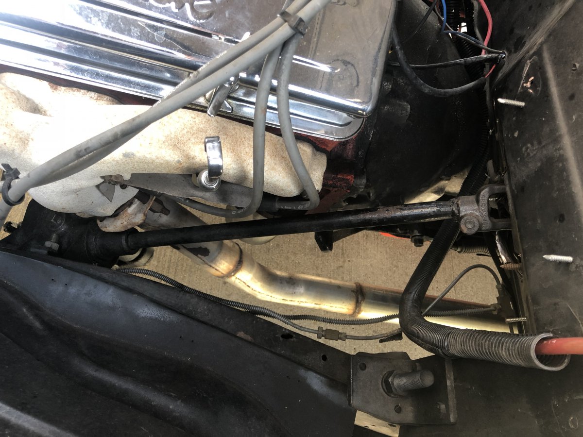

    Sounds like all they did was cut OEM column shaft and graft a new column in if using original steering box which might be OK and only require adjustment? The only thing required when that column was swapped in was a universal joint connecting it to box output shaft and a seal on tube where it was cut. The column needs to be secured properly at toeboard and lower dash rail. Post some photos of column attaching points and universal joint. It could be poor workmanship or fabrication (DD shaft) that needs rectification apart from tube shock angle. You already have disc brakes. Don't overthink it, the OEM suspension including kingpins might be OK and still safe to use.
    skin_dog1 likes this.

    3DD28740-878C-4B61-8DDE-BECE523DCC13.jpeg No u joint. That may be why the steering is so jerky. Imagine a slightly bent shaft rotating, getting right at one point then freeing up at another. Somehow I doubt that shaft is perfectly straight from the steering whee to the steering box.
  29. X38
    Joined: Feb 27, 2005
    Posts: 17,498
    X38
    If the same guy who installed the tube shock modified the steering, I'd be worried.
    Looks like part of a u-joint (welded!) at the fire wall. What is that?
