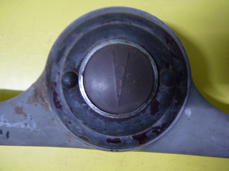

Hi there! i´m Diego, from Hurlingham (ARGENTINA), can anyone help me to identify this steering wheel? Thanks in advance!!!! Diego B
My guess is that someone discovered that the early Ford horn button was the same diameter as the unknown wheel that looks more 50ish than the 38/39ish horn button that once had a long rod on it that went down through the steering column to the head light switch on the bottom of the steering box. The 2 knobs on the horn button is so that you can turn on the H/Ls and parking lights. I'm pretty sure they never came as a matched set from a factory. The horn button is 38/39ish Ford but the wheel is not. notice the paint color is different.
I think Tommy nailed it .... I had the same feeling after i buy that steering wheel Anyway, thanks fellas!!! Diego Hurlingham - ARGENTINA
