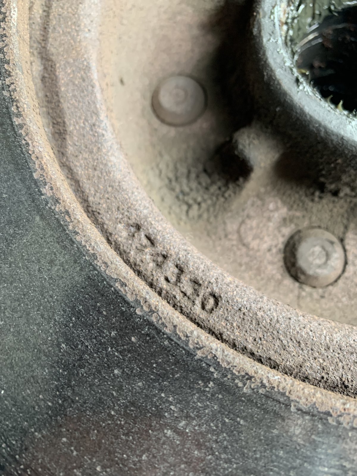

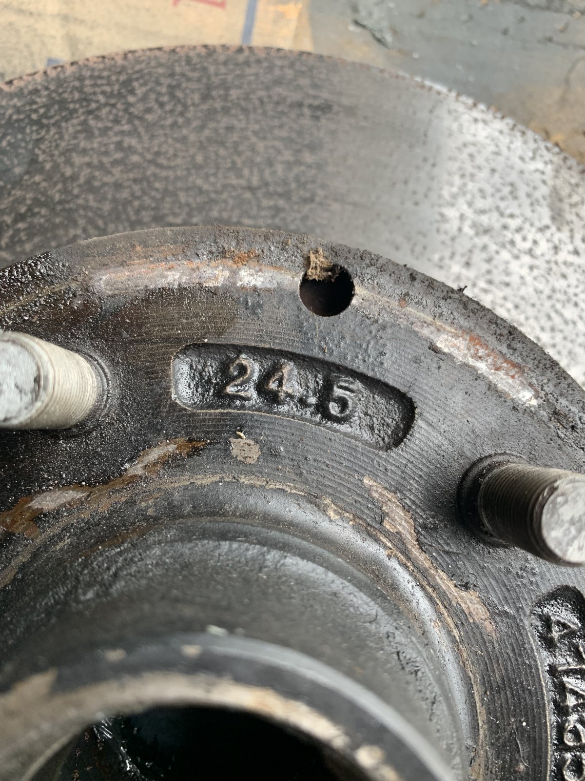

    Doing the front brakes on my 1940 Chevy truck, was told that the front brakes were from a chevelle. I ordered a set of rotors and pads for a 1970 Chevelle, the pads are spot on, but the rotors are different. The new ones are 11” but the old ones are 12” and the studs on the new rotors are smaller diameter than on the original. So I went and got a set of rotors for a 1972 Impala since they were 12” but they’re not right either, they take a way bigger bearing than the original.
    Based on the numbers that are stamped on them, can anyone look at these pics and confirm what they might be so I can order the right ones?

    I cleaned up the original and took some better photos, hopefully someone can look at this and know exactly what it’s from. The guessing game ****s and return shipping on a pair of rotors isn’t cheap. IMG_4577.jpeg IMG_4578.jpeg IMG_4579.jpeg IMG_4580.jpeg IMG_4581.jpeg IMG_4582.jpeg IMG_4583.jpeg IMG_4584.jpeg IMG_4585.jpeg IMG_4586.jpeg IMG_4587.jpeg

    It's funny, if you google 474350 it comes up a rear rotor.
    Johnny Gee likes this.
  24. 63401nailhead
    Joined: Apr 4, 2008
    Posts: 308
    63401nailhead
    When I googled it it said it was for a Mazda
