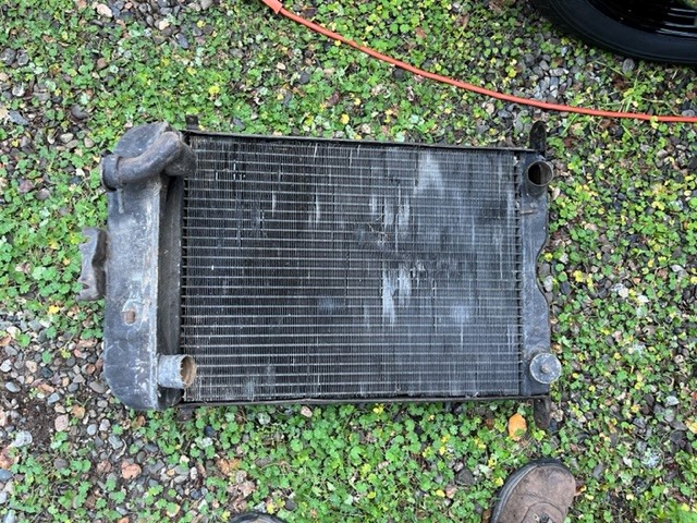

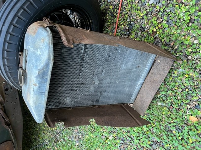

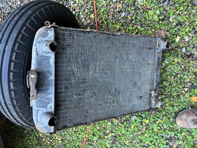

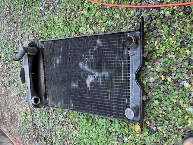

    I think we've got a 33/4 , and two 35/36. But want to know before i list them, thx in advance
  2. Should be some numbers stamped on the top tank probably near the left hose attachment. 40- prefix would be a '33-'34 radiator. The '33-'34 radiator must be from a 4 cylinder car since it has single outlets top and bottom.
