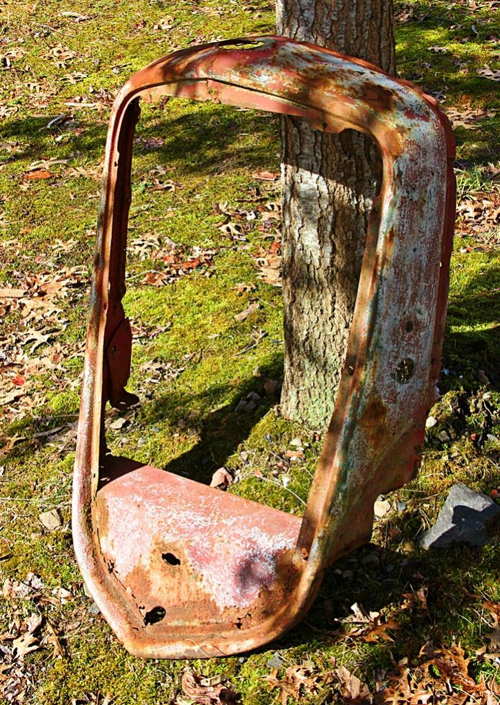

    Can anyone identify this shell..Early 30's......Chevy..Car?..Truck?
    Thanks all..

    Looks mid 30s chev
  3. Could be off a 30's International?

    Looks like a 33-34 Chevy to me.

    It"s a 34-35 Chev std or 34 master. The master is bigger than the standard.
  9. My pick is Chev 33-34 car and up to 36 truck. JW

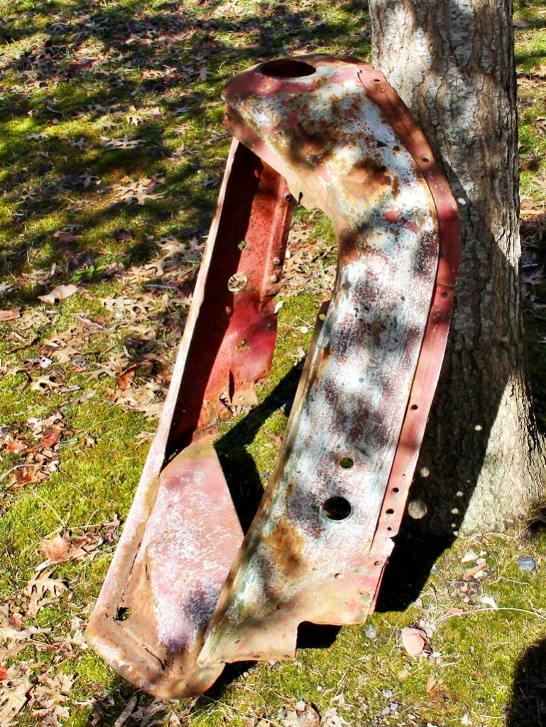

    Looks like a '34 Master. Master is narrower and longer than the '34 '35 standard. The '33 does not have a removable trim ring.

    Not a 35 master. Fill on 35 master is behind shell. No hole in top of shell.

    Just measured my '34 Master. The grill insert area should measure 31 1/2 inches top to bottom. Standard is shorter.

    Looks like my 34 Standard. I'll measure insert depth tomorrow as you already have Master dimensions
