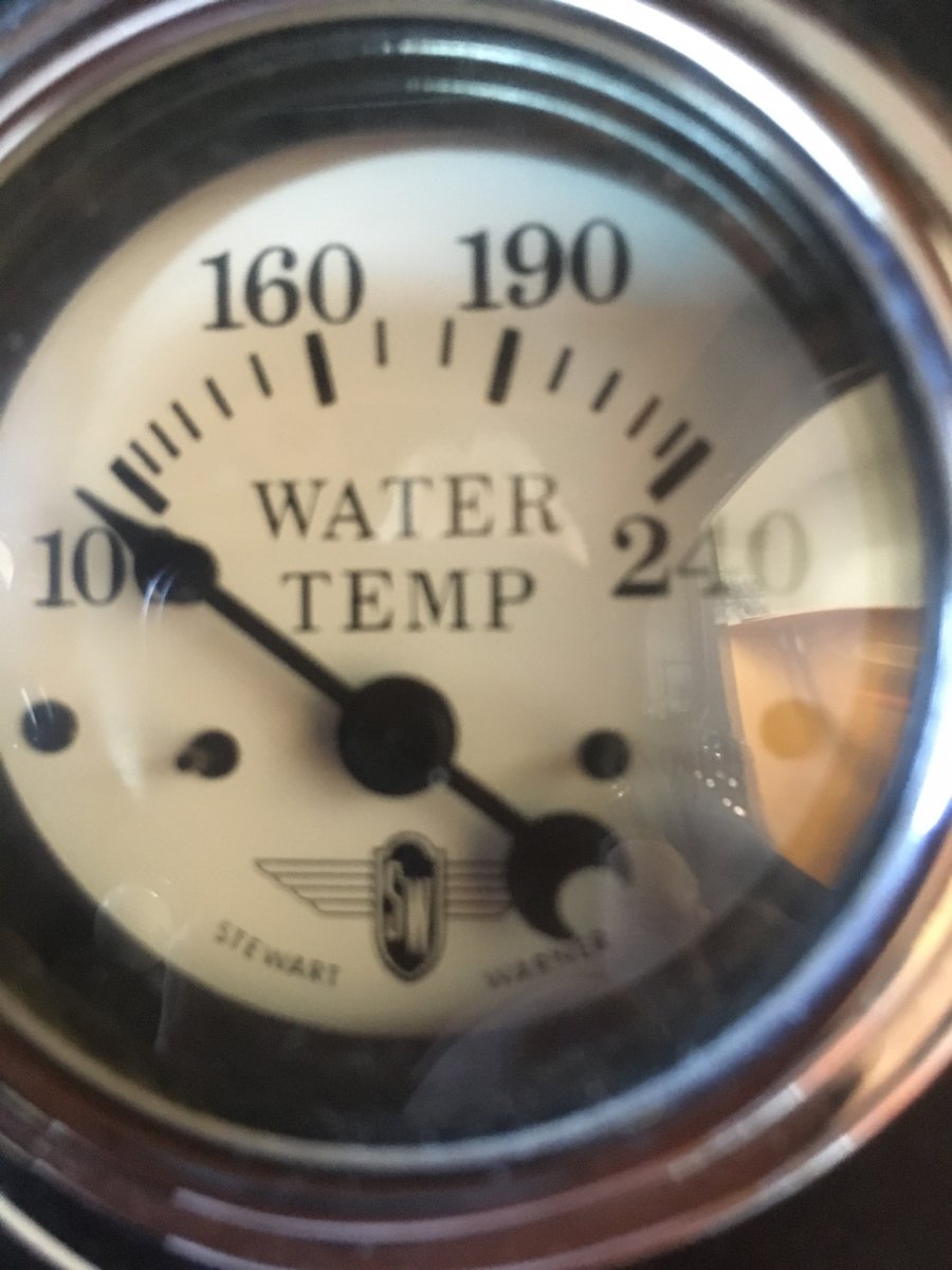

    Through the process of elimination, I’ve identified the cause of my temperature gauge’s non participation. A faulty sending unit.
    In normal times I would remove it and bring it to my local parts house and say, “gimme one of these”. But, these are not “normal “ times. Because we are pretty much locked down here in Connecticut, I’ll order one online. Here’s where I need help from the brain trust.
    Can someone give me the information I need to order the correct replacement? It’s on a 292 Y block.
    Thanks!
    Jeff

    PS is an oil pressure sender, not a temp sender...
    Anyways...what gauges are in the car? (and...what car is it?) The sender needs to match them, it doesn't really care what kind of engine it is.

    D9C4F32A-8F04-4632-9E49-91DD371B76D4.jpeg Thanks for the replies.
    It’s a Stewart Warner.

    My eyes must have been crossed and read incorrectly. Stewart warner part #280EA
    Standard #TS4
