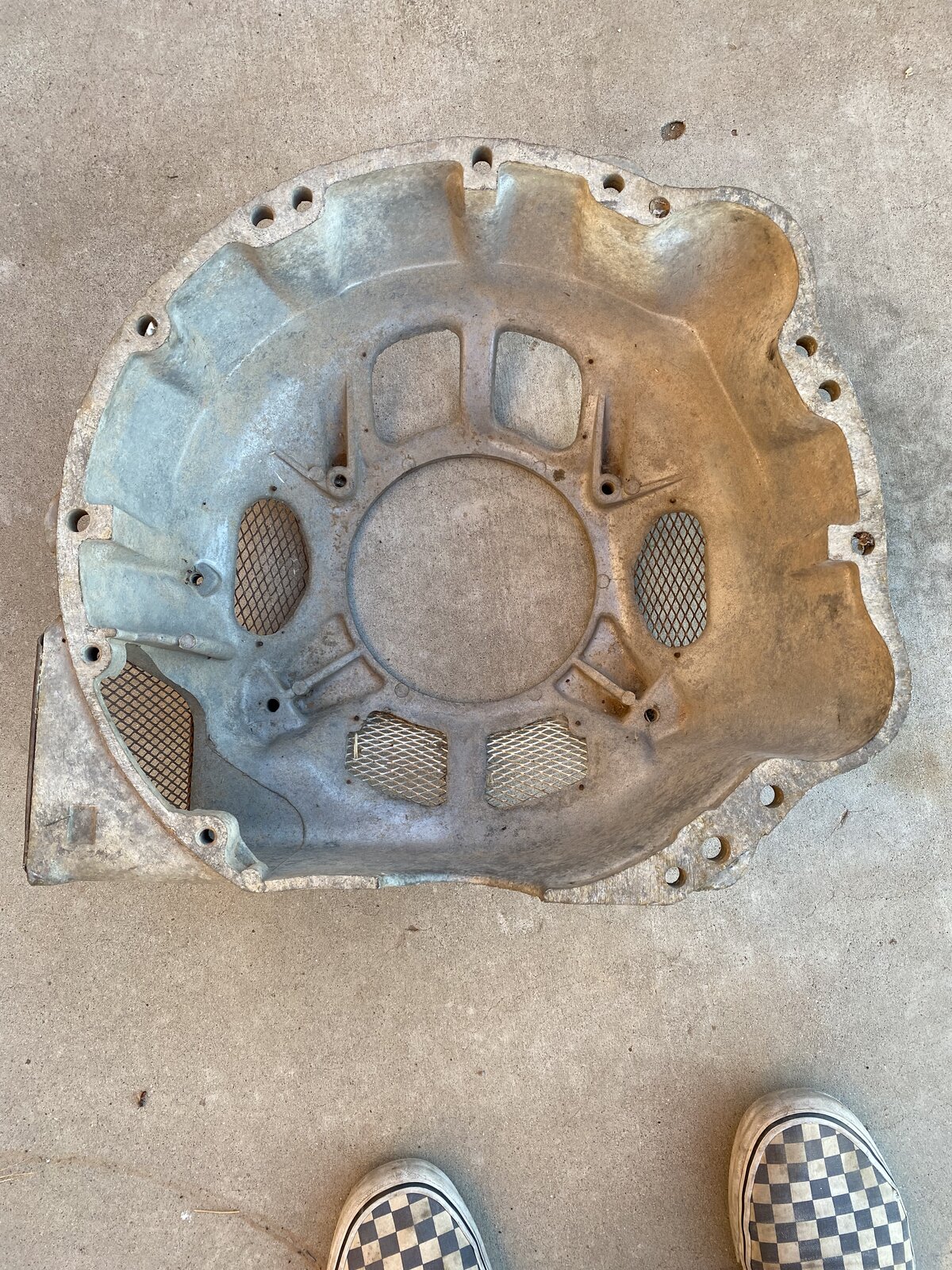

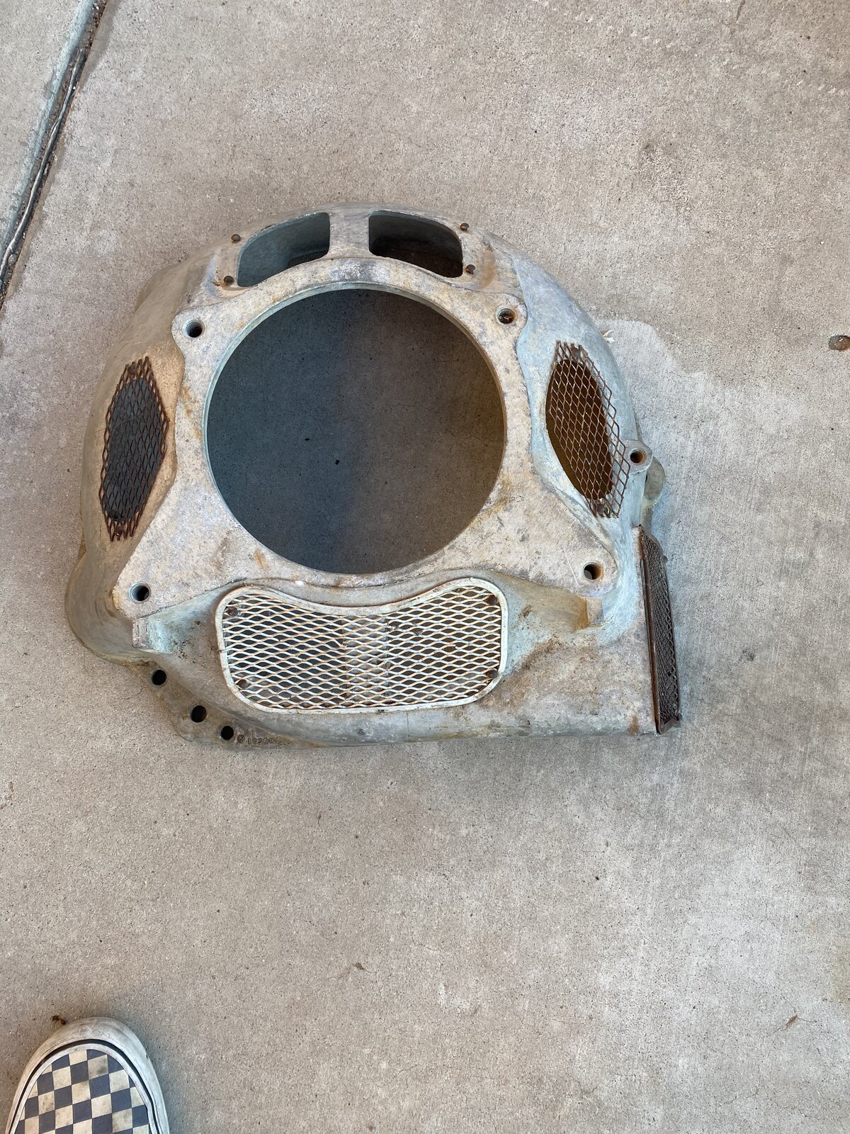

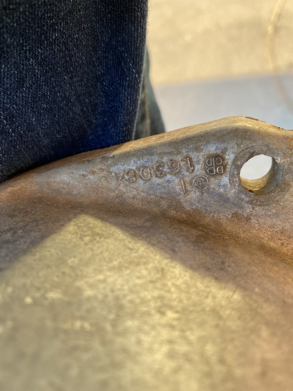

    Need help identifying bell housing? It came in the trunk of a 56 crown Vic that I bought 9 or 10 years ago. Has what looks like a Ford C4 bell housing pattern but the clutch fork is on the wrong side. Also has 2 spots for a starter. I’ve included the only casting marks on the bell housing that I can’t seem to find **** on.

    C4 with a clutch fork?

    Looks like air cooled early 50's Ford/Merc or maybe Lincoln.

    The clutch does is in the wrong side though

    Looks like a bell housing off of an air cooled automatic like the one behind 1955 dodge 255 hemi I have

    ^^^^^^^Yep, I believe Mopar automatic ……. for a 6 cylinder application…..note starter position.

    It actually has two starter locations. If I remember I will take a picture of the one I have tomorrow

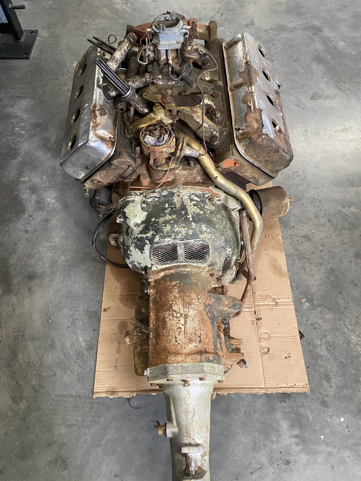

    The Mopar automatic transmission applications of this era used an intermediate plate between the block and the bell housing. Typically, that plate was aluminum, but I think I have one that is iron, though the trans is aluminum.That one is from a ‘60s A-100 pickup.
    The intermediate plate differs from V8 to six cylinder models because of starter location required and also the block bolt pattern variations between six and V8. Although I said in my prior post this is a ‘six cylinder app”, it was an incomplete answer. @unforgiven correctly pointed out the case shown can accept either of two starter locations.

    AAC9DE3E-6B72-4AA6-9616-357A4BC24C03.jpeg Here is the picture you can see the plate between the transmission and engine and both starter locations 197789C3-DCBE-403B-98A1-BF98F6588C8C.jpeg
